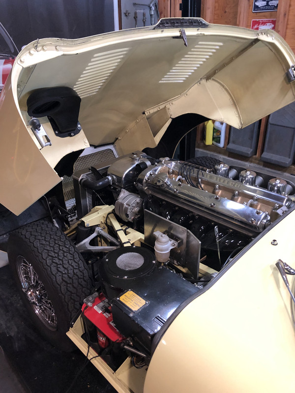

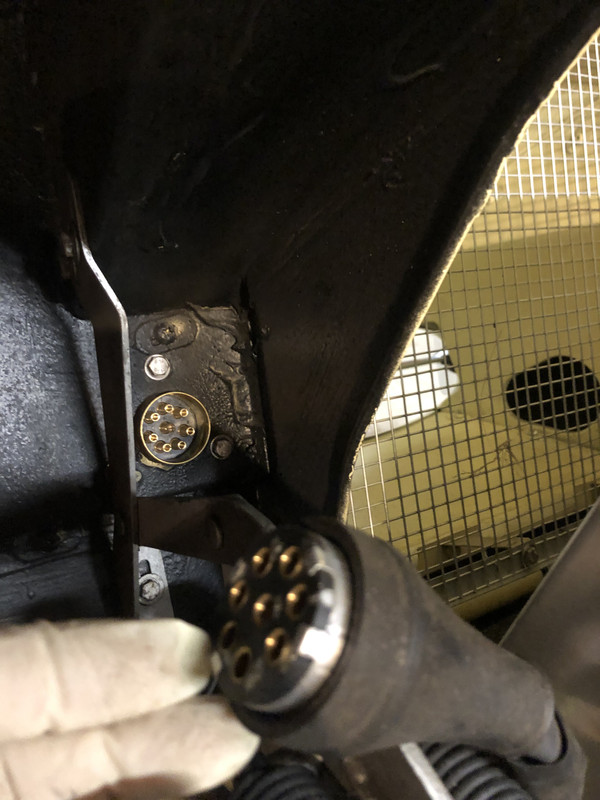

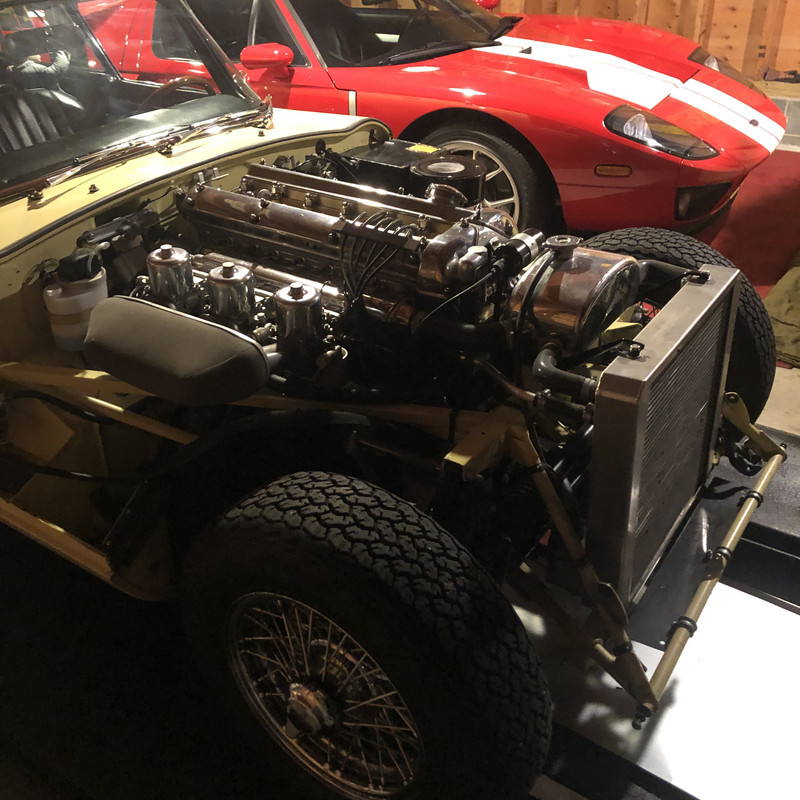

Post by gtjoey » Tue Jul 19, 2022 10:48 pm
Let’s do it!!!!!
For now on all my posts will be the next morning so my friends in Europe are on the same day!
If there is one person on this planet that didn’t know
I rebuilt the entire car within 24 months
Except for paint so we should not have to worry about a host of other things and just stick to the 5 speed swap!

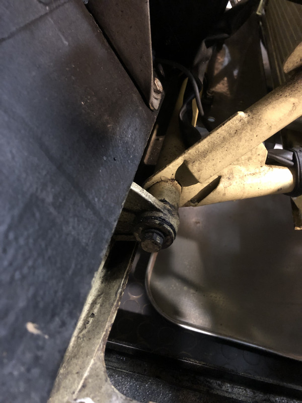

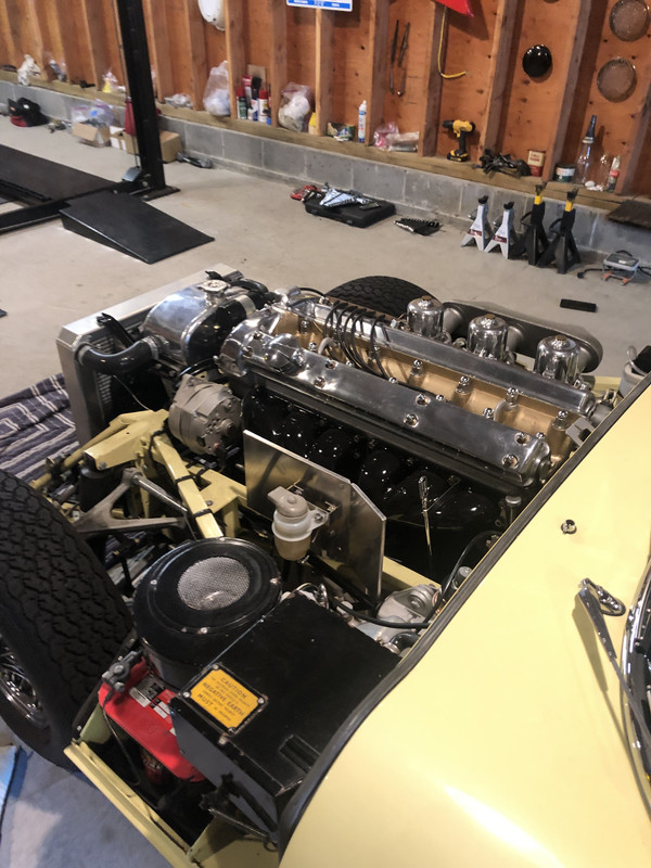

I needed two young guys to lift as all you need to do is take out the
2 Spring hinge bolts
2 lower pivot bolts
Head light harness and
Shimmy out the bonnet bushings!
Tomorrow we remove the 1 wire alternator and brackets.
Remember we are dropping the engine from below!
Fun. Fun. Fun!
Gtjoey1314
Hope I’m going slow enough 😀

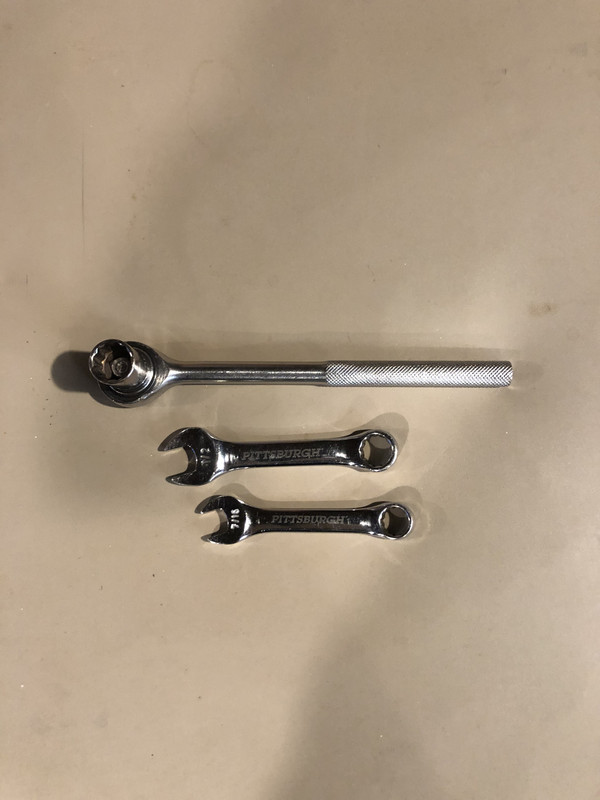

All we needed today is a 7/16. 1/2 and 9/16 wrenches and socket

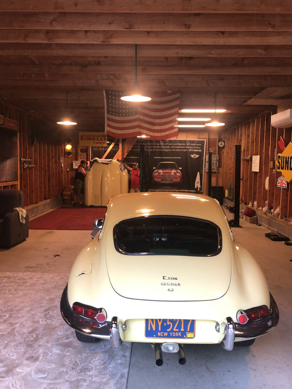

Post by gtjoey » Tue Jul 19, 2022 10:59 pm
Perspective of job ahead with inspiration around us🤣
Eclectic group of cars?

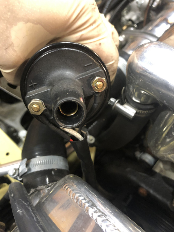

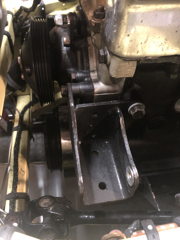

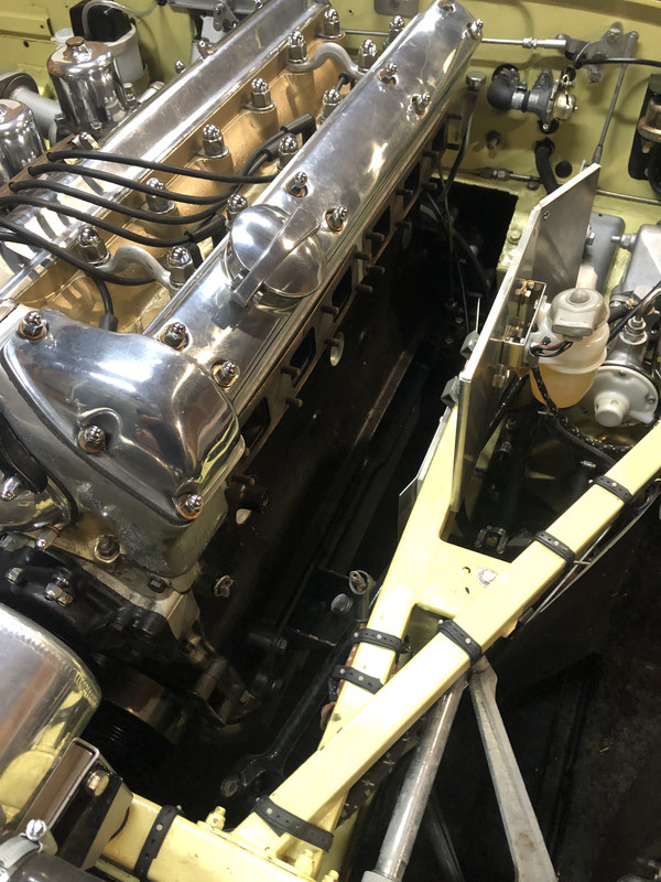

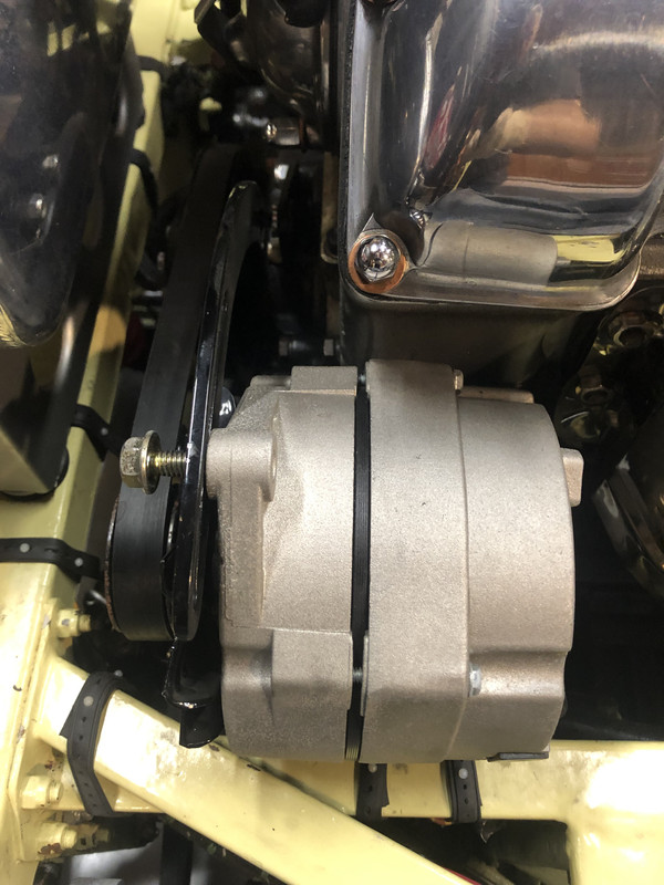

Step 2
Removing the alternator and bracket
Along with the Single Rob Beeres serpentine set up
Eliminating the jockey pulley
What a dream, every 100,000 miles just replace the belt😁
The coil is pulled back with the 2 screws removed.
Everything was 1/2 , 9/16 except the 5/8 bolt for the Alt bracket.
Tomorrow the exhaust
Enjoy
Gtjoey1314

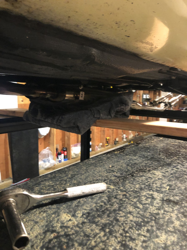

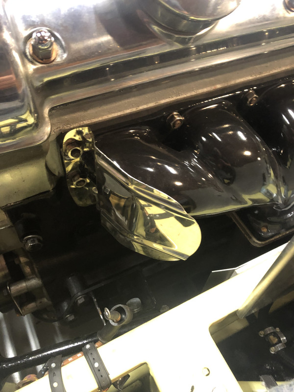

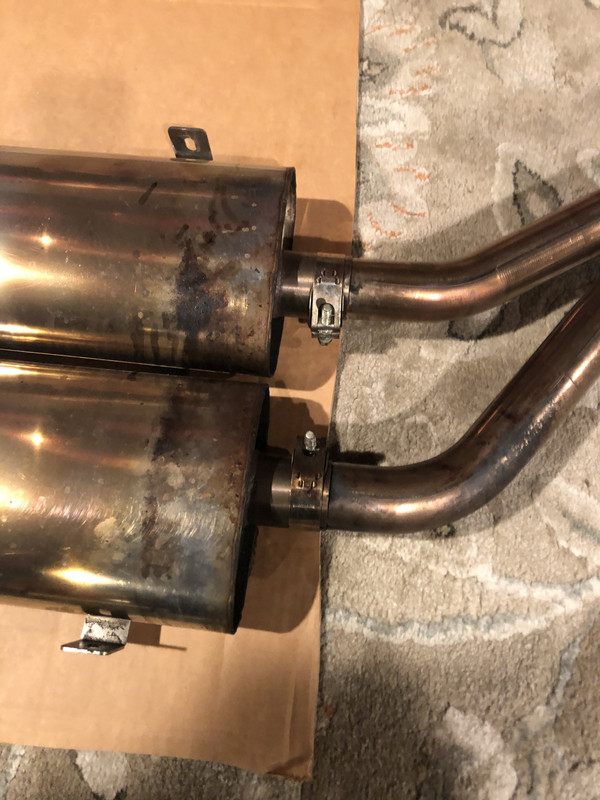

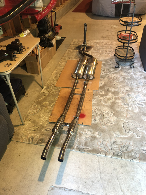

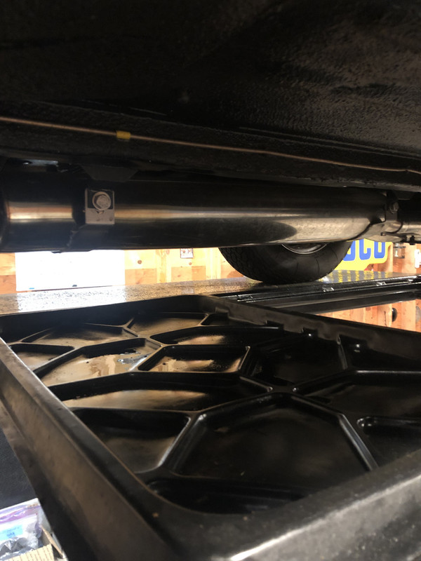

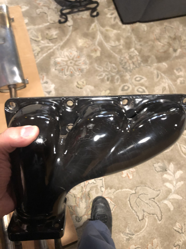

Step 3
Removed the entire exhaust in one complete piece.
Take out the 8 nuts and washers from down pipes.
Then loosen and remove Exhaust manifolds with down pipes still in place.
Now take out the 4 muffler bracket bolts with support under mufflers.
Take out center bolt on resonator bracket.
Remove support under muffler and drop exhaust and slide out back!
Note the SNG manifolds for the money are excellent!
I put a Hard 9,000 miles in heat, cold and yes snow!
They are starting to blemish but the fit and finish are just great.
Note series 2 heat shield, it looks almost period and does deflect heat
The drivers side is now stripped except for the motor mount
I’m trying something new on the carb side.
Stay tuned!👍🏾
Gtjoey1314

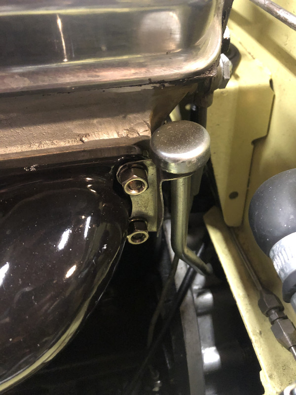

Post by gtjoey » Thu Jul 21, 2022 1:01 am
With the new box if all goes to plan
The breather pipe will be deleted and the mufflers once washed up and reinstalled shouldn’t be covered in transmission fluid from the original box!
