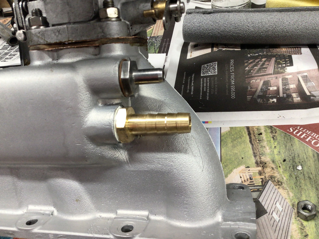

Might be delicate electrolytic pairing, the brass and the aluminium, although the manifold temperature sensor and the thermostat seem to survive ......... and as the steel original tends to weld itself to the aluminium anyway, the brass might be no worse a choice
#22 Re: Hose from inlet manifold to bulkhead

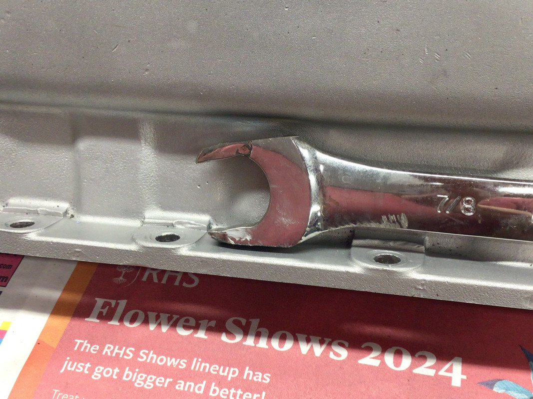

And here it is fitted
You have to sacrifice a 7/8 spanner by heavily grinding the edges due to the design of the manifold

Or just use a deep well 12 pt socket...
