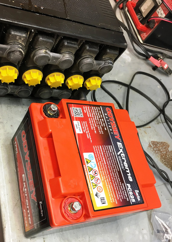

Anyone who is concerned about how much grunt their "hidden" battery can deliver, and who might be looking for one like the Spark I used, read on.
The Spark turns out to have been identical to this Odyssey PC925 one, which I see is easily available in the UK for around £150 inc VAT,
https://www.tayna.co.uk/industrial-batt ... sey/pc925/
still double the price of the one referred to earlier in this string, but it produces 900A for starting purposes (this is an SAE J537 5-second measurement, I read) and has a capacity of 28Ah which has always proved sufficient for me during the seven years the last one lasted.
The manufacturer claims that these batteries hold their full charge for 2 years unattended, at 25°C, and for even longer at lower temperatures ; TPPL technology stands for Thin-Plate-Pure-Lead and is still fundamentally an AGM or Absorbed Glass Mat type, but with a higher-packing density - it does seem preposterously heavy, for its size, when you lift it, at 11.8 kg. The very high discharge currents available seem to be due to the proportionately larger surface of lead for a given volume of battery.
I wasn't particularly assiduous in the trickle-charge maintenance during much of those seven years, so I am sure it would have lasted longer if I had paid more attention to it ; it was being charged by the original dynamo through an RB340 control-box, too, when in use, and I'm hoping that a better-regulated alternator output will be kinder on that front too.
I was briefly tempted to look into Lithium, but I have the inside ear of a major player in battery distribution and retail over here, and their advice was clear.
Important to note that there is a mistake in the Odyssey technical specs for the PC925 at least, both in the printed and in the on-line dimensions quoted by retailers, as the height is not the 148mm as marked, which is too "fat" to fit inside a standard Jaguar-style battery case, but in fact only 124mm, which makes a big difference for applications like ours.
So read 169 mm x 179 mm x 124 mm.

My Antique Auto battery finally gave up so I decided to dissect it to see if it could be rebuilt. Guess what I found inside?
Yep, the Odyssey PC925 as suggested by Rory.
Unfortunately the Odyssey is glued onto the base with bitumen an inch deep so my plans to install a new PC925 are on hold. Whilst I ponder a solution (no pun intended) to removing the bitumen I am going to go with a simpler option:

Out of curiosity, David, did you find out how to unglue the Odissey from that bitumen? I’ve got the same battery, under its disguise, and sooner or later I will need to replace the Odissey with a new oneHeuer wrote: ↑Sun Oct 04, 2020 4:26 pmMy Antique Auto battery finally gave up so I decided to dissect it to see if it could be rebuilt. Guess what I found inside?

No. I tried a blow torch but it just produced a lot of smoke and flame. Best way forward is to install the Odessey PC925 and clamp down the top half of the Antique Battery Co case own on top of it.
