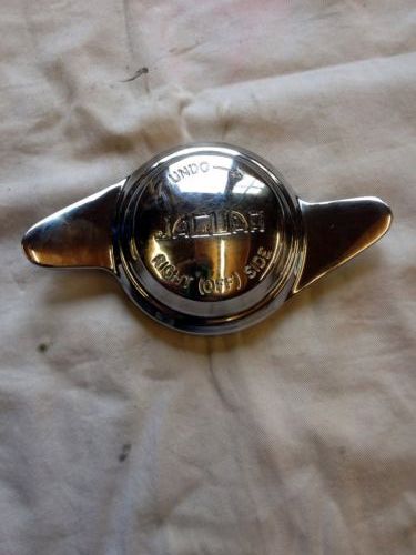

As far as I know MWS no longer make spinners. They used to and they were more accurately engraved than the Orson ones. The spinners on their web site are Orson. Suggest you grab those eBay rechromed spinners off eBay for £190 and get your money back from Orson. At least with original spinners you will be better placed to argue, sorry, discuss with MWS.
#47 Re: Loose wheel???
Hi David...do Orson spinners have a makers mark....thanks....Steve
#48 Re: Loose wheel???
No and they are not made of manganese bronze. IIRC they are brass.

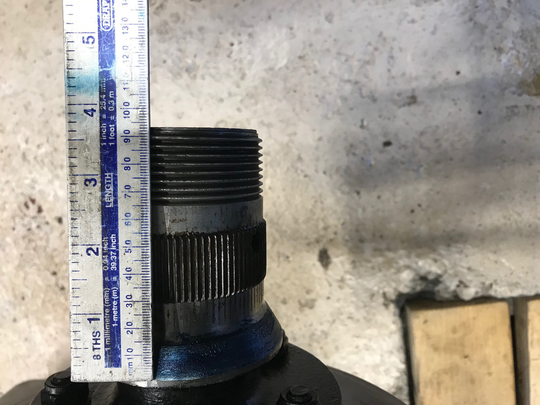

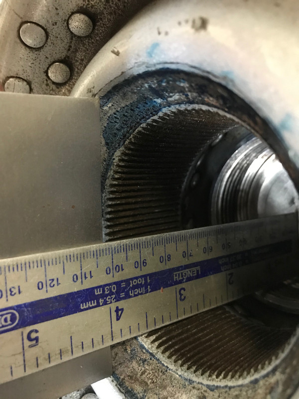

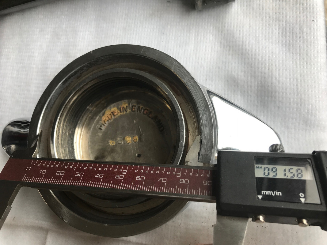

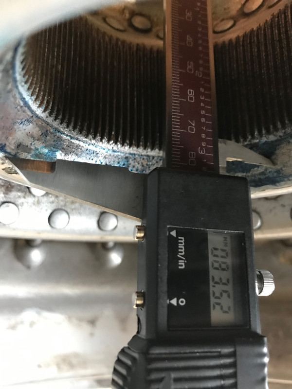

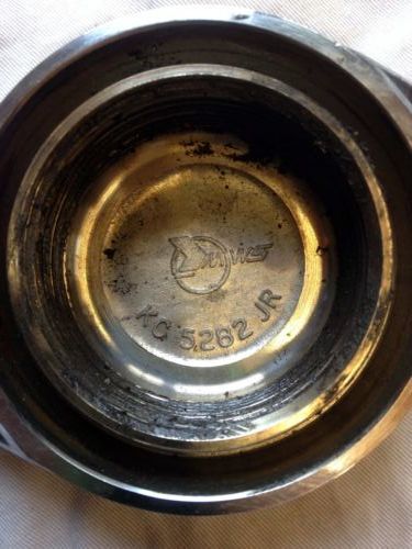

As my car is currently in part dismantled limbo--engine out , here are some measurements Andrew to compare with and hopefully help solve the issue.
If i were to guess , i would say the wheel hub outer cone to be in question as i would expect the cnc spinner machinng in the UK to be ok.

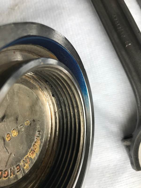

Engineers blue is your friend to finding out what is happening.
-ENGINEERS-MARKING-Bhttps://www.ebay.co.uk/itm/TUBE-OF-STUARTS-MICR ... Swa8dZ1R5q
My wheels are original ,the hubs are OE, the spinners Made in england.
The splined hub measures 93mm deep from the rear cone angle , when the wheel is fitted it protrudes out 10mm
Holding the spinner on the wheel it measures approx 102mm from the rear cone to the spinner recess
102- 93 =9 ---in theory that gives 9mm clearance before the thread bottoms out in the spinner, thus ruling out any chance of the thread bottoming out even on the shallow 27mm recess spinners. Plasticine squashed to show a 7mm gap when the spinner was tightened.
The spinner thread recess is 27mm deep.
The spinner outer recess for the cone angle is cut 16mm deep- only 10mm is used as witnessed by engineers blue on the wheel cone .Note the last 2 threads are clean , at 8 TPI thats approx the 7mm gap.
The wheel hub measurement
Inner cone larger diameter 87.5
Overall depth of the hub to inner cone
Hope this is of some help

That's ok Andrew, it did prompt me to check mine even though i've never had any problems,, i think it's in everyone's best interest to check theirs.Rightly or wrongly i have always lightly copper slipped the splines and cones.
If your wheel outer cone is too small it may be possible to bottom the thread, likewise if the spinner cone diameter is too big.
If you could load a photo of the wheel outer cone where the spinner seats it could show whats occurring
