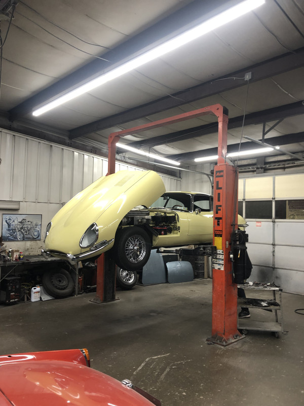

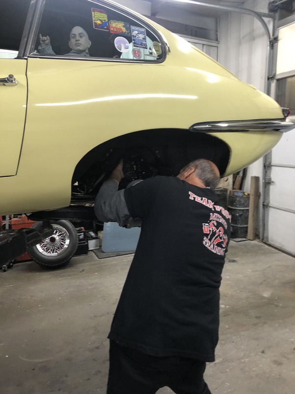

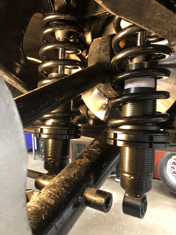

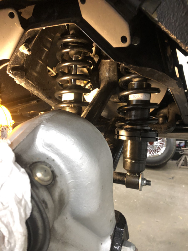

Sorry I was so late guys
We started 5 am at Bobs shop
To complete the whole 5 speed conversion, will only enhance the ride some more
It’s all done in 5 hours!
Gaz adjustable with coil overs
Front Gaz with adjustable damper settings
Bob Beeres heavy duty upgrade torsion bars NOT racing
The rears…….measure from the shock bottom stud to the top of the adjustable collar
Do all 4 even!
You want to be around 22/23/24 wheel well
Height to floor
Set all shock even on the knob till hard!
Then turn back till you like or a bounce and a half on rebound
To hard you car will push in turns with the 5 speed!
Pm your cell phones if you need help
It really complements the 5 speed!

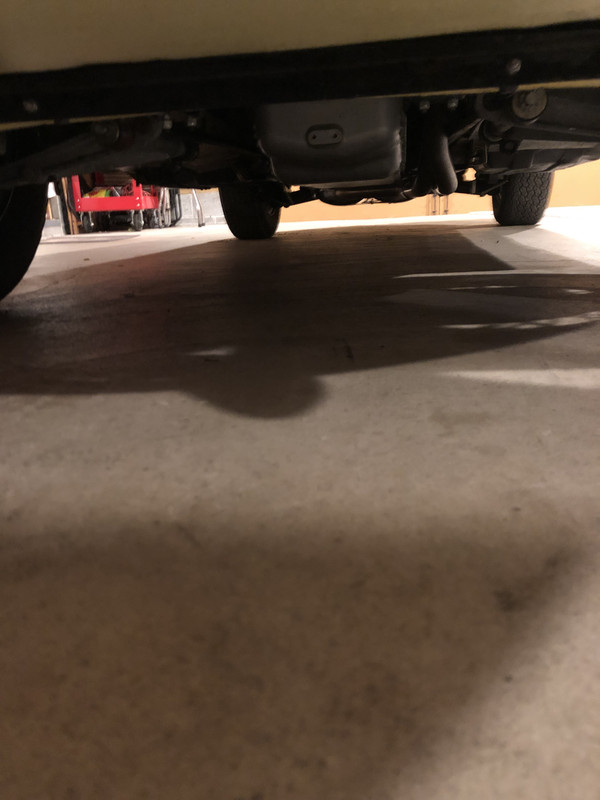

#497 Re: The 5 Speed is here……..
To follow up the
NEW. GAZ are Black not the old Electric Blue!
Much better Imho visually
Front wheel wells center lip to floor 16 1/4!
Rear wheel arch around 22ish inches to floor
It’s dropping fast in the rear as it settles in
When in 5th gear around 55/60 in hard turns there is so much torque it kicks the rear out , when the shocks are in ultra hard/ 911 Porsche mode
Back off a turn at a time YOU need rebound cushion
Again a game changer over the stock!
Gtjoey1314
Montauk 1989 use the lower stud and tape measure to to of collar edge
I think it was around 14 inches
Make all 4 even then crank up or down from there
Gtjoey1314

#499 Re: The 5 Speed is here……..
Pm me anytime
Driving all DAY today to settle everything down
World of difference
Wrapping up center console this weekend
The suspension drop had
NO effect on propshaft clearance or closeness to anything even with the almost 2 inch drop!
Tires set at 30 pounds
Final alignment next week
