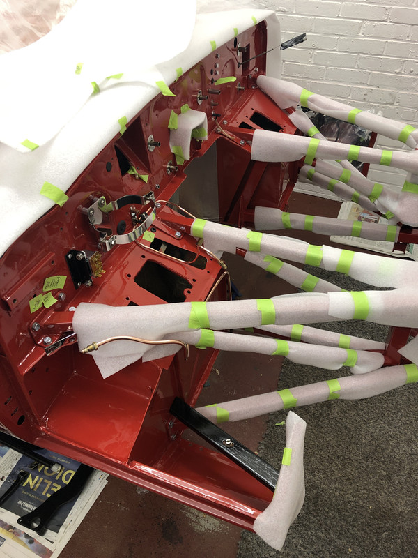

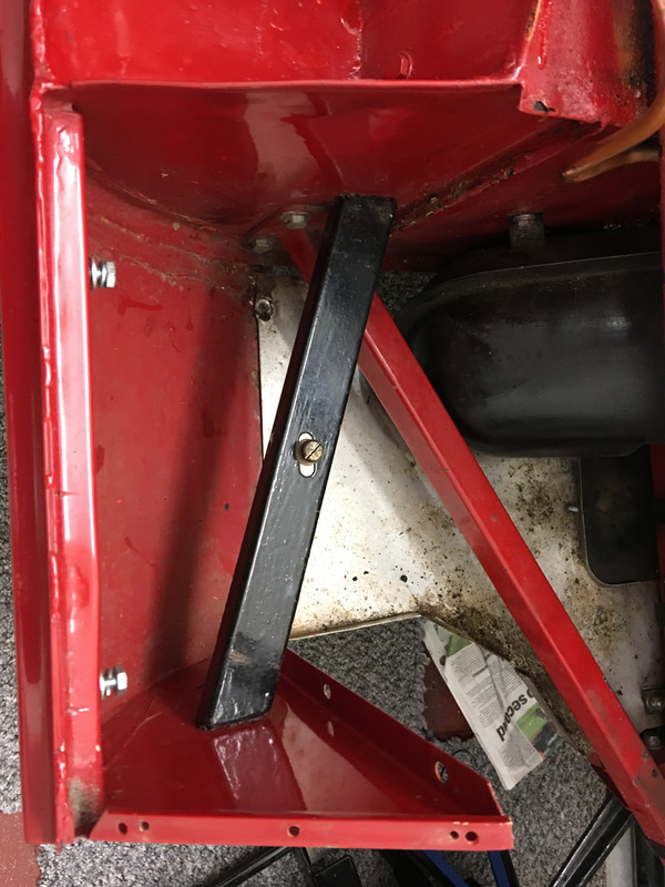

#4 Re: Air filter drum support bracket
I have some photographs for you Harvey but seem to have lost the method of posting them.
Anyone can help me with my dimness.
thanks
Ash

#5 Re: Air filter drum support bracket
Hi Ash......once you type your post at the bottom of the page you should see highlighted...add image to post...select this then select your image....Steve
#6 Re: Air filter drum support bracket
Thanks Steve - I am sure it is me but that did not appear to be there earlier.
Anyway - there now so a couple here that may help Harvey.
cheers
Ash

#7 Re: Air filter drum support bracket
Thank you very much guys for all the info, Great help.
That’s perfect, pictures are brilliant.
I can crack on now with that. Till the next thing lol
harvey
harvey
