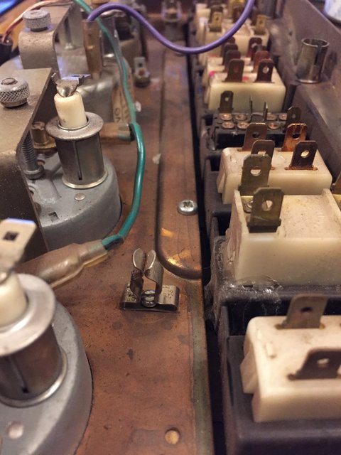

Yesterday I stripped the centre instrument panel and wiring looms out of my 69 2+2 Ser 2.
I noticed there is a small spring Terry clip screwed to the rear of the instrument panel with nothing attached to it. Does anyone have an idea what it is for? Its below the fuel and water gauges and above the rocker switches as can be seen in the photo.
Maybe it was added by a previous owner, but for what reason?
Tony

Post by abowie » Thu Feb 10, 2022 3:38 am
I've not seen anything like that before.

Post by phoenix » Thu Feb 10, 2022 5:49 am
Not original . Maybe a spare petrol key holder .

Post by Bob. » Thu Feb 10, 2022 6:55 pm
My 71 S3 has one in the same position as shown above. Nothing clipped in it.

Post by JerryL770 » Thu Feb 17, 2022 7:20 pm
Maybe for holding a single cell battery for the electric clock?

Post by UK Muppet » Fri Feb 18, 2022 10:22 am
I think the battery suggestion sounds reasonable but does this clock have a battery?

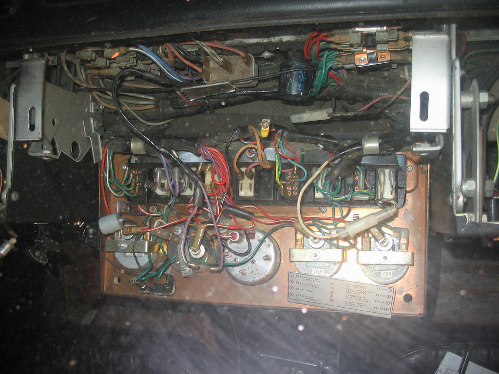

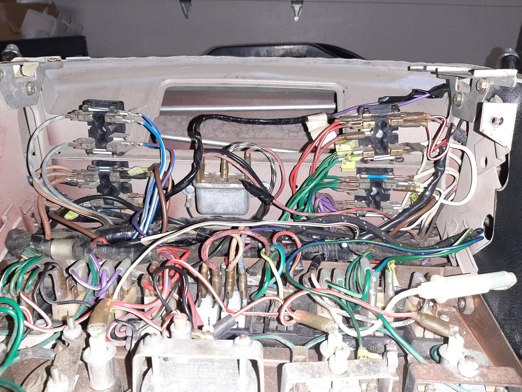

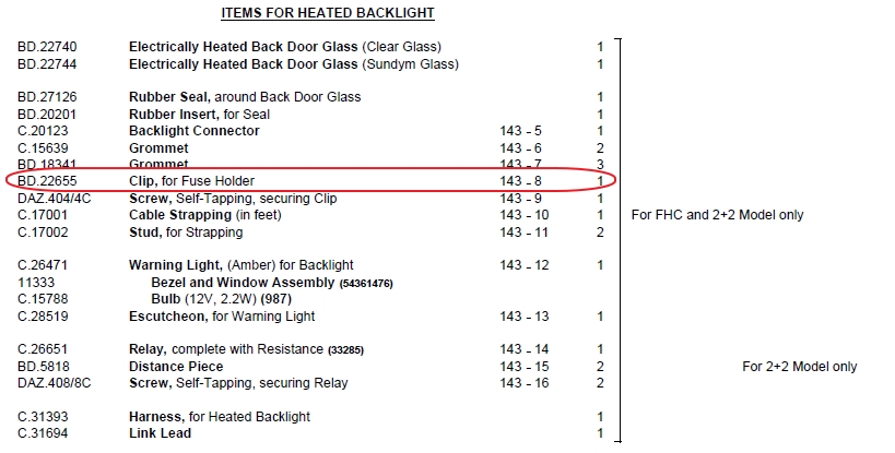

Post by mgcjag » Fri Feb 18, 2022 10:55 am
I think the clip is for the heated rear window inline fuse holder...this is a 69 2+2.....second photo a 70 2+2....Steve

Post by Heuer » Fri Feb 18, 2022 11:18 am
Well spotted Steve!:

Post by UK Muppet » Fri Feb 18, 2022 11:53 am
Brilliant, well done Steve and many thanks for solving the mystery.
