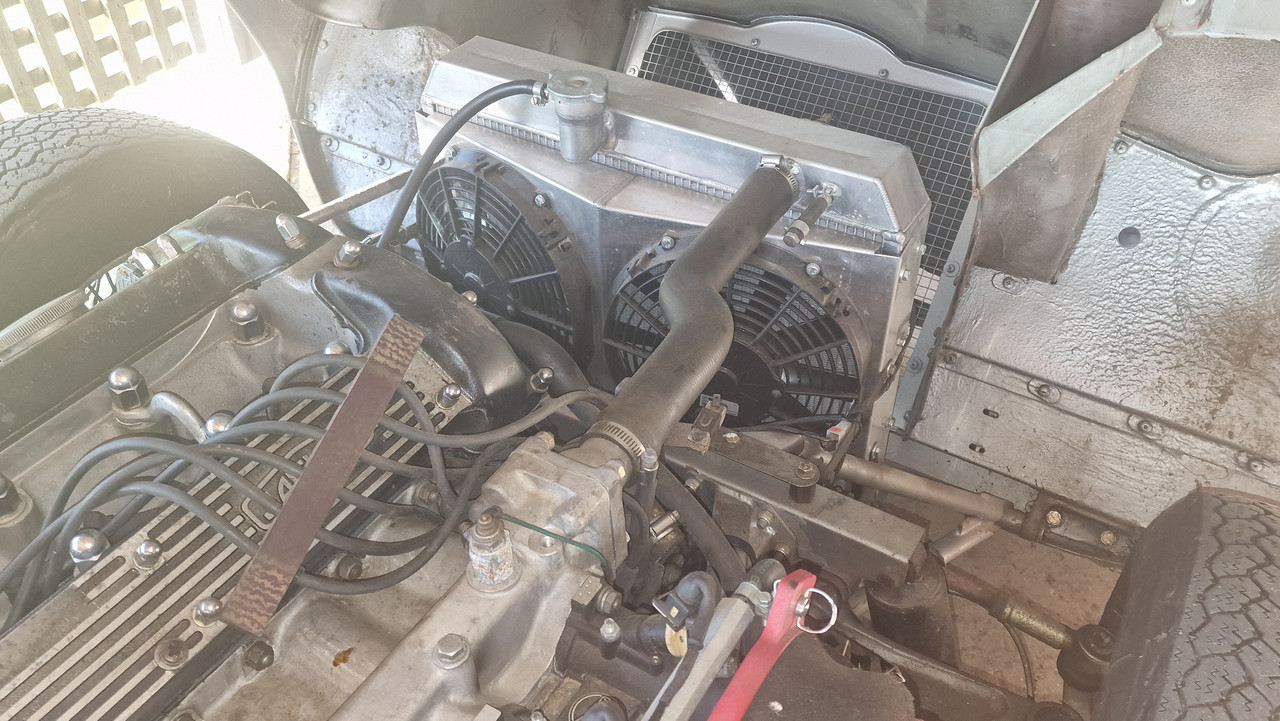

Hi guys my freshly rebuilt S2 seems to run hotter than I would like .. it sits even when cruising on the L of normal.
It’s fitted with a Radtec ally rad and fans and water wetter so was hoping for a cooler cat.!
Tried 2 gauges and sensors so wondering if maybe an air lock in the system.. any ideas how to bleed that out?
Fans kick in at 90degrees, sounds a bit late to me I would have thought 85 might b better ?

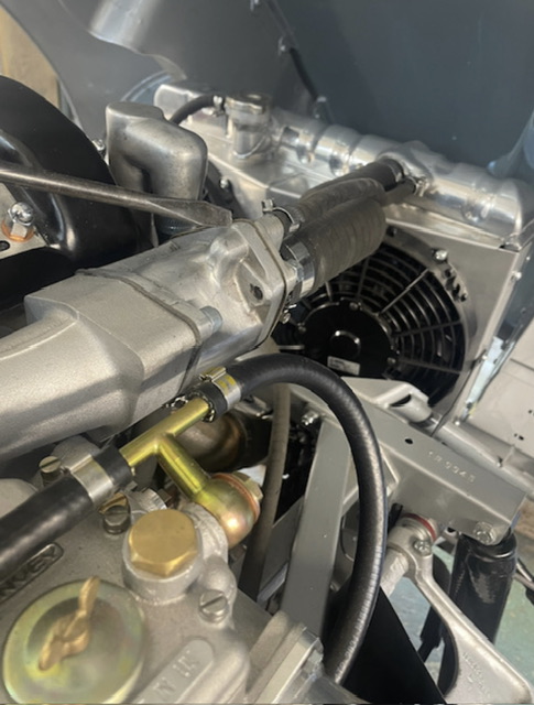

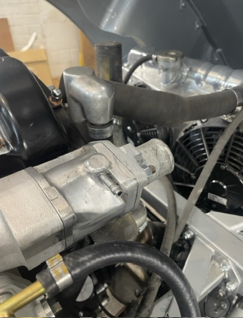

Yes I kept the original thermostat housing in a Jenvey manifold … I know what your thinking, that dont fit, well yes you’d be right but u didn’t realise that the Jenvey manifold is longer in length in the water rail and so the thermostat housing now sits so further forward that upon shutting the bonnet it left a nice new power bulge in the new freshly painted bonnet !!!
So I chopped off about 14mm from the top of the housing,welded the hole shut and tapped a thread into the side of the housing, tapped a thread onto the old outlet pipe and I’m pleased to say it works well.
It’s easier to see the pics below to see how I got around it, it now has a decent 10mm clearance.

Well that as maybe Steve.. barratt and Jenvey told me for the S2 there was no adaption but Jenvey and barratt were working on one together.
I sent Peter the tech guy at barrat the adaption as he had been most helpful in trying to come up with a solution, he reckoned that was a good and easy way to solve the issue on the clearence.
However..
Tbh at this stage of the build I was not about to embark on a different cooling system the S1 rad and s2 are completely different as you know, it was far easier to just adapt what I had, any air in the system bleeds out the same way as it would have before .. and took only a few hours to do, which for me was key ..
However..

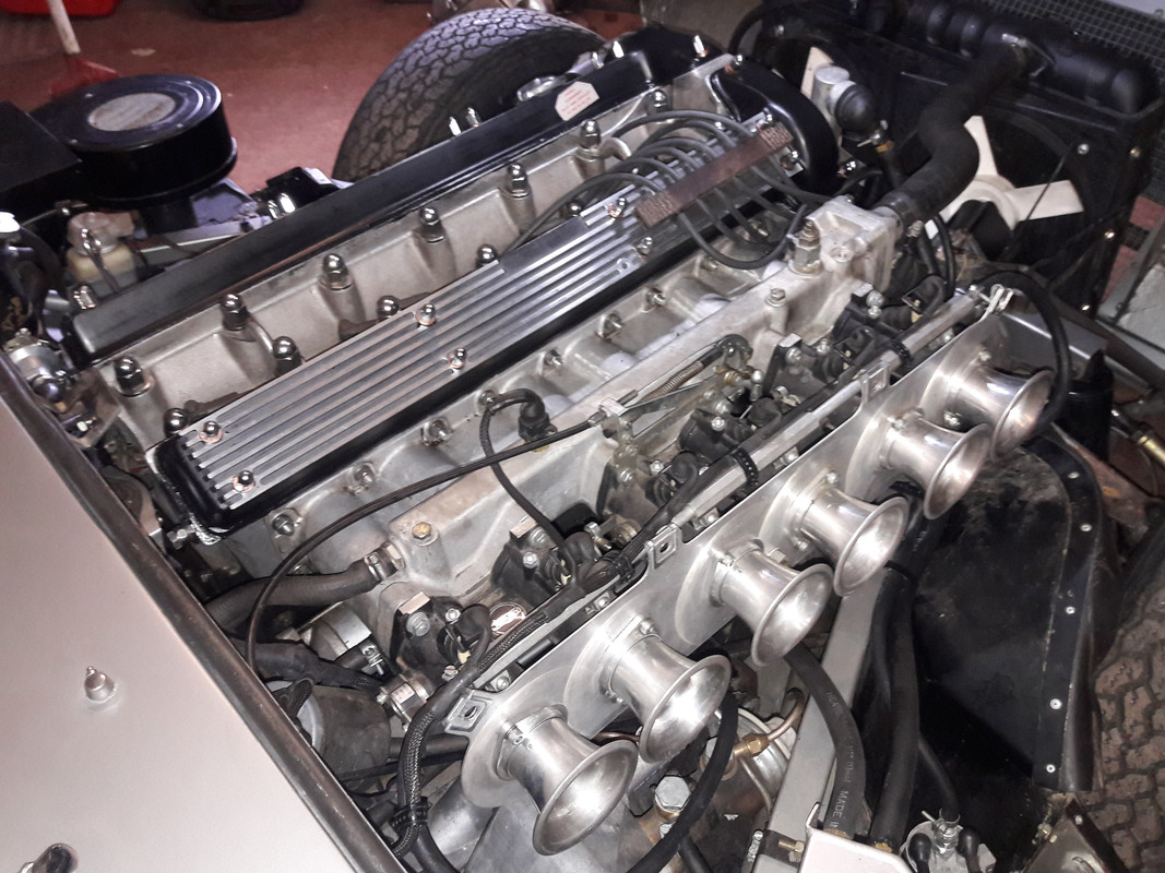

Sorry to hear about the paint!
I am pretty sure you can just fit the thermostat without the center section?
