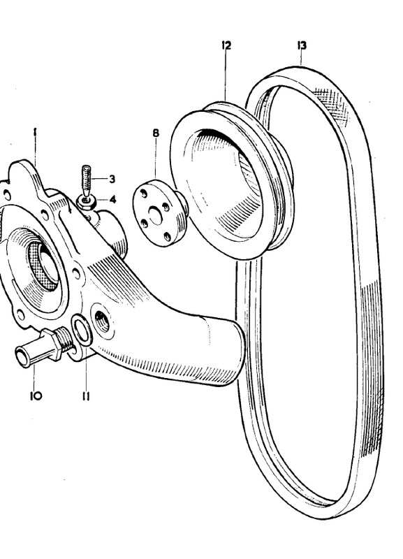

Post by autoalain » Sun Feb 05, 2023 3:13 pm
Looking for a pulley,(water pump) but do I need a 'w'belt ?? my bottom pulley is a single grove, my alternator pulley does not line up rite, moss book shows c25083, so much unknown on this darn basket case, does someone have picture of what should really be on the front of this engine, cannot find part c25083 on ebay,
afraid to start ordering parts when I do not really know what I am doing.
Posts: 15194
#2 Re: water pump pulley frustration 67 fhc
Post by Heuer » Sun Feb 05, 2023 3:32 pm
All 4.2 E-Type's had Duplex (twin groove) pulleys - crank, alternator, water pump - and matching belt, W in cross section:

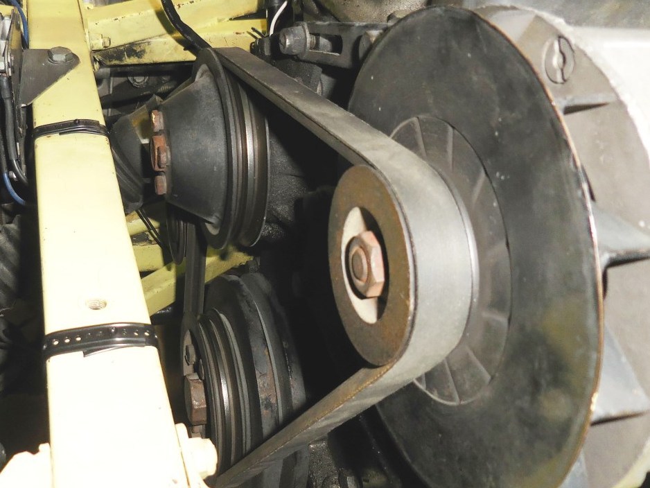

Not my car but similar. photo from the web.

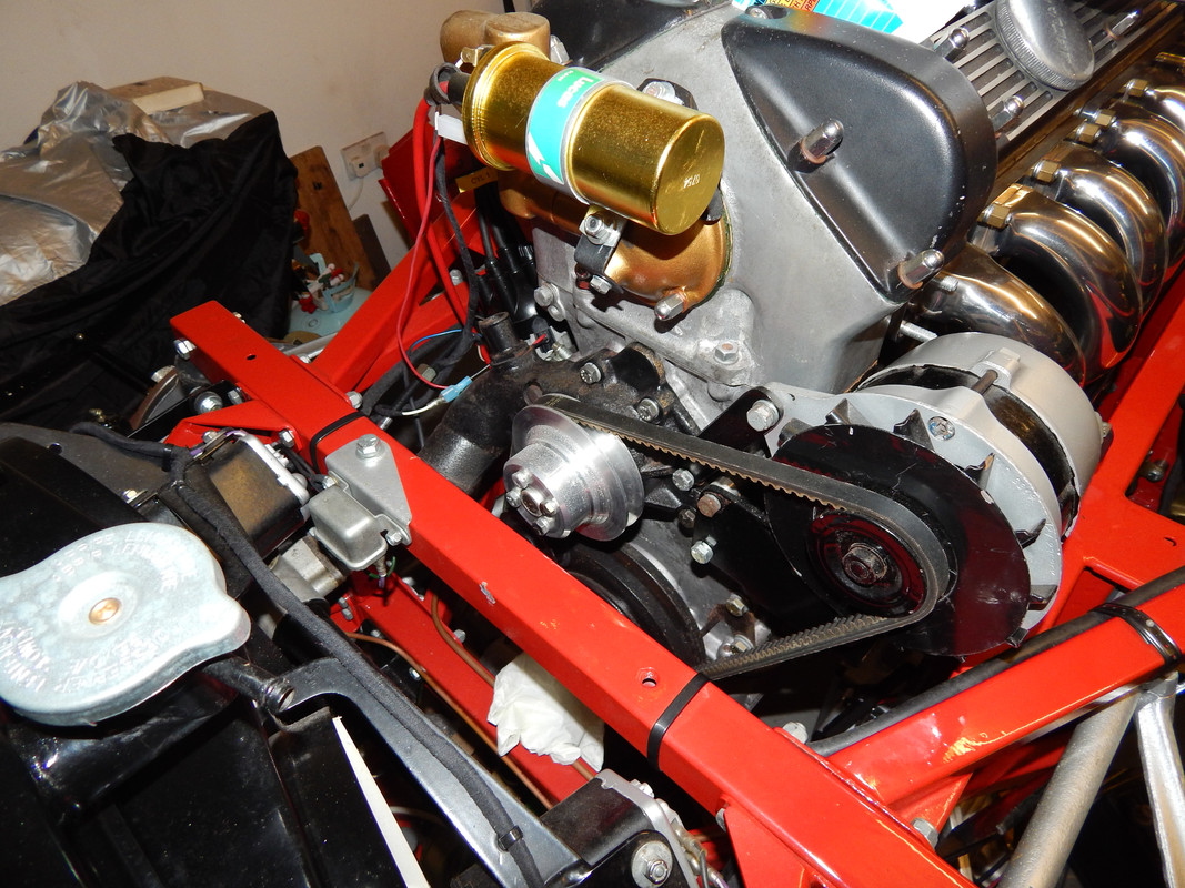

I had this problem with my series 2, I fixed it by turning up a new pulley that carried the correct V groove and the off-set to bring it all into line. I can take a photo and post it if needed, also my alternator bkt. looks different to yours, cheers John.

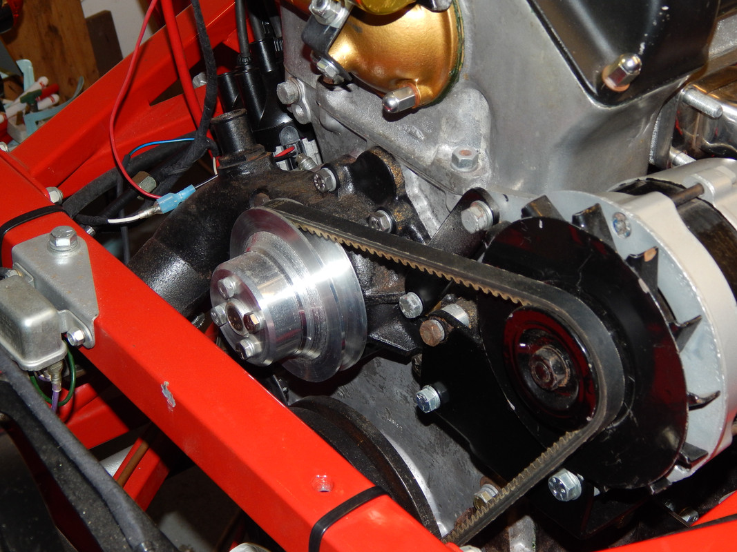

Post by Jack the lad » Sun Feb 19, 2023 2:17 pm
Photo of the one that I made for my Series 2. Not cheap as a block of alli is expensive but looks quite smart.
