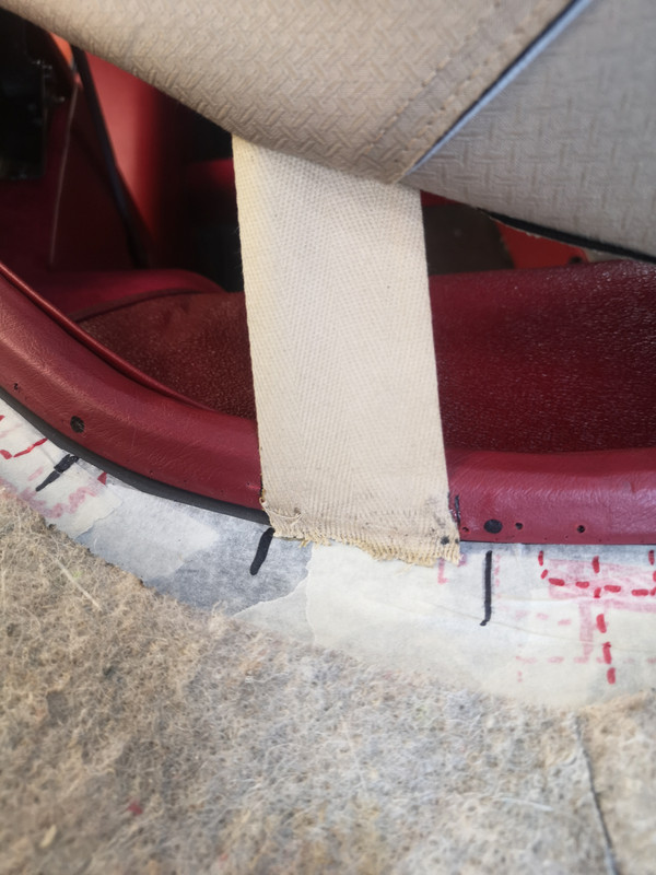

With no excess materiel to grasp either in the webbing or the hood fabric, I decided to use contact adhesive between both of them and the tack-strip, which BAS don't do (or need to) but which appeared to have the great advantage of NOT having to pull on not-very-much AND operate the stapler at the same time.
I began with the webbing, and appeared to have gained about 10mm on Jack's initial position, and once this was anchored with the staples, on top of the glue, I was able to shut the front hooks and establish that so far all felt fine.

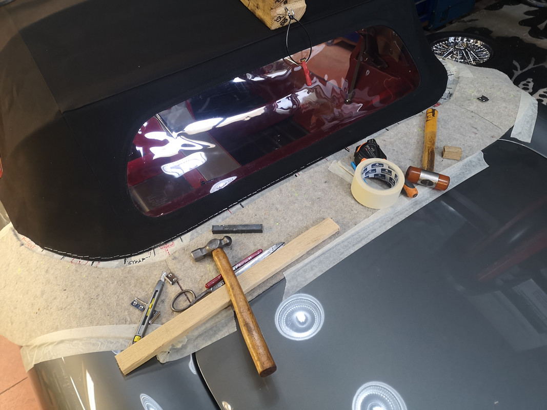

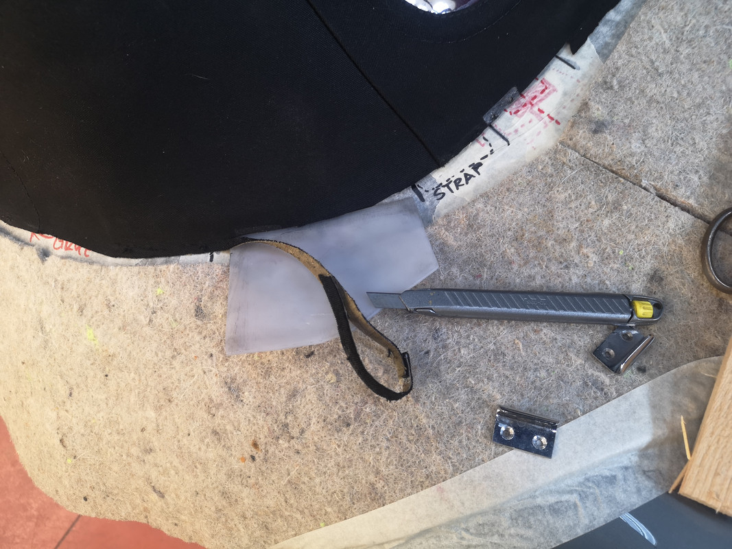

The next bit was so stressful that I forgot to take any pictures :banghead: but essentially I glued the last 20mm of the hood-fabric edge - a strip of 50mm masking tape along the outside makes it a) more manageable and b) protects from any over-run and marks - and glued the 25mm depth of the tack strip, and then once dry-to-the-touch I used two strips of plastic bag draped over the tack-strip to prevent any premature grabbing.
Then, still with the same gap at the front of the hood-to-screen, I pulled whatever tension I could get in the hood fabric and - starting in the middle - progressively extracted the protective plastic-bag strip whilst pressing the glued surfaces together, followed by the use of a mallet.

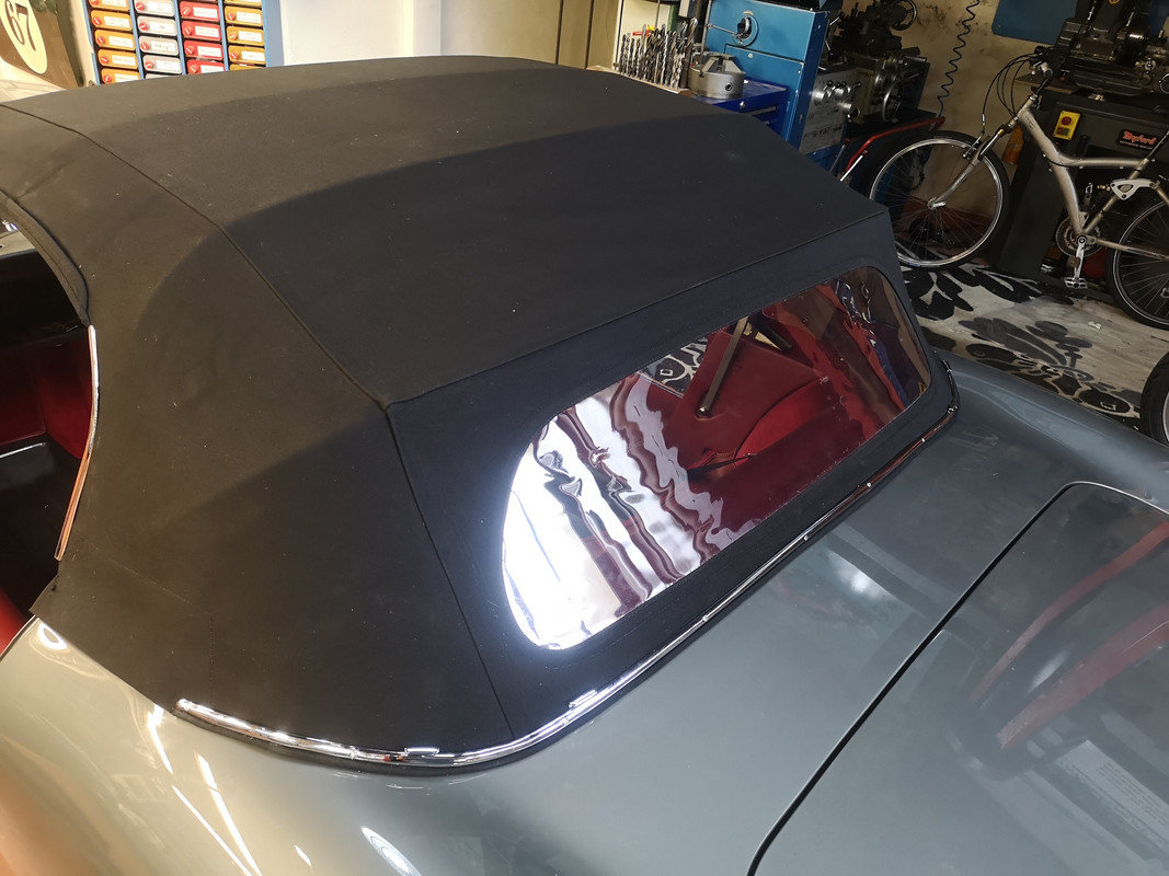

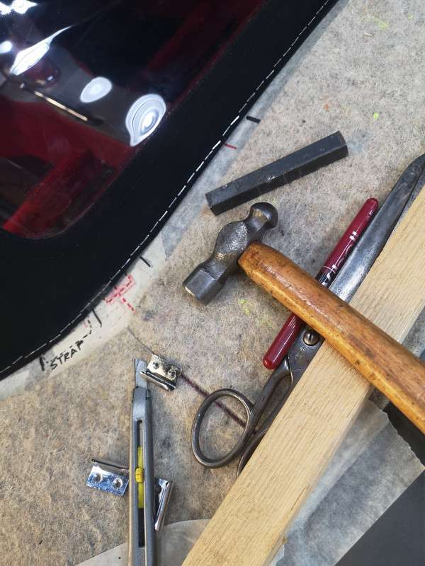

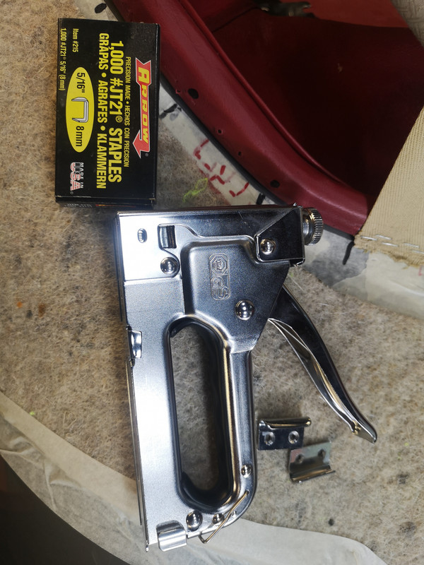

The result was a pretty regular 10mm of tension gained on the original staple marks, and with a wooden stop fastened to the end of the stapler, to give a regular line in relation to the bodywork curves, and a regular lateral spacing of the staples, I then threw all caution to the winds and cast it all in stone by stapling over the top of the glued position from one end to the other.
Given the shear-strength of contact-adhesive you could probably test your work at this point, before stapling, but the gung-ho in me got the better.
Cutting off the excess required a very sharp knife and a bit of stiff polythene (cut from a 20L can) which acts as a suitable sliding martyr, using the lower edge of the tack-strip as a guide.
Fortunately the result, once tensioned with the hood-hooks, which were a bit of a fight tho' I've had worse, is pretty damn perfect - it's tight as a drum, and looks a million dollars.

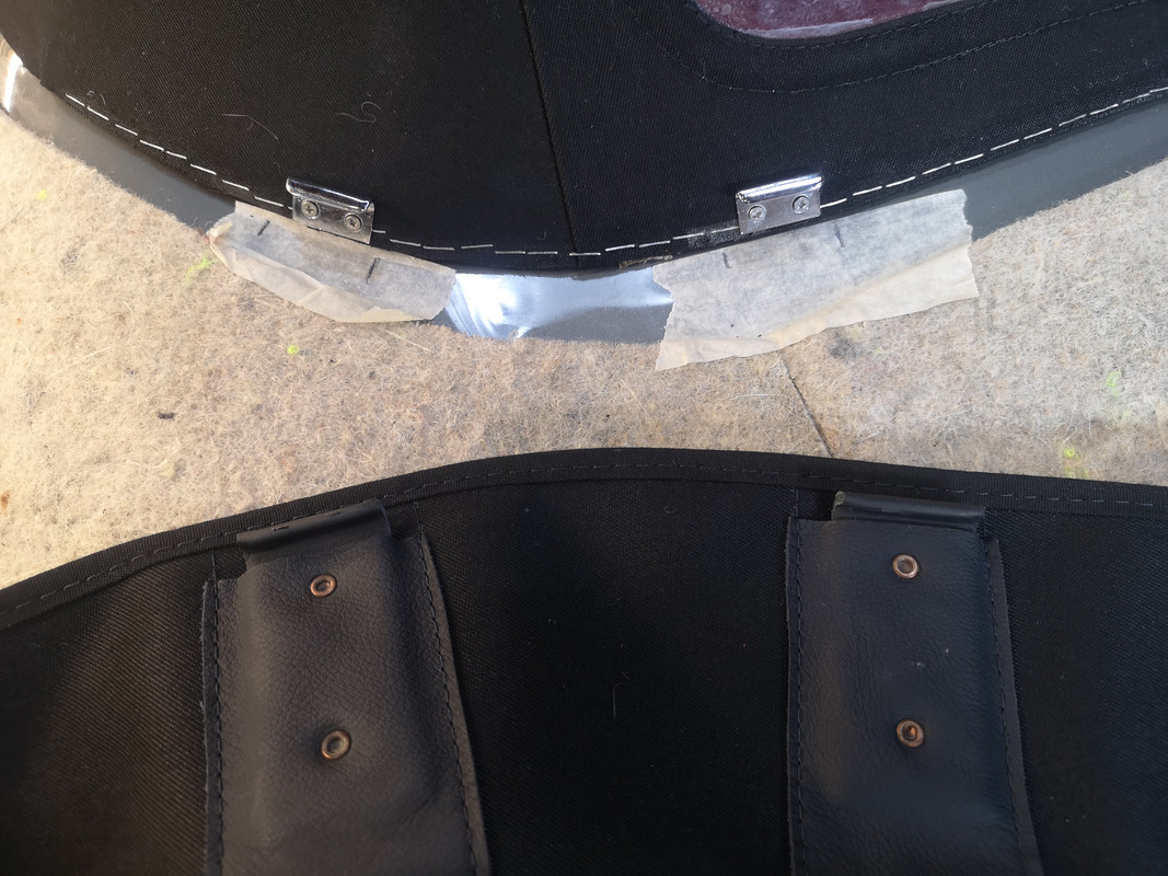

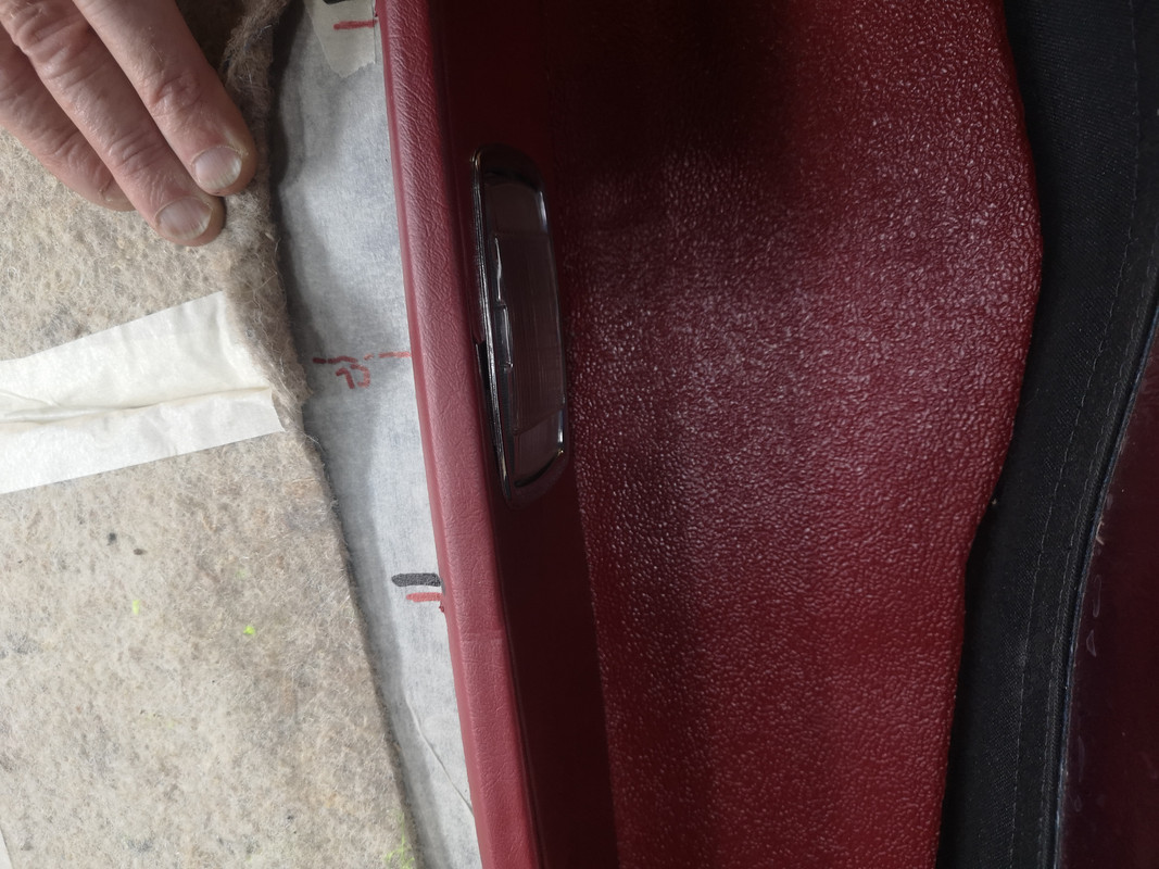

take some time to mark out on a strip of 50mm masking tape stuck to the rear scuttle where all the screws lie ;
use the inside-light as a reference and establish a centre-line on your tape ;

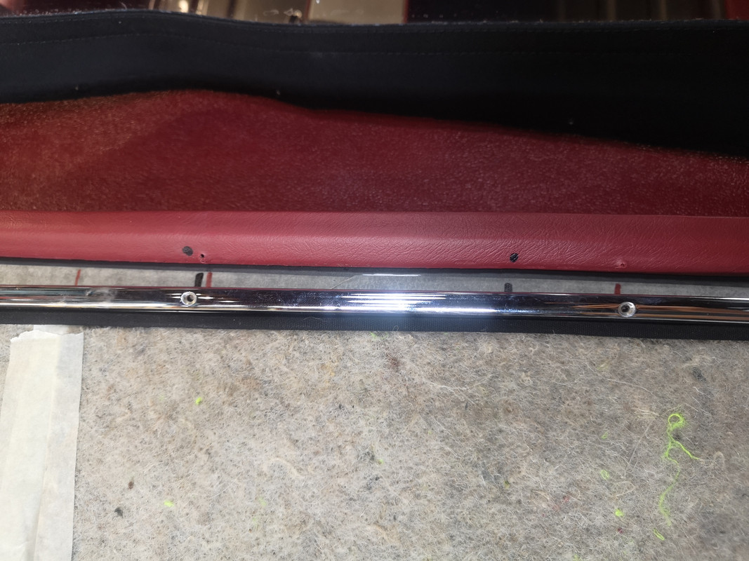

already, it's a good idea to mark the outside of the tack-strip where all its securing screws are as you glue the wrapped vinyl into place ;
use the hood-bag to calculate where the retention hook-plates need to sit ;
overlay the chrome finisher to see where its fixing screws fall ;
all this with the objective of not drilling into stuff that's hidden, when a little movement of one thing or another makes this not a fatality ;

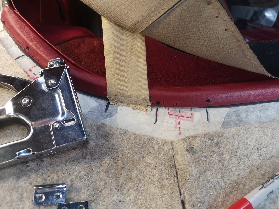

by putting the staples in at the lower edge of the tack-strip, you can basically avoid any interference with the rest of the screws as they lie closer to the centre ;
I used a manual stapler using 8mm (depth) staples - Jack says you can use 10mm, which is obviously better ;
I, ahem, "confirmed" their insertion with a hammer and a flat steel drift ;

by using #6 x 19mm CSK screws you can essentially get all eighteen of them (10 for the chrome strip, 8 for the hood-bag hooks) through the tack-strip and into the metal bodywork ;
once it was all in place I then removed all these, and blew out/off all the swarf ;
