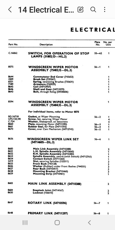

If you put your car model in the signature area it would help.....what is the part numberr in Jag parts catalogue for the screw?

I don't have the parts catalogue I'm afraid, so can't find the screw part #.

We have all the catalogues in the Knowledge base section....Steve ps unfortunatly this dosnt show the 3 screws fixing motor to plate maybe these were part of the motor unit

Do you have a parts catalogue from SNG Barratt? Almost every part is shown in there, ok some little items like these may not be shown, but it is a very useful guide to how parts are assembled and how many parts are needed with their parts numbers shown.
