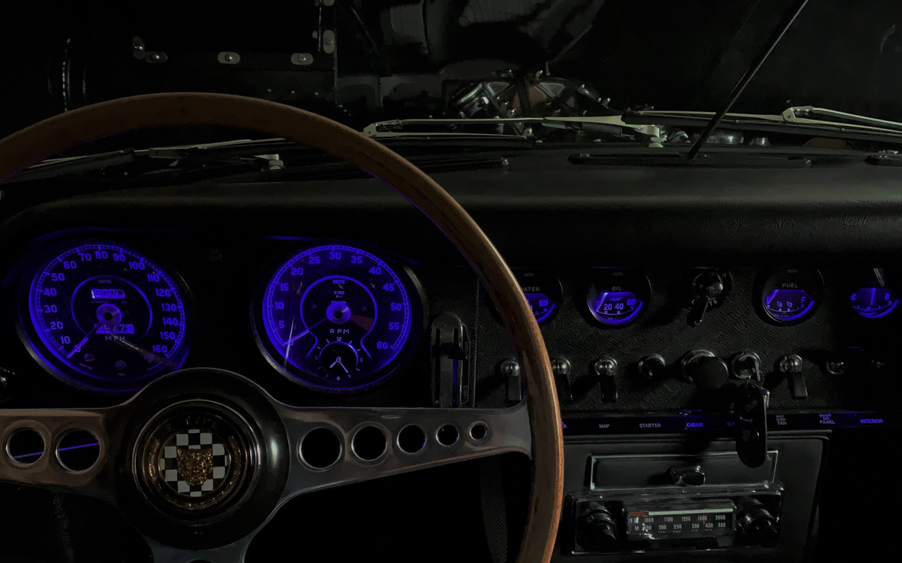

Post by Philk » Sun Sep 14, 2025 3:50 pm
3.8 cars have blue filters on the gauges. When I got my car, most of the gauges were showing white light since the filters had disintegrated. I fitted blue LEDs as per the picture below.
