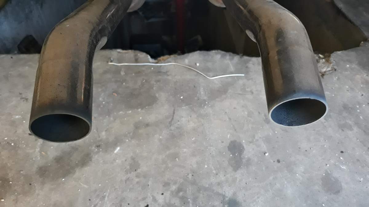

#27 Re: What causes plugs like THIS??
Another observation which might be relevant in this instance. The RH exhaust (which serves the rear three cylinders) appears to be burning more grey than the left one.
