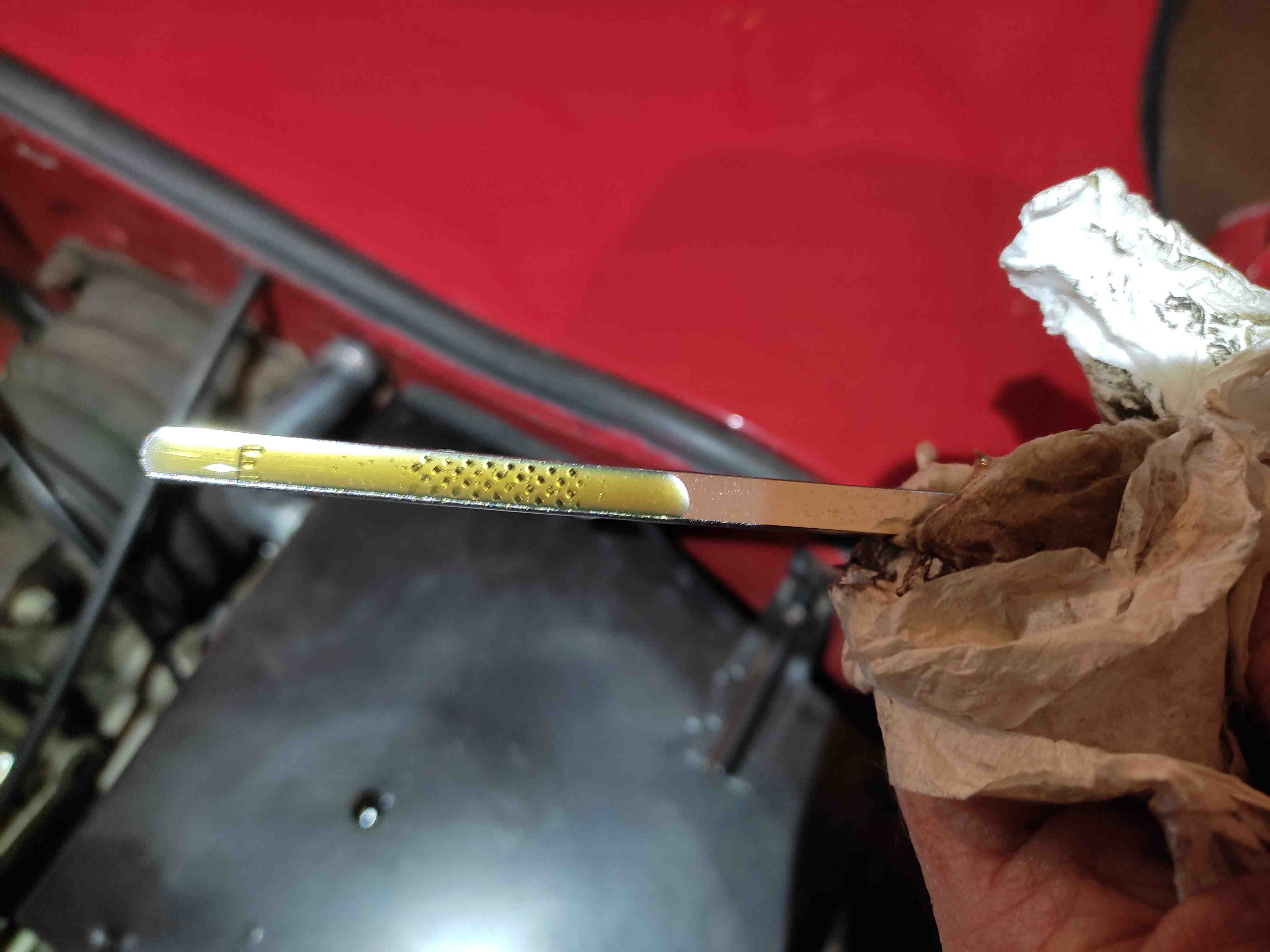

Post by DWW » Sun Sep 11, 2022 12:30 pm
What does your oil level show?

#34 Re: 3.8 low oil pressure
Post by paydase » Sun Sep 11, 2022 1:14 pm
More than enough, slightly overfilled by the PO.
I let it like that:
Serge
1964 (3.8) FHC
1961 OTS
Posts: 1202
#35 Re: 3.8 low oil pressure
Post by DWW » Sun Sep 11, 2022 2:39 pm
Ok, because once mine read low on hot and I was 2 liter down on oil, refilled and back to normal.
