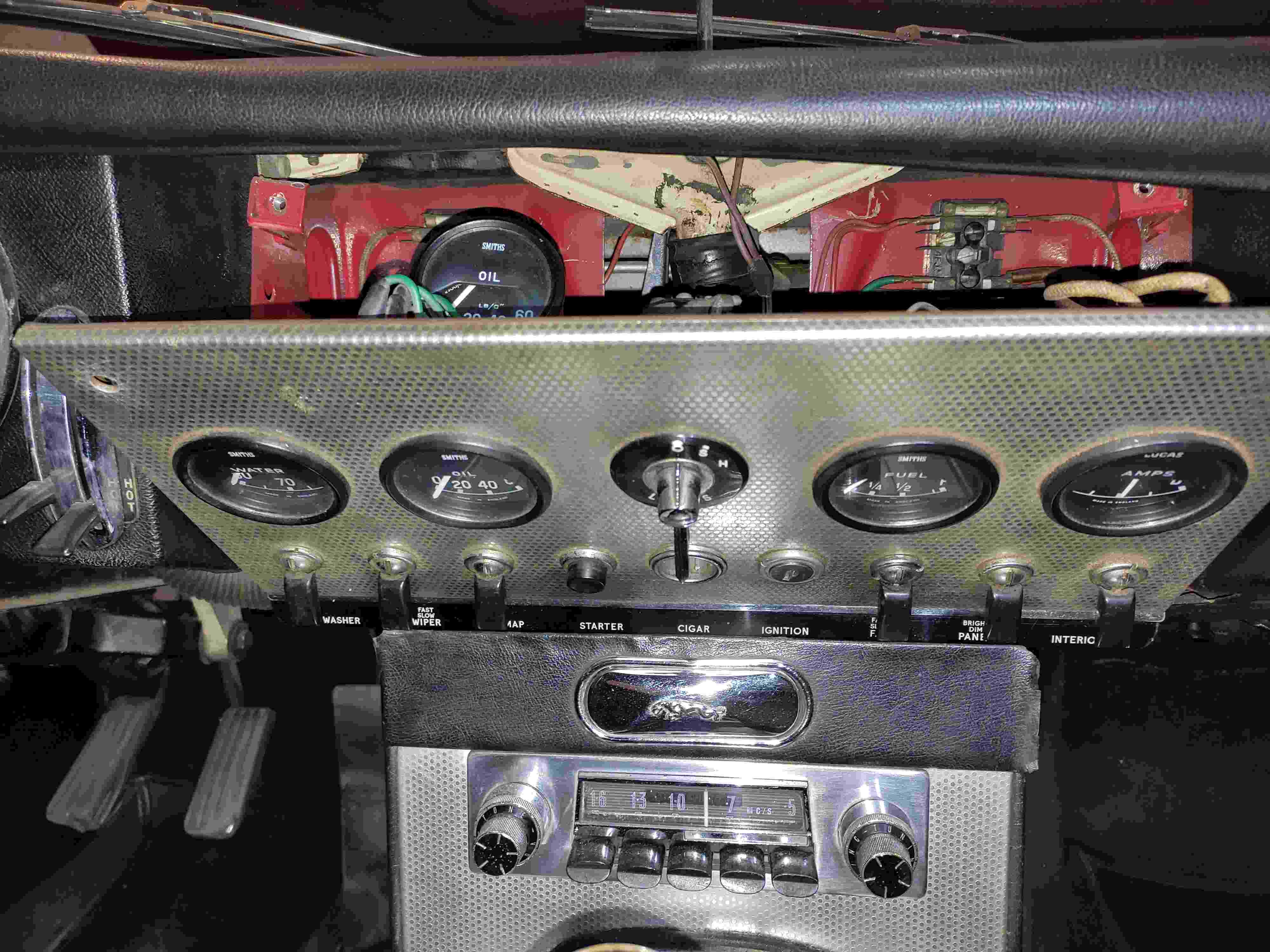

I've got my New Eve (E) gift today 31st December
Normal oil pressure read after having installed a mechanical gauge!
60 psi when starting engine cold:
Still 20 psi at idle when engine hot, while electric oil gauge showing close to zero (the gauges are blurred by water vapor, I have to fix that...):
That is a mystery for me because I had replaced both the sender and the receiver of the electric oil gauge by good ones (these work on my FHC and show good oil pressure even when hot).
Maybe a weakness in the electrical circuit, I dunno
Nonetheless, it's very reassuring and I can now work further in improving what needs to be done, in particular the cooling circuit (my cooling fan is still the Boeing blade and my header tank is leaking).
I will post further infos and pictures to show how I installed that mechanical gauge and how I routed the cabling.
Happy new year to everybody!

#40 Re: 3.8 low oil pressure
Why don’t you put it in the dash?
