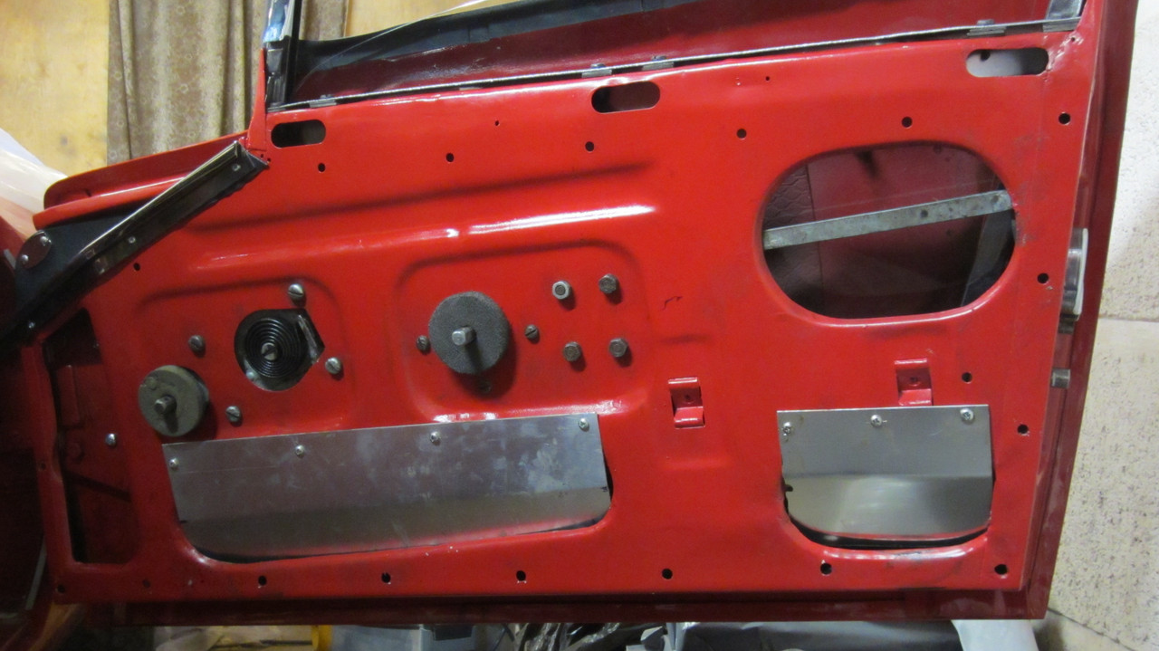

Does anyone reproduce the water deflectors that are riveted to the door shell behind the door card to prevent water from splashing outward?

I think Vipergts means these:
These are homemade; I don't think they are available to buy??

#6 Re: Door water deflectors
Post by paydase » Fri Apr 09, 2021 5:20 pm
I have them also on my car.
Not in alloy but in steel, painted black, riveted:

#7 Re: Door water deflectors
Post by vipergts » Fri Apr 09, 2021 5:32 pm
Yeah they’re the ones.
Resigned myself to making some which I did today.
Will seal them on and the membrane with dumdum
I’m determined to stop water ingress

Post by 288gto » Sat Apr 10, 2021 8:00 am
I think they were to try to prevent water that might collect in the bottom of the doors, getting past. It can come out onto the inner sill and also damage the door cards. Always make sure the drain channels are clear. It's easy to block these if you have waxoyled inside the doors.

Post by paulsco » Sat Apr 10, 2021 8:54 am
The parts manual for the Series One doesn't mention them, nor do they appear on the SNG site for the Series One.
They are however listed for the Series Two.
I would have concluded that they were a later addition if it wasn’t for Surge's 3.8.
I would agree with Simon that they are there to prevent water getting past.

#13 Re: Door water deflectors
Post by paulsco » Sat Apr 10, 2021 9:03 am
Well would you believe it.
I have just had a look at some old photos and they were original on my car too.
