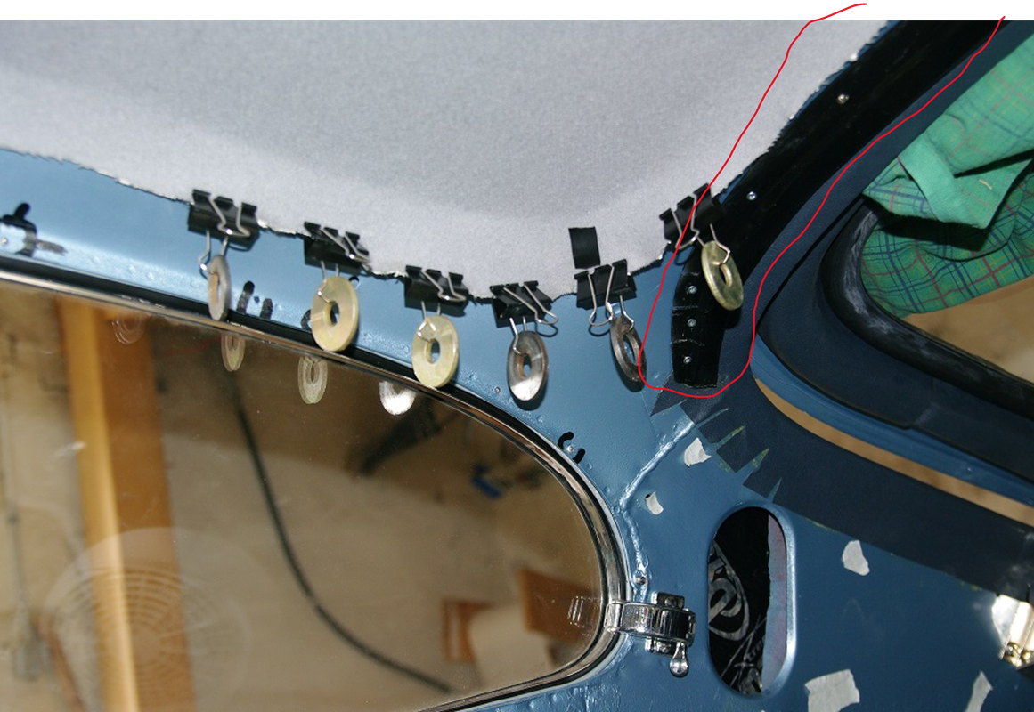

I've started on the headliner ( :shock:), and just found out I'm missing something.
That black thing that I've drawn red around, one per side, I don't have them. Can't see them in parts book.
About them:
-what are they called?
-part #? Available?
-riveted or screwed?
-used for what? I would guess rear part of headliner?
Mikael

Post by Allrand » Sun Jun 09, 2024 1:19 pm
That's the hatch apperture edge trim. I think mine was rivetted in a few places. The sequence of fitting looks problematic in your picture. The headlining edge needs to be tucked in above the cantrail moulding , then the curtain also needs to be tucked in there & the rear edge hooked onto the serrated teeth first, then the hatch edge trim pushed in above the serrated teeth. That's the way I did it.

#8 Re: Interior, tips please
Post by No Quarter » Sun Jun 09, 2024 1:55 pm
Allrand, the picture is not my car, and I agree there's something wrong with the process (boldly stated by someone that hasn't finished it yet ;-))
Those black metal things with serrated teeth, what are they called? Any ideas? Gotta see if I can buy them

Post by Series1 Stu » Sun Jun 09, 2024 8:09 pm
I think they are items BD20266 & 20267.
They are called Trim Panel rear above cant rail RH & LH.
They are rivetted on with, I think, 3/32" diameter rivets. Definitely not the more commonly used 1/8" ones.
I covered mine with a piece of scrim foam to smooth out the contours a bit better.

Post by No Quarter » Mon Jun 17, 2024 7:18 pm
My car is old enough to have a 2" wide plastic thingy in interior colour that runs all the way around the rear hatch opening. I believe later cars had vinyl glued on instead.
That plastic thingy, where does it go when meeting headline grippers in front, rear side casing on the sides and aluminum plate at the rear? What is on top, is the thingy tucked in under all those or vice versa? Looking at pictures online, I seem to see both solutions
