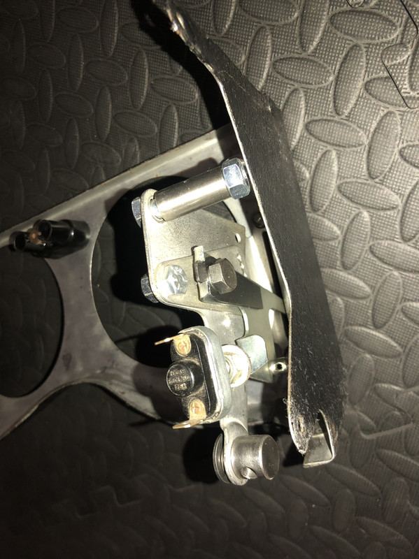

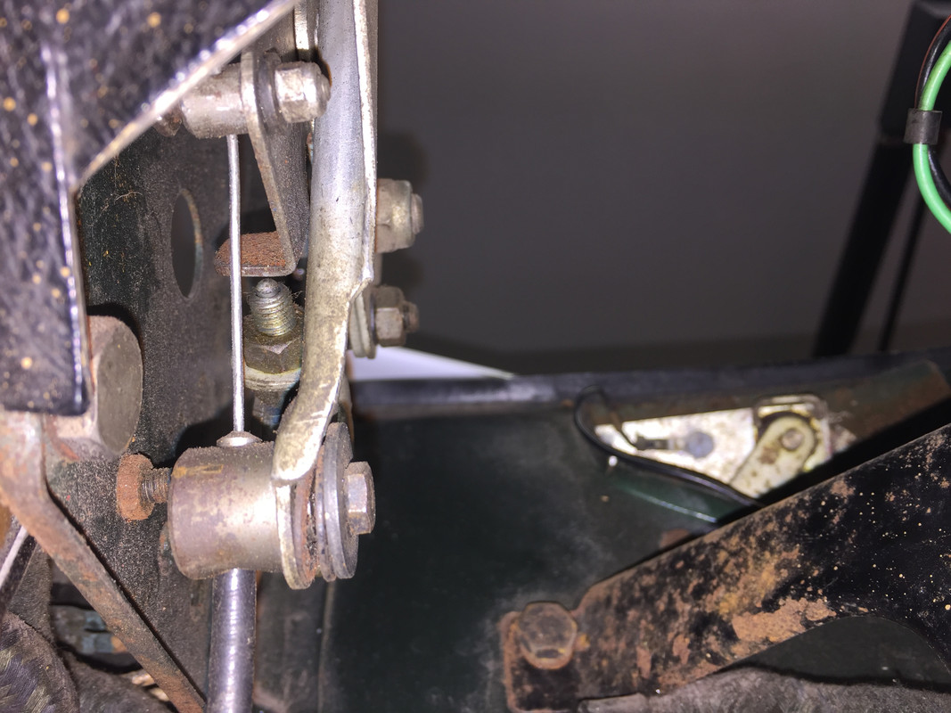

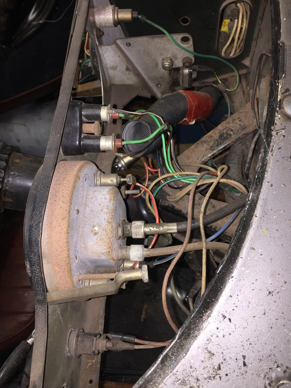

#4 Re: Senior Moment Choke Cable
Post by Robbiee » Sat Jul 13, 2024 1:59 pm
The return is not too deep
Here’s some photos
I still think it’s much easier from below!😊

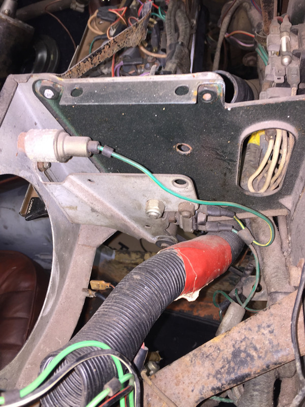

#5 Re: Senior Moment Choke Cable
Post by Robbiee » Sat Jul 13, 2024 2:00 pm
And this:
