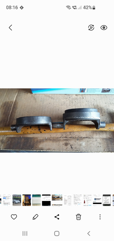

Thete are several different release bearings..ensure that you have the correct one....have a look at this photo and note the difference in the main body from pivot point....yes one is worn but you can see the difference....Steve

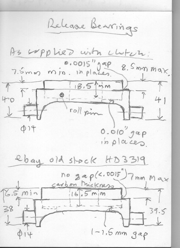

Thanks. The ebay old stock version is the same size (apart from assembly differences) as the new one supplied by Barratt's with the 4.2 diaphragm clutch. In the new bearing there was a 0.0015" gap in places around the circumference. The old one didn't have a gap here, but there is a 1-1.5mm gap on the rear face- ie it isn't fully seated into the recess. I currently think I'll use the old one since it doesn't have the roll pin.
The roll pin must surely have been added in an attempt to prevent the bearing rotating, but I've yet to find anyone with any engineering understanding who thinks it's a good idea.
