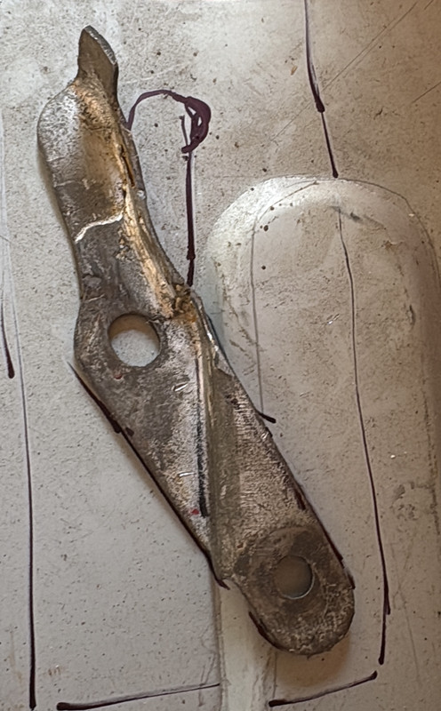

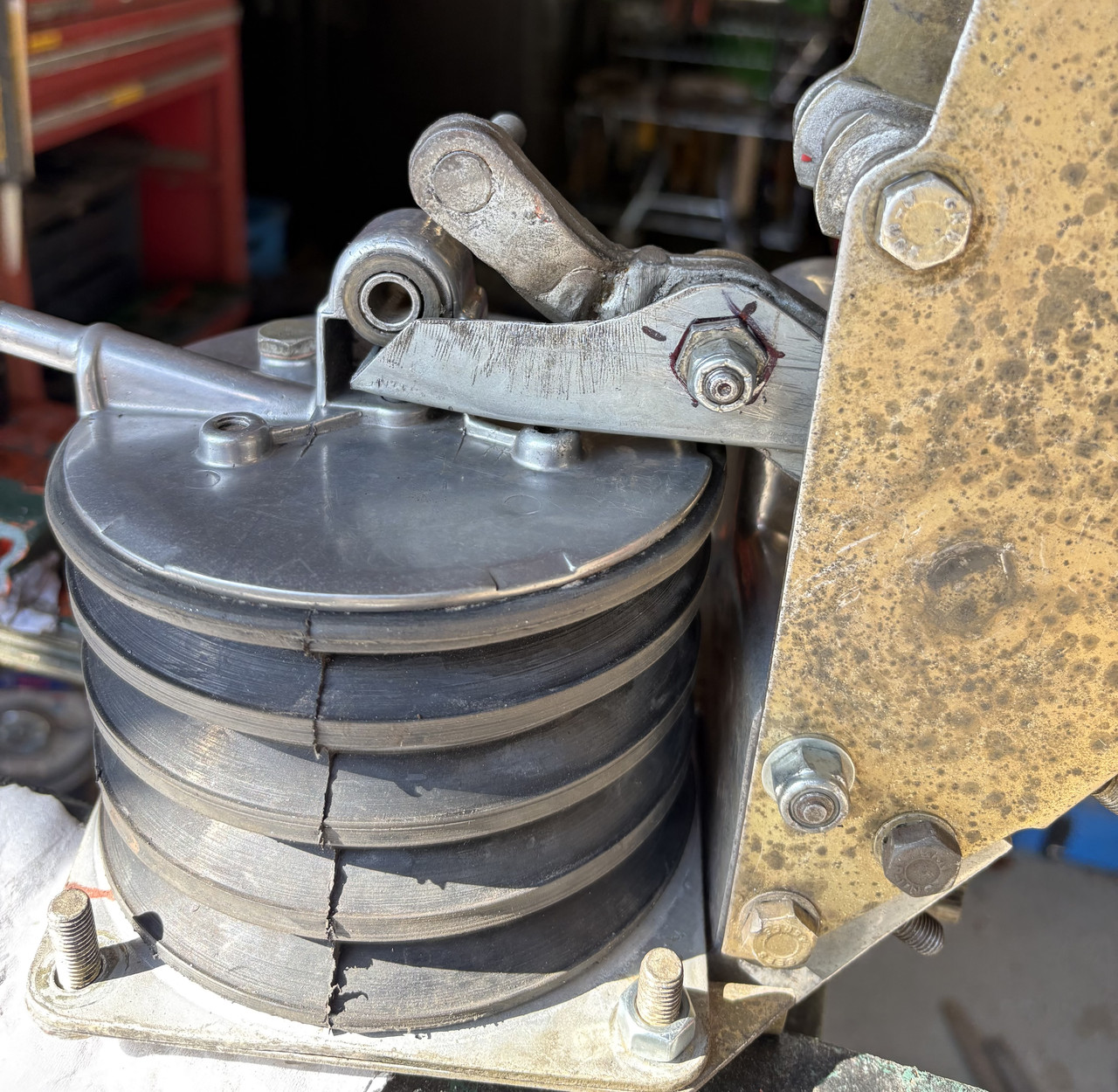

For 4 years I’ve been ignoring the elephant in the pedal box.
So enthused by my recent sucesss re bushing the steering rack and arb, I thought I’d take a casual look at fitting a brake light switch and adjust the clutch & brake pedals.
So here I am 3 days later attempting to assemble everything in the correct order and refurbishing, replacing and including previously absent components .

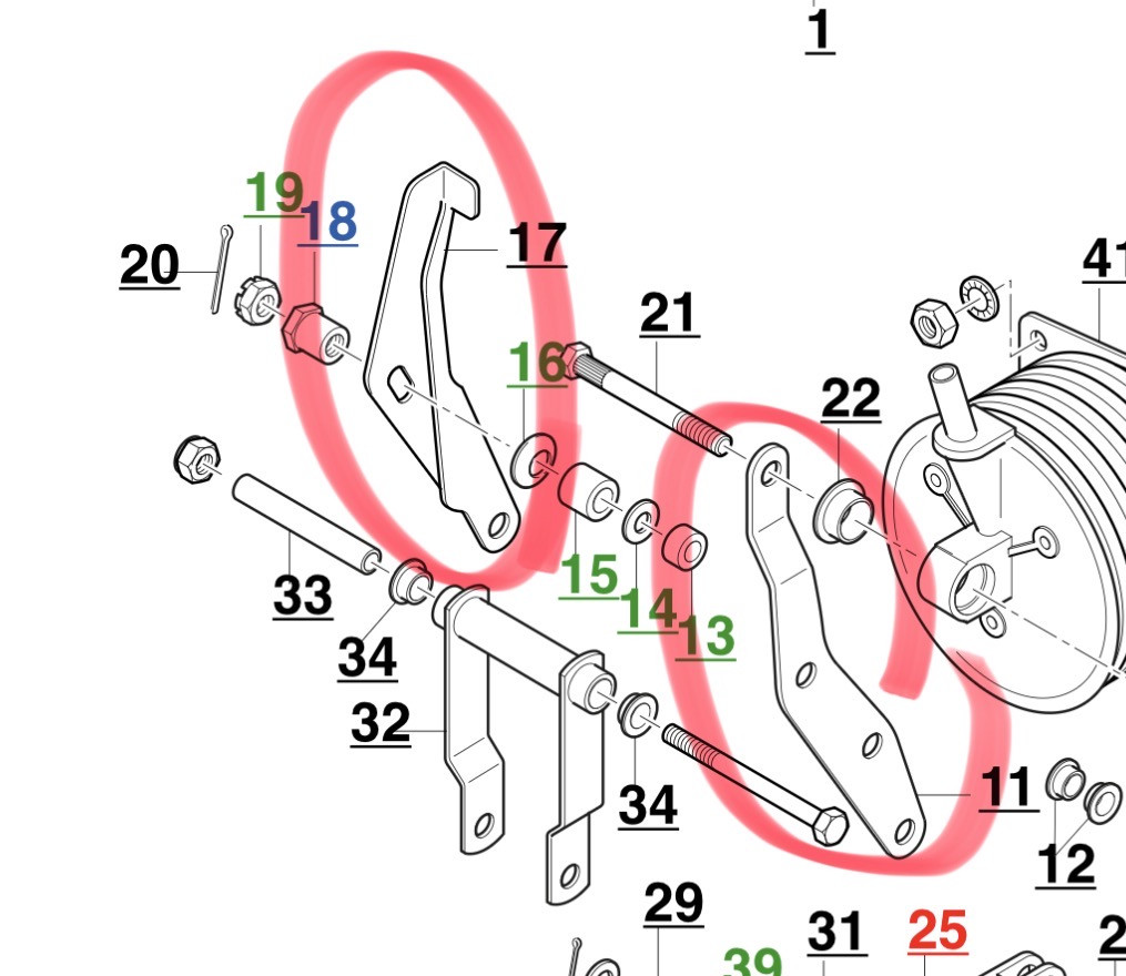

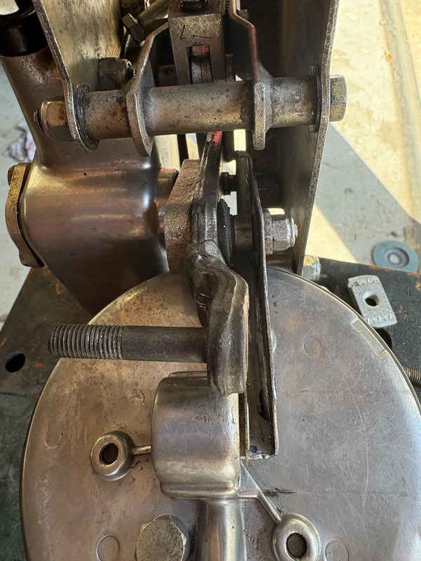

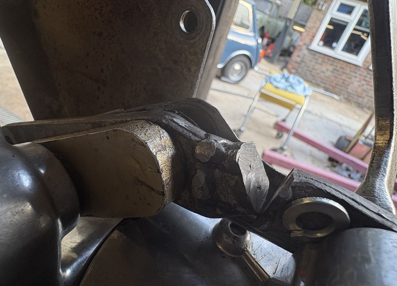

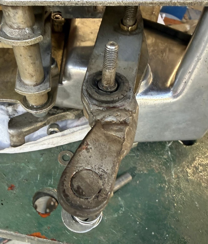

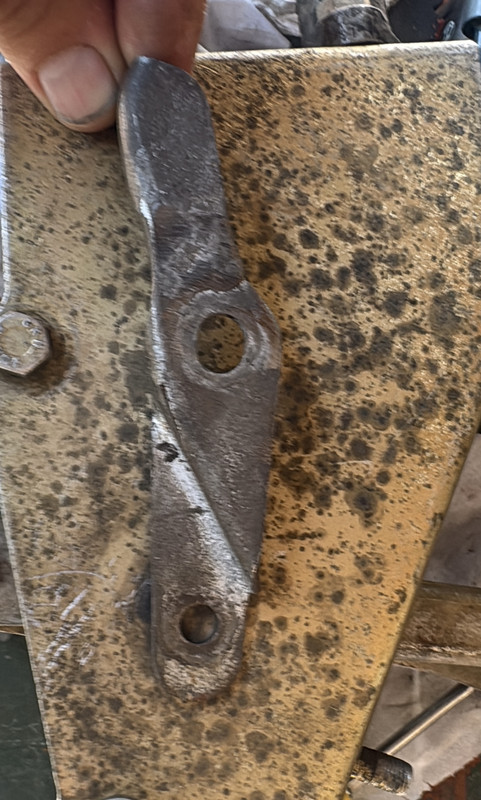

I’m unsure why C20320 the connecting lever, between, pedal shaft and end plate of Servo Bellows and C17242 the arm operating the brake servo vacuum valve button, have at some point been cut and re welded at such an angle they now restrict full motion of the bellows.
Does anyone have a disassembled unit they could photograph the above parts in plan view or template so I’ve a better chance of accurately replicating its original form.
Trevor.

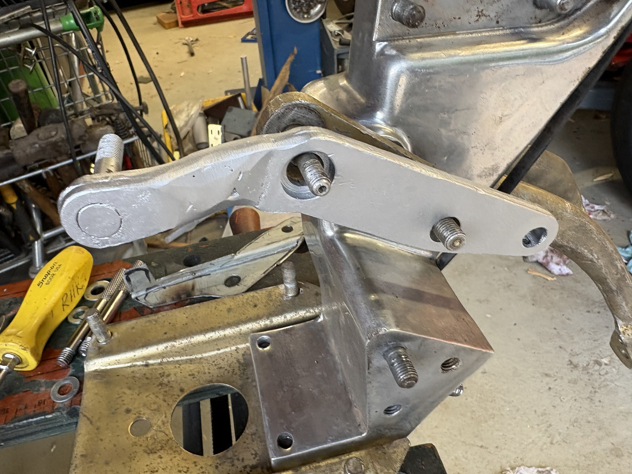

Overwhelmed by the response I set about reverse engineering the problem.
Assuming that the mutilated servo operating arm was originally a simple pressing
I thought I’d have a stab at making a new one to test before destroying the remains of the last engineers efforts.
And then you find out why you’ve lost days chasing your tail and trying to adjust the unadjustable, and a dozen other mistakes made when it was last assembled. None of which help make sense of a manual that says assembly is the reverse of dismantling.
So with used pedal boxes running into four figures and restored ones twice that, what do you do….
It all went back together and then surprise, I had to clock the brake pedal once more. I’m still not quite finished because everything you move to gain access swallows another day making it right.
Trevor.
