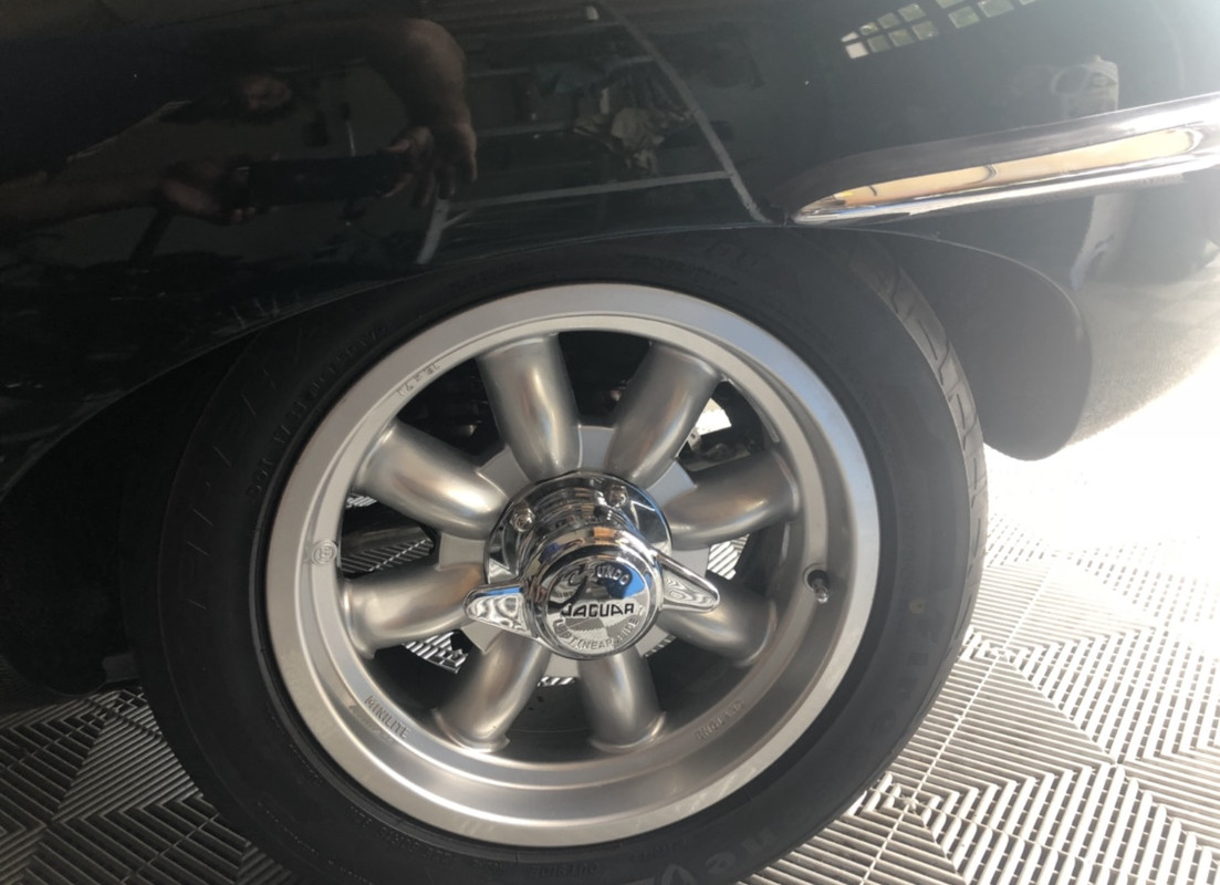

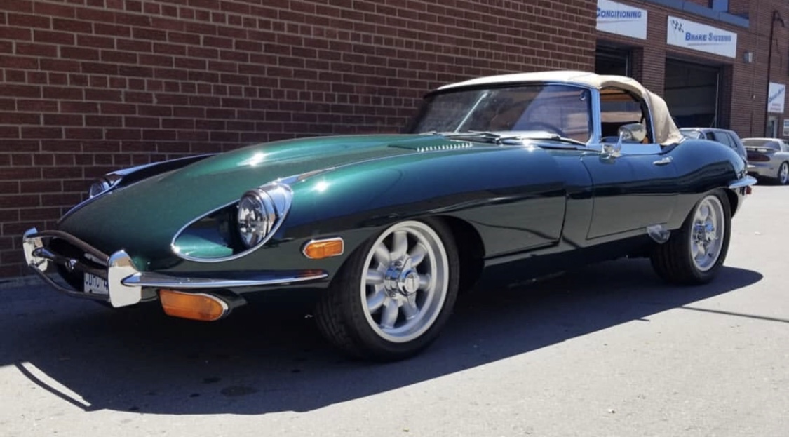

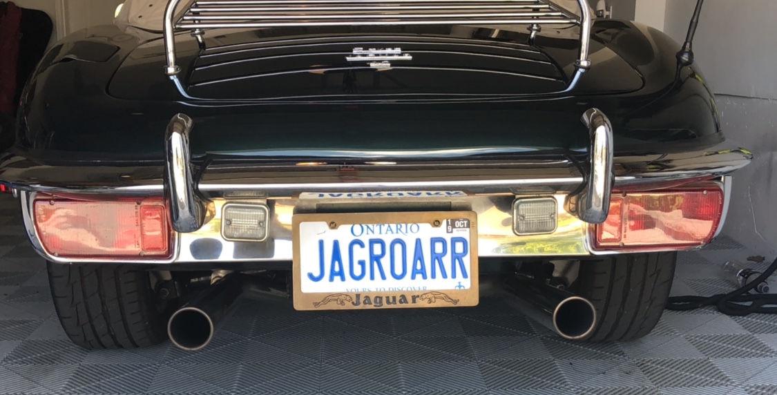

With a little shaving of the rear fender and removal of the bump stops This is how 16x7 Minilites looks like with 225 50 16 in the rear and 215 50 16 in the front.

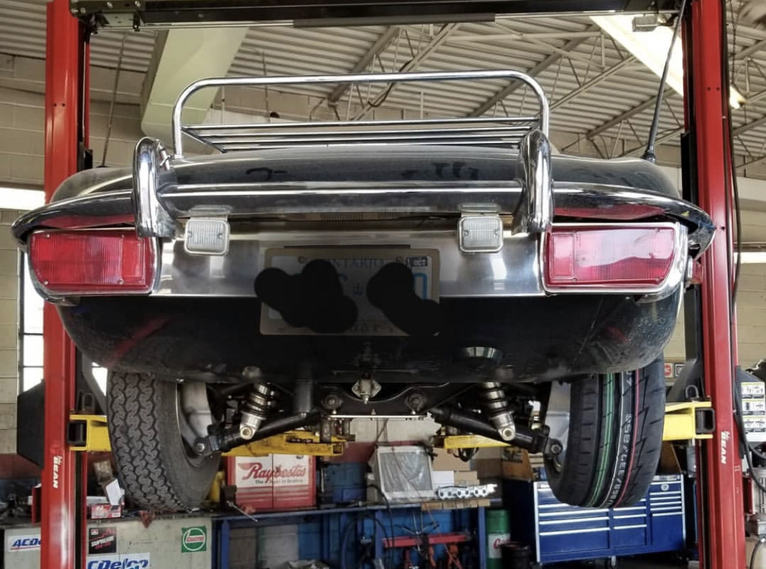

I think they look fantastic !! Must give you tremendous grip in addition. But don't you find yourself scrapping exhaust pipes on high curbs, or driveways ? Also, do you find yourself bottoming out on occasion ? 50 series tires are pretty aggressive in regards to ride height. I tried 60's for a while, some time ago, and even with car set at correct ride height, it bottomed out a bit. Again, they do look great !

With all then engine modifications she went through she really needed more rubber on the road. The handling on winding roads and hwy on and off ramps are a lot of fun, very sticky. I'm looking forward to a track day with the club in the new year. As for height clearance issues there's been non so far, the uprated 16inch rims fill the wheel well perfect (IMO). The over all tire/rim diameter decreased 7cm from the original set up. I have adjustable shocks all around so I can play around with that if any issues arise. If anyone would like to know the ride height difference give me some points and I'll gladly measure them.
