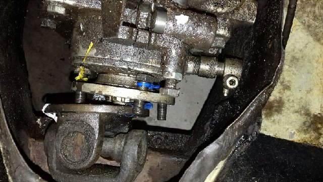

As I near a point where I can lift off the body off my engine, I've a couple of queries
Firstly, looking at the photo - they are separated, but the bolts will not come out? So will the bolts snag when the body is lifted? Also, have the bolts been inserted the wrong way around?

JC (can you put your name and car details in the auto-signature strip so we know who we're talking to?)
Those bolts are in the correct way - I asked the same question when I was dismantling line and learned that they won't come out unless you remove the gearbox flange.

Hi John...the propshaft has a sliding joint so should push back a bit.......Yes its very possible to do this single handed....but if your not completely confident in what your doing then you really need assistance....especially if you havent got everything completely supported and something goes wrong.....Steve

The bolts won't come out. That's OK.
