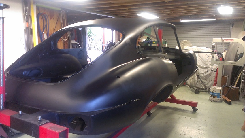

I have managed to get hold of a rotisserie to enable me to work on my S3. I am looking to make some brackets to get the rotisserie to fit my car but need to know if any of you good folks have any pictures of where to mount it to the back end? I have had a few suggestions, but believe a picture tells a thousand words.

I'm assuming the rear end of an S3 is not a lot different to an S2? If this is the case then these pics of the rear rotisserie mounting on my S2 might help?

Those pics are really helpful.
Thanks very much.

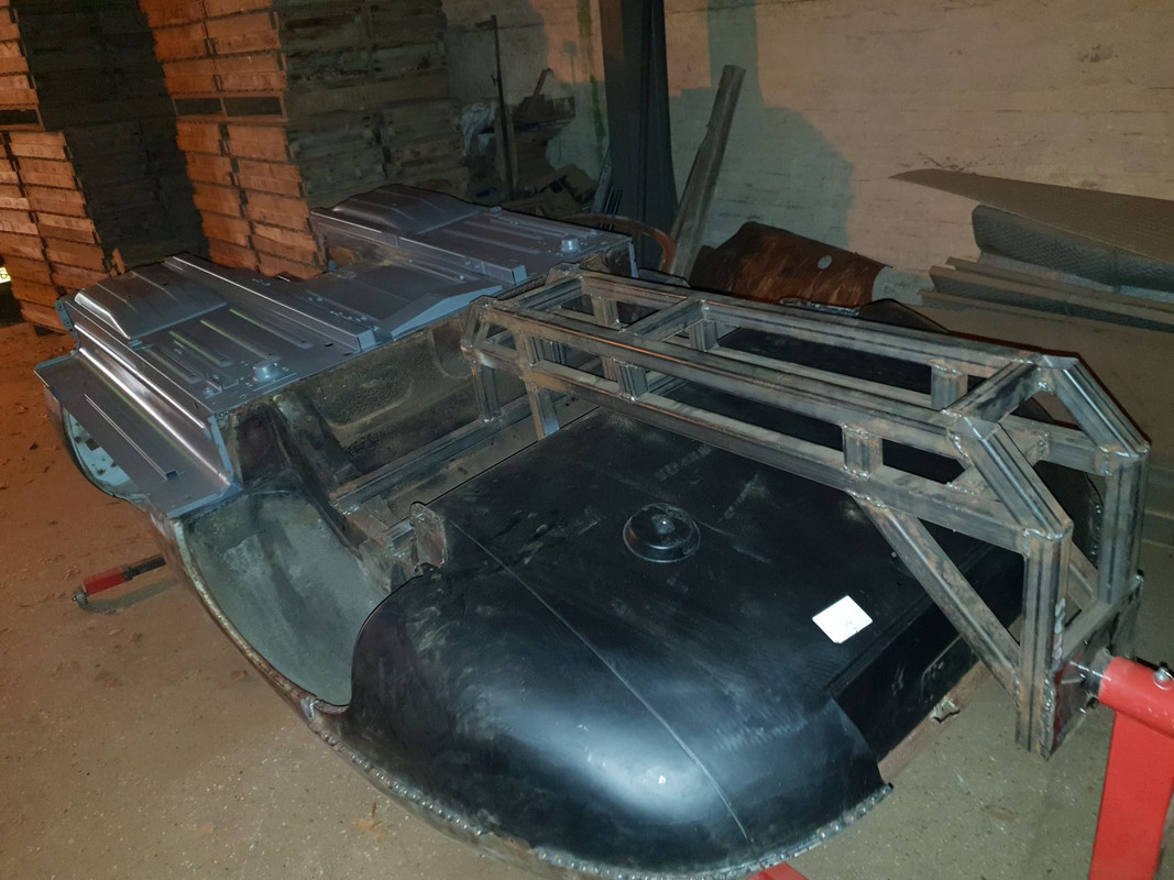

This is how I made the one on mine. With the front I utilised the front Picture frame as the frames were rusted. and the rear I attached to the Rear to the Middle bar mounts and drilled 2 extra holes to mount the lower bracket.
