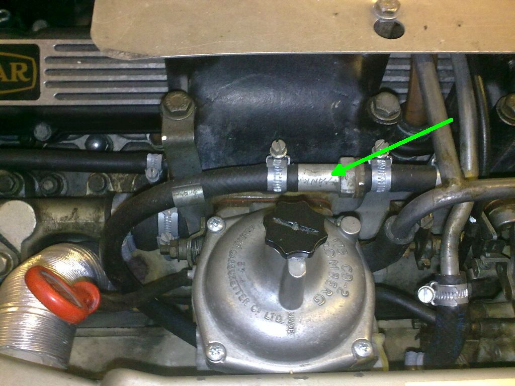

2. The fuel recirculation system isn't working effectively leading to fuel vapourisation. When the ignition is turned on can the pump can be heard running at a constant rate and is the pressure sustaining valve making a quiet sizzling noise? (The valve is mounted above the left front carb with Strombergs)
Bob
