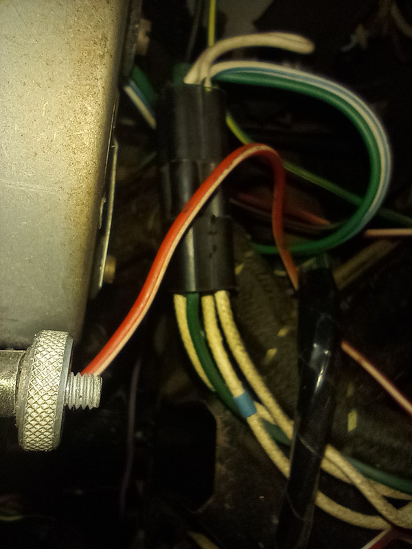

Post by IFC123 » Tue May 03, 2022 7:57 pm
Hi Marek/Colin,
Thanks for your help with this.
I thought I would post some pictures of the ballast resistor connections on my car, they certainly seem to be at odds with the wiring diagram.
The blue & white wire attached is not one of the 3 wires coming from the tacho connection, so I assume it is the one going to the ballast relay.
The white wire going to the negative side of the coil is from the tacho connection.
The other white wire, joined by a PO to the black wire is connected to the other side of the ballast resistor, is from the tacho connection, but not sure why its on that side.
Not sure why there are only 2 wires at each side of the BR, but there are only 2 spade connectors on the near side.
There seem to be 2 wires, blue/white & black/red to the Amp missing.
I will trace all the wires back to ignition etc when I get back from holiday.
Ian

Post by MarekH » Tue May 03, 2022 8:38 pm
It's thirteen months since you started this thread and you now disclose that your car is not wired as per the Jaguar wiring diagram. To date, the advice given has assumed your car was standard. I don't think any of us can help you until you make a wiring diagram of what is connected to what. It is foolish to assume anything at all given this new information.
Failing that, disconnect your tacho and put the car back into a state where it starts and runs normally and you can then think about the tacho later, when you know what works, what doesn't, what colour wires are connected to what and what is different to standard.

Post your version of the diagram like Colin did from the manual. You're going to need that anyway as your ballast appears to be non-standard, so perhaps the rest of the ignition is also non-standard.
Your car started, so we know it didn't have a fuel problem.
It also means the ignition system works when fed by the white/yellow wire from the spring loaded position3 on the ignition switch.
You know it doesn't work when fed by its normal white wire feed from position2. You know you need to trace that white wire continuity as it hops from behind the dash, to the ballast and then through the ballast (if that is what it does) and then onwards. You also know one good reason why that white feed was broken.
The s3 was originally offered as both a 6cylinder car and as a 12cylinder car. The 6cylinder car had a tacho which worked just like an inductive timing light worked. The ignition pulses were sensed by the tacho by sampling the change in magnetism on the white wire on the way to the coil. The v12 OPUS ignition system did it differently. The wiring loom thus accommodated more than one option. Added to that, the v12 moved the ballast and coil from the front left hand cam cover to the back during the production run, so there are legacy items in the loom - not all wires "make sense".
A ballast usually performs two functions:-
1/ It is harder to start a car than to keep it running and starting a car drains the battery. During cranking, the coil is usually fed either directly or via only a small resistance, so it gets full voltage to start. During normal running, it is fed through an additional resistance so it is not overfed.
2/ The clue is in the title for this one. The material chosen for the resistance in the ballast is chosen very carefully because its resistance properties vary with temperature. The temperature of the ballast resistor depends on the coil charging current running through it. At high rpm, the coil has little time to charge up so receives less cumulative current inflow. It cools down a bit. This makes the ballast resistor resistance drop a bit. More current flows in quicker to recharge the coil at high rpm so you get a good spark at high rpm. At idle, the opposite happens. The coil has too much time to recharge and so is fed too much current. The ballast resistor resistance goes up and so it limits the current going to the coil, thus stopping it from overheating. Some ballasted ignition systems simply used a specially chosen wire made of the right material as the resistor, so don't assume anything about cutting and replacing wires until you have documented what you actually have fitted.
Worry about the tacho later once your car is up and running normally.
