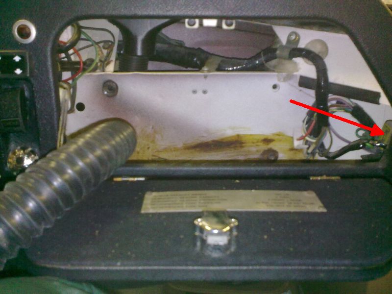

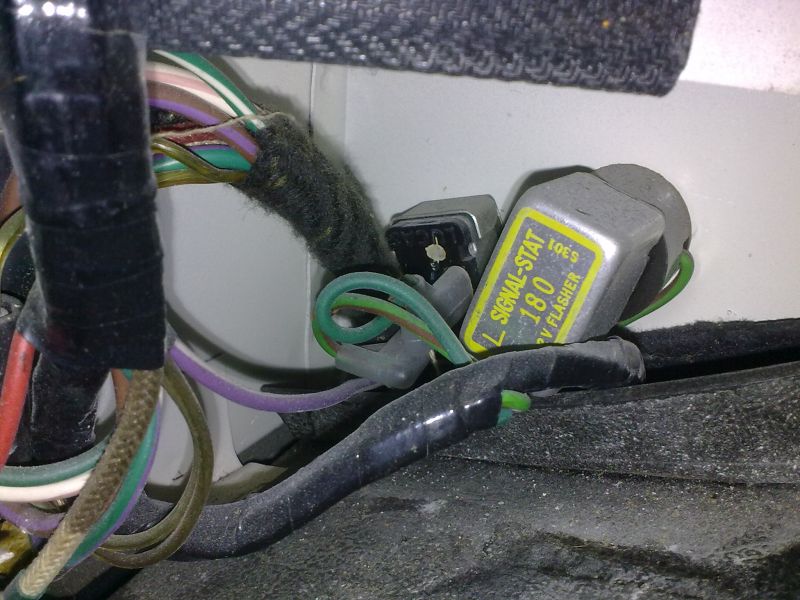

Have a 71 series 3 1S20008. Trying to locate the location of the turn signal flasher. This is a left hand car with air. Sounds like it’s behind or below the cubby box.

Hi Chuck,
You are on the right track.
