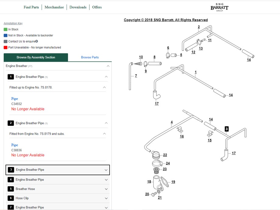

By the balance pipes do you mean the breather pipes from each carburettor C34924, C34932 etc to the engine, or do you mean the pipe from the induction manifolds, C34637, which is not fitted on mine.

Hi Marcus,
I had a very quick look at C34924 in the catalogue, but didn't find it - I know it will be there but I gave up after a minute of too as I was too lazy...!
Actually, I gave up because the real answer is that you need to look for any pipe/hose/joint which could potentially allow air into the inlet or carburetors but which is after the point at which fuel is injected into the carburetor throat. Thus anything after the needle (including the pivot points of the throttles) onward. I counted potential leak points (joints) and gave up counting when I reached nearly 50 and that was not including possible failure points, including the vacuum unit diaphragm. ANY pipe, the part numbers and combinations vary considerably with year and market of original sale of the car, can give leaks and I found this given away when, in the case of hoses joined to pipes, there was a small amount of oil which had got between the hose and the pipe (or tube) even though the hose clamp was tight. If oil could creep down these joints, then air could also get in. Some were looser than others but I used a very small amount of RTV between each. I also removed inlet manifolds and carburetors and used new gaskets and used very small amounts of RTV here too. Be very careful not to use too much as it will ooze out and may end up in the engine, which may or may not cause a problem depending on exactly where it finishes up.
Results were a definite improvement despite the care I took originally, although it has to be said I also found the torn diaphragm in the vacuum unit too. Mind you, the slight hesitation I had experienced was there more or less from the first drive and I assume the vacuum unit did at least seal at first, until the tear occurred later on.

Part C24934 is one of the "horseshoe" shaped pipes (this one with a long extraction) that connected two adjacent carbs and is then subsequently connected to the other pair. Part #1 on attached diagram.
I was unsuccessful in finding the special part number and had to open and scan the proper diagram
