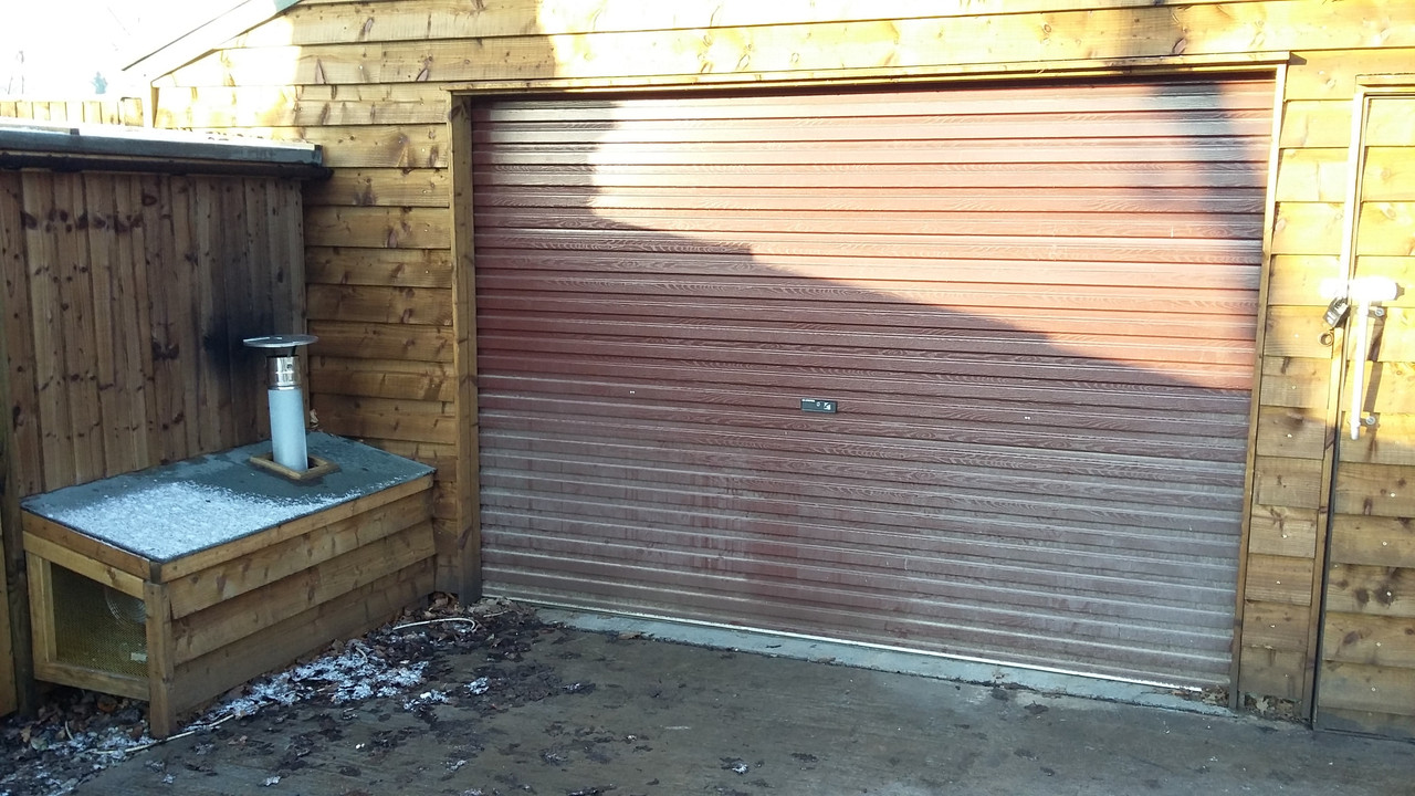

Too cold in my workshop so decided to get a heater ...Picked this Indirect oil heater up the other day...2nd hand....small version of whats used to heat marquees....very different to the similar looking oil or lpg space heater......note the flue on top......this heater sits out side the garage and fumes go up through the flue....clean dry hot air comes out of the front......and you duct it into the workspace.....i will fit a thermostat in the workshop that connects via a plug on the heater and will switch it on/off...tried it out today and it really pushes out a huge amount of hot air...20x20 workshop up to 70f in 10 mins....2nd photo shows how a mate has boxed his in.....will have to do this.....Steve
