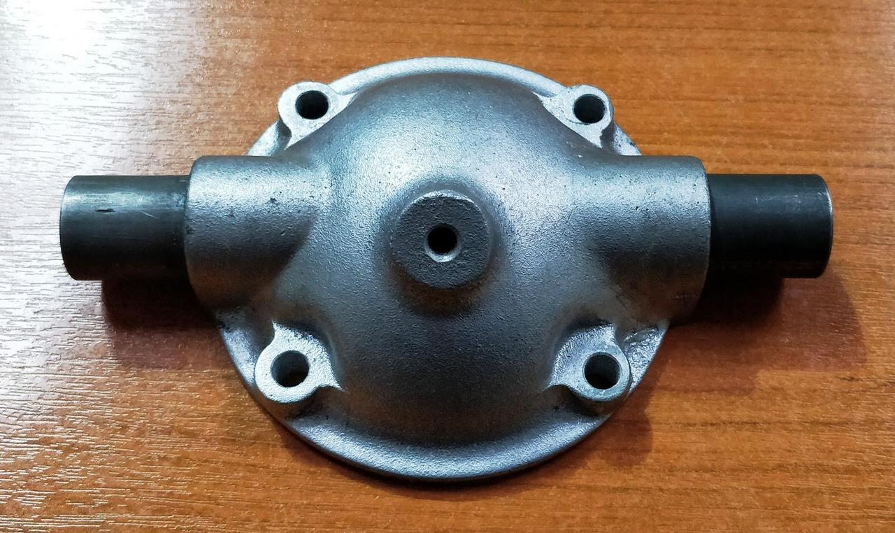

Adapter now made, anyone interested in these as a kit send me a PM.
