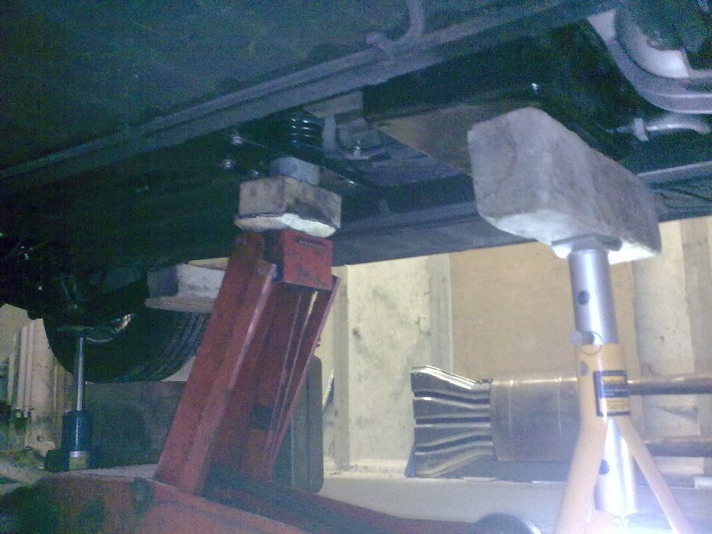

First make sure you have the correct spring for an auto, it has about 5 coils against about 3 (from memory) for the lighter weight manual.
The spring is compressed as you raise the mounting plate up against the body. Use a stout hollow tube to allow the gearbox mounted stud to progressively pass through the plate. Bolt the mounting plate to the body, remove the jack and fit the rest of the mount.
Hope this helps,
Bob

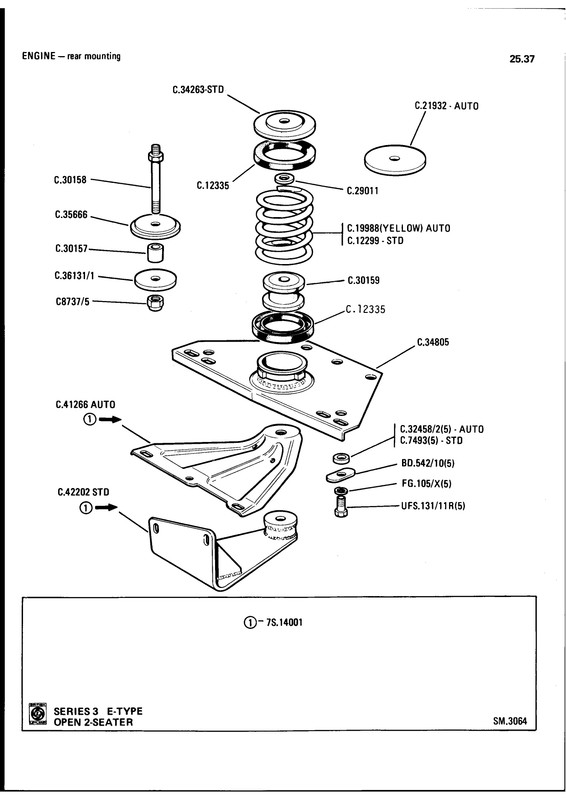

Are you sure this is correct?
Like a lot of others I'm having trouble with this item.
I cannot work out the sequence in which this is assembled.
The mounting bush has been pushed into the support bracket - Correct
If one temporarily ignores the 2 spring seats and the spring itself (mine's a manual) I'm trying to work out the sequence of parts that go on the stud.
Working from the top down (according to the parts catalogue) it starts with
special washer, with rounded edges (C29011) (purpose unknown)
Mounting lower support washer (C35666)
One spacer (C30157) (Although I have 2)
Mounting bush (C30159)
Washer (C36131/1) No longer available.
Half nut
Basically this goes together but it means the spacer can float up & down inside the rubber mounting. (there's a 2mm clearance between the rummer mounting hole and the spacer o/d
If 2 spacers are fitted then the rubber mounting can move up & down on the stud as the combination of 2 spacers is longer than the thickness of the rubber mounting.
So which version is correct or are neither of them ?
I have seen a version that has the rounded washer between the two spacers. This will surely wear the inside of the rubber in no time flat.
:helpsos:

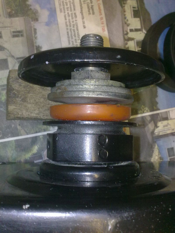

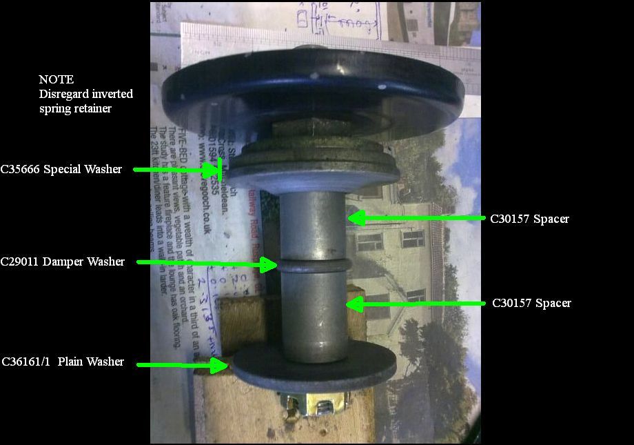

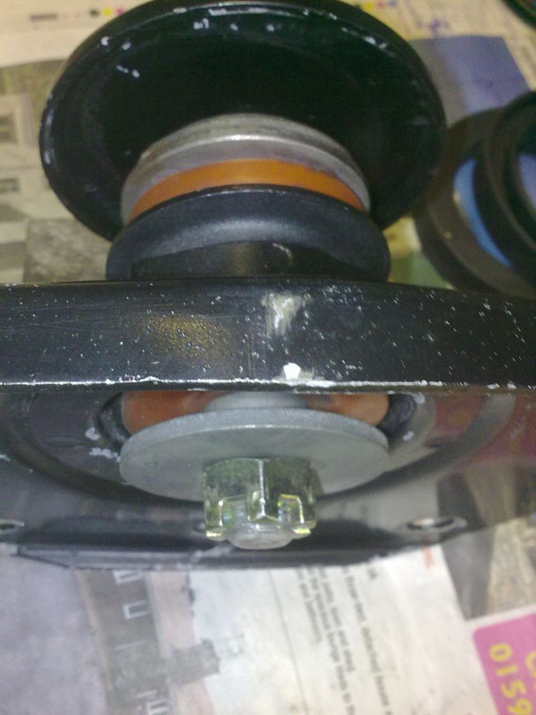

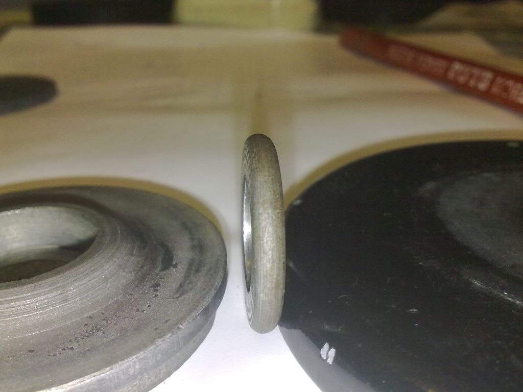

This is the assembly with C29011,the damper washer, shown sandwiched between the two spacers C30157.
The parts book illustration omits one of the spacers whereas, as you have found, in reality the design uses two.
The damper washer is designed to move within the rubber bush, that is why it has a radiused edge and also why the spacers are smaller in diameter than the bore of the bush.
The damper washer is an interference fit in the bush (ignore the fact this is a polybush) and as the name suggests damps the vertical motion.

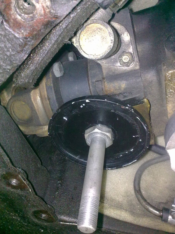

Without the spring, the assembly looks like this with clearance between the bottom of the rubber bush and the lower washer to allow vertical motion. (Ignore the castellated nut, it should be a Nyloc half nut).
Hope this clarifies,

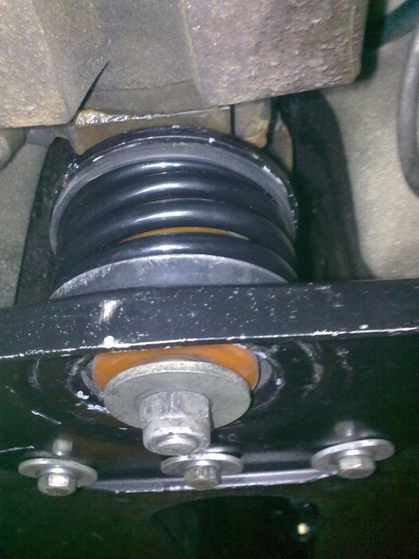

I agree with the series of pictures posted by Bob, but these and others I have seen completely miss out part number C41266 the plate with 3 bolts to the rear of the gearbox sump to the bottom of the mounting bolt! I assume it just gets bolted below the big washer C36141/1, but strangely it is nowhere to be seen in the pictures!
Bob.
Posts: 412
#10 Re: Auto trans rear engine mount
Post by Bob. » Wed Oct 25, 2023 6:38 pm
Hi ?,
Not so strange really as this reinforcing plate was only introduced fairly late in S3 production and I don't have one. As per your image from the PM, it was only introduced from engine number 7S14001 which means August/Sept 1973, so most S3s don't have one. This rather poor image shows C41266 fitted.
Bob
