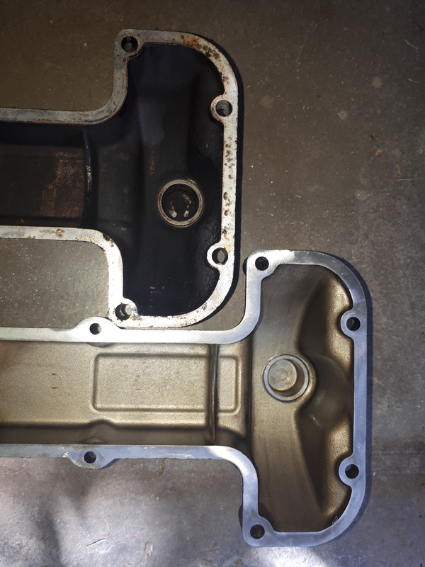

Post by MarekH » Thu May 21, 2020 2:30 pm
Dear Colin,
I've had a look at the Vialle system you propose to use and it does not deliver what you are asking of it. Like almost all lpg systems, it is a piggy-back system which starts by intercepting the fuel injection signals of a petrol based ECU and then reinterprets them for the second fuel type. This means you'll have to build up and instal a running petrol fuel injection system first. Furthermore, like all piggy-back systems, it does nothing to take advantage of the high resistance to knock that the higher octane fuel has, so you'd always be running the same old ignition system, several degrees more retarded than you need to, unless you go to the sophistication of adaptive knock related timing for petrol.
Quite a lot of the text in the technical document is somewhat out of date (their patent dates back to 1993), in the fact that it is not comparing the Vialle system with current state of the art lpg systems, but assuming (wrongly) that more primitive mixer systems are the benchmark, incapable of accurately metering the required gas. It also anticipates starting on petrol and switching over subsequently.
A further complication is that until very recently, no one has ever gone to the trouble of fully supporting twelve cylinder sequential injection for ANY affordable aftermarket ECU, let alone a piggy-back ECU, so the system will only ever be implemented as a batch fired 6 cylinder at best, or you buy two lots of front end components. (The Lucas 16CU which Roger Bywater fits is just a four cylinder system with three injectors batched per output.) I doubt the Vialle system supports more than 8 cylinders - there's no market for it.
Keihin also make CNG injectors, but I don't hear much about them. There is a reason why CNG has never really caught on. Aside from the intercooler effect, it has nothing to offer that regular lpg doesn't and that is a much more developed and mature market.
The only way to do this as a stand alone system is to go the Megasquirt (or other new-ish aftermarket ECU) route. If you go that route, it's be a whole lot simpler just copying something that already works.
Engine November 2011.jpg (190.84 KiB) Viewed 15485 times

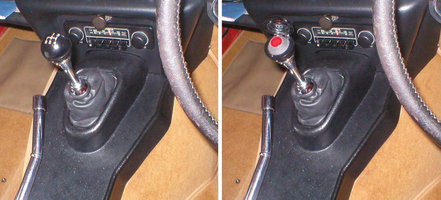

P.S. Barry:- it doubles the range of the car, delivers more torque, more power, has full modern diagnostics and runs at up to 40mpg in cash terms. And just for you, it comes with this interesting little extra......(Mr Bond)
troublesome passenger switch.jpg (214.6 KiB) Viewed 15485 times
