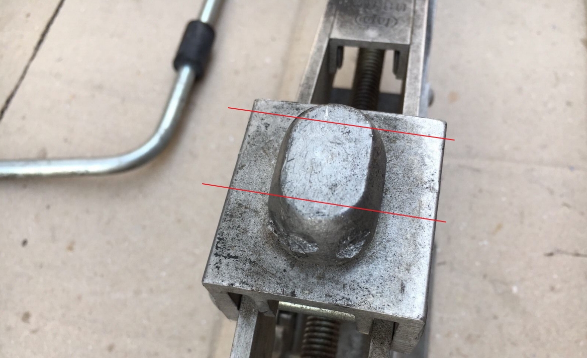

Buying one of the 944 jacks.
Is the purpose of filing the oblong lug to fit the factory jacking points?
Layne
Car #876005, 62 OTS
Posts: 15187
#43 Re: Car jacking
Post by Heuer » Mon Nov 02, 2020 11:16 am
Yes. The 'foot' of the jack is elongated and the rounded ends need to be filed down to fit the jacking 'shoe' on the car. As the Porsche jack is made of aluminium it is a simple job to do.

Post by mtnjag » Sun Nov 08, 2020 5:30 pm
Very nice jack. squared it off and it fits sill jacking points perfect if I MUST use them at some time. Gonna pickup a rubber puck and drop a locating hole in it to use with the jack.
