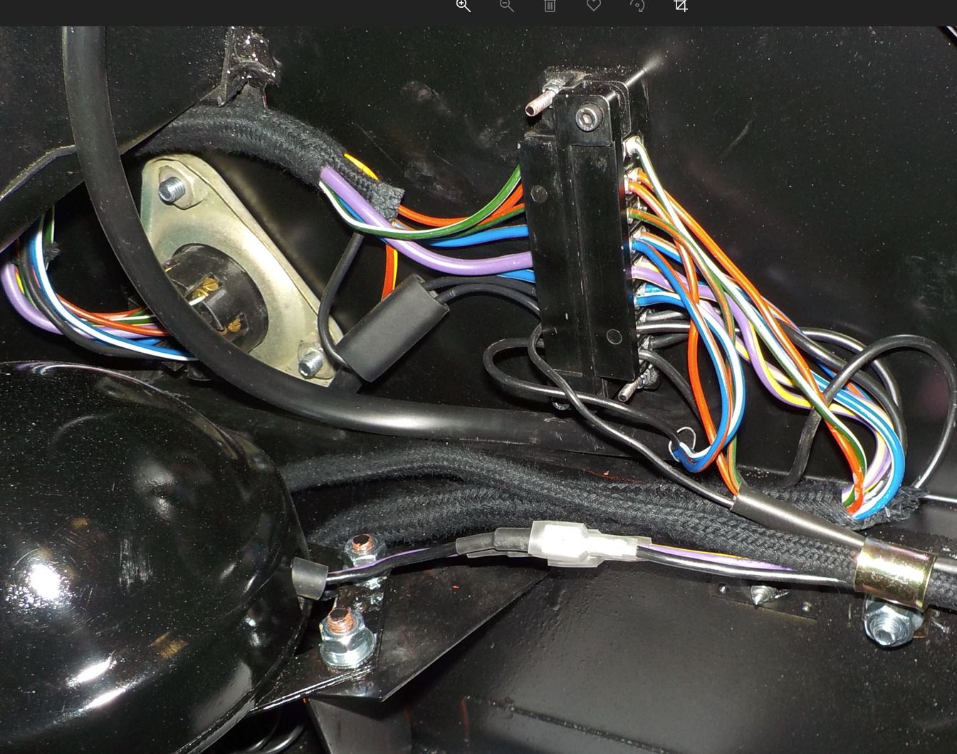

Hi Chaps
I am finalising the electrical work on my 3.8 FHC and have a stray earth that doesn't appear to have an obvious location. It is exiting the dashboard loom adjacent to the indicator/headlamp flasher switch wiring. Picture attached.
There are no obvious attachment points that I can see.
Any advice appreciated.
TIA
Tony

Maybe it is an earth to the speedo and fits on the speedo retaining screws. Someone with more knowledge should be along soon.

:yeahthat: I think that the ringlet on the end is the clue

Thanks, I thought that maybe the ring tag was to attach under the bolt head for the steering column up/down adjuster. The hole seems a bit big to go under the speedo clamp screw.
I'll sort something but, from my particular engineering background, I am very precious about earth bonding.

Its an earth that should be earthing something not a wire that needs earthing.....also note it has spade connectors further up the wire....so typical of an earth loop ....so you need a home for both connectors....Steve

I sorted it but whether it is factory correct is a different question.
There was no obvious earth on the panel other than via the mechanical fixings. This is something that I despise because there always should be a 'proper' earth connection using a wire and good electrical connectors.
I followed Christopher's suggestion of connecting the ring tag to one of the speedometer mounting points and then created a new heavy earth cable with a ring tag under one of the 5/16" screws fixing the steering column support. I then connected this to the instrument panel and to the 1/4" blade connector.
Everything is earthed with good earth continuity to frame so I'll leave it at that.

I had the same question when installing a new wiring loom to my 3.8. I figured it should attach to a tach fixing screw to give a proper earth for the clock which draws such minute current that any resistance in the dash fittings would render it inoperable.
