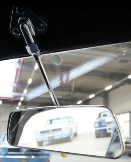

caveman
Posts: 711
#5 Re: windscreen trim panel fixing
Post by caveman » Fri Jun 21, 2024 3:21 pm
Like this?

chris45
Posts: 32
Joined: Wed Aug 23, 2017 6:10 pm
Location: London
#6 Re: windscreen trim panel fixing
Post by chris45 » Fri Jun 21, 2024 3:37 pm
Like this?
Yes, spot on!
