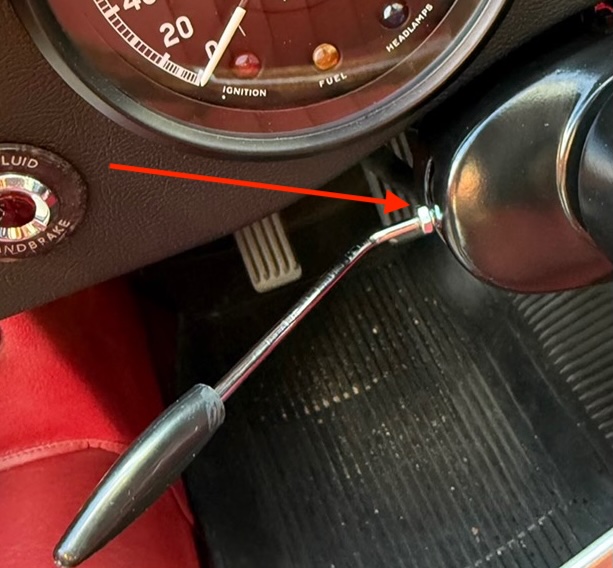

I have experienced exactly the same problem as Andrew with the C21710 aftermarket indicator switch. It is simply cheap crap. I also started with superglue, but that didn't work. Then I made the thread longer so there was room for a lock nut, as seen in the photo. It worked for 14 days, then it came loose again. Finally, I also gave it some JB Weld epoxy glue. It worked! But honestly, you pay more than €220 for such crap. I have heard that you can use the newer model C25254 as a replacement for C21710 on older cars also. There is probably a surplus wire, but it should be of significantly better quality.
