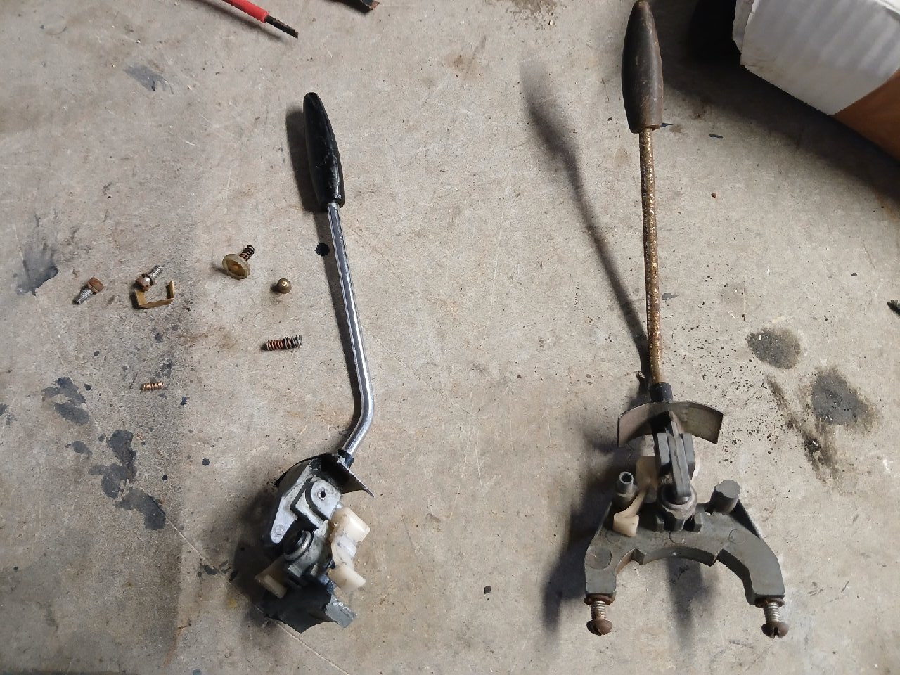

Mine is on the right, a friend gave me the one on the left. I think I can move the white plastic thing from left to right, and then use it. But when I started taking the one on the left apart, springs etc. jumped out.
Does anybody have instructions or a drawing of this, to help me get one working turn signal mechnism?

#2 Re: Turn signal mechanism jigsaw puzzle
Post by mgcjag » Tue Mar 24, 2026 10:14 am
If you search indicator switch hete on the forum there are a huge number of posts and photos etc....Steve

#3 Re: Turn signal mechanism jigsaw puzzle
Post by Iansparky » Tue Mar 24, 2026 5:48 pm
If you google servicing the e type series 1 turn signal switch, there is an excellent artical on yumpu that describes the process of stripping down and rebuilding, there are a lot of pop up adverts on the site but you can work around them, I did mine, replaced the white plastic bit and the chrome lever, the great thing is I retained my original switch that was date stamped Jan 65 by lucas.

#5 Re: Turn signal mechanism jigsaw puzzle
Post by No Quarter » Tue Mar 24, 2026 8:24 pm
PierreW, I didn't find it. I got an unused mechanism, which I plan to take it from.

#6 Re: Turn signal mechanism jigsaw puzzle
Post by No Quarter » Tue Mar 24, 2026 8:28 pm
Thanks Iansparky, just what I needed. never heard of Yumpu before.

#10 Re: Turn signal mechanism jigsaw puzzle
Post by No Quarter » Wed Mar 25, 2026 8:13 am
Thanks, now built two defect ones into one functioning one. Quite lucky, not a single part was missing on both, so it was doable :bigrin:
