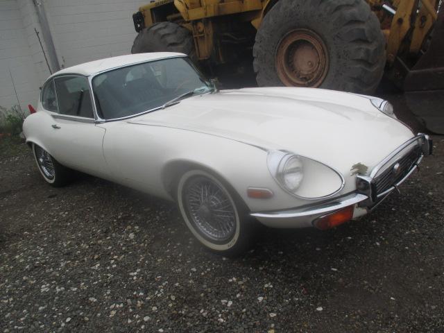

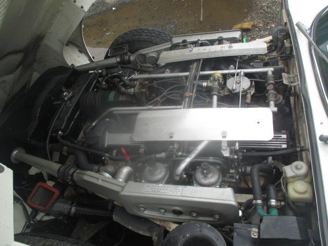

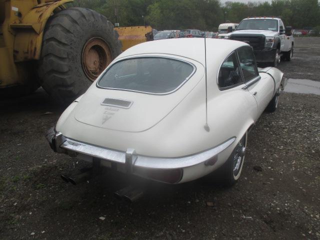

Hi all,
I am buying this Jaguar E-Type and I am not too familiar with how these vehicles are supposed to look. This Jaguar I am looking at is a 1972 and I was wondering by the pictures does it look like the engine that these Jaguars are equipped from the factory? Also, what do you think is up with the quad exhaust?
Just by the looks of it and knowing that it runs how much do you think I should buy it?
Thank you
Thank you

On the face of it, it looks quite original under-bonnet for a S3 - perhaps a more trained S3 person could confirm? The quad exhaust is non-standard but there were two types of exhaust offered on the S3 E-Type. The distinctive "fantail" exhaust and a two-pipe version (Apologies, I'm not massively in the know with the S3!) I would imagine it's a case of finding a new exhaust set. Looks like a lovely car however! What happened to the bonnet? :/

Hi....very basicaly there are 3 types of e type, known as a series 1, 2 ,3 the first two have the smaller 6 cylinder endins with tripple carbs, a fairly straightforward engine to work on....the 3rd type that you show has the v12 engine with 4 carbs basically twice as big and more complex, they are usually cheaper to purchase...the exhaust shown, 2 sets of twin pipes is non standard....re price....you need to search similar cars for sale in the US ans take into acount condition..search for V12 e type for sale

if i understood it right, the first two years ( 1971 and 1972) the Series III with V12 engine received this Quattro-exhaust tip.
1973 and 1974, the two last years had a dúplex exhaust tip.
The engine looks clean and o.k.

OK, thanks all for the information. So the engine looks like the original engine it's supposed to have? not some kind of modern V12 engine pulled from like a 1990s Jaguar XJS?
#7 Re: Is this Jag the real deal?
All looks to original and correct.
