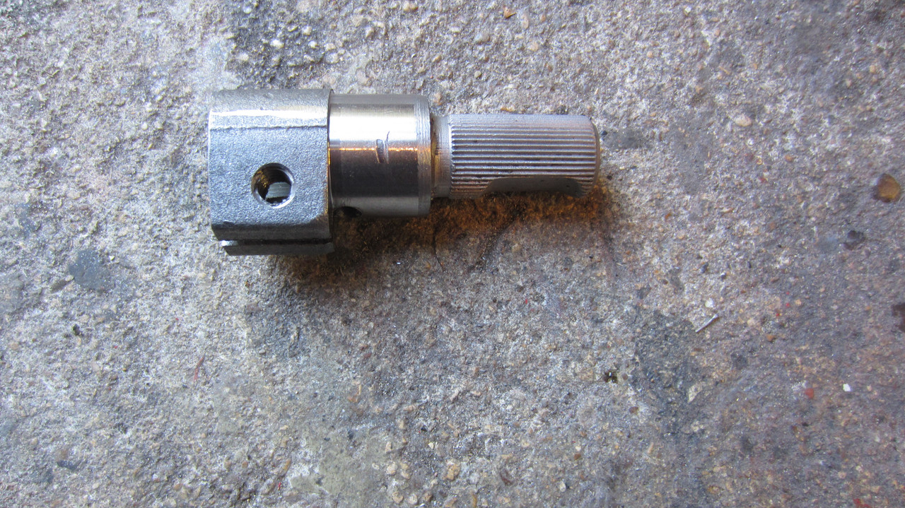

The base unit is a LHD column (motor on top pointing to the right) from ether a 2000-2004ish Vauxhall Agila or from a Suzuki Ignis, same years. It is important to get one together with motor and ECU as they tend to differ, even with the same model and also important to make sure it has an external torque sensor.
I made up my own brackets and all adaptations. The spline at the bottom is 36 tooth x 17mm and the Jaguar is I think 48 tooth x 3/4 “, so an adapter is necessary. I bought a GPS controller, but it is also possible to get a manual one.
Happy to provide further information if you need it.
( tried to upload some more photos, but Postimages won’t let me?)

Post by paulsco » Mon Nov 20, 2023 2:34 pm
A few photos:
