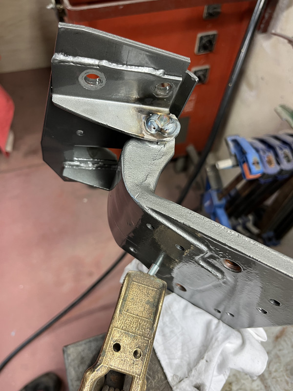

Okay, so I have now done one hinge and this is what I learned.

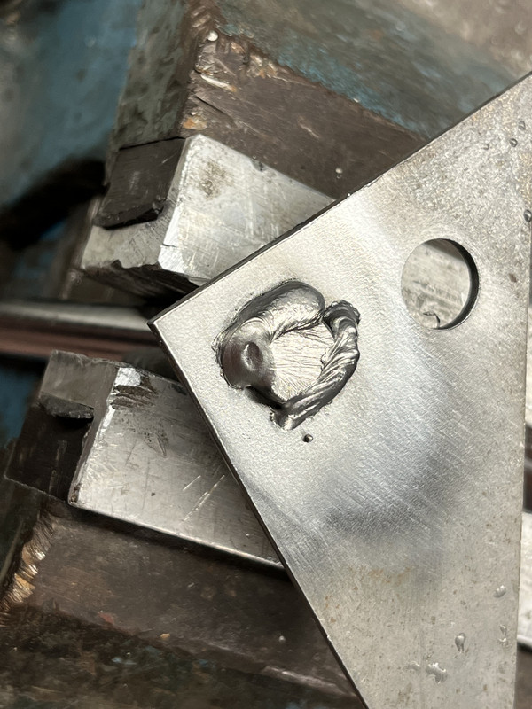

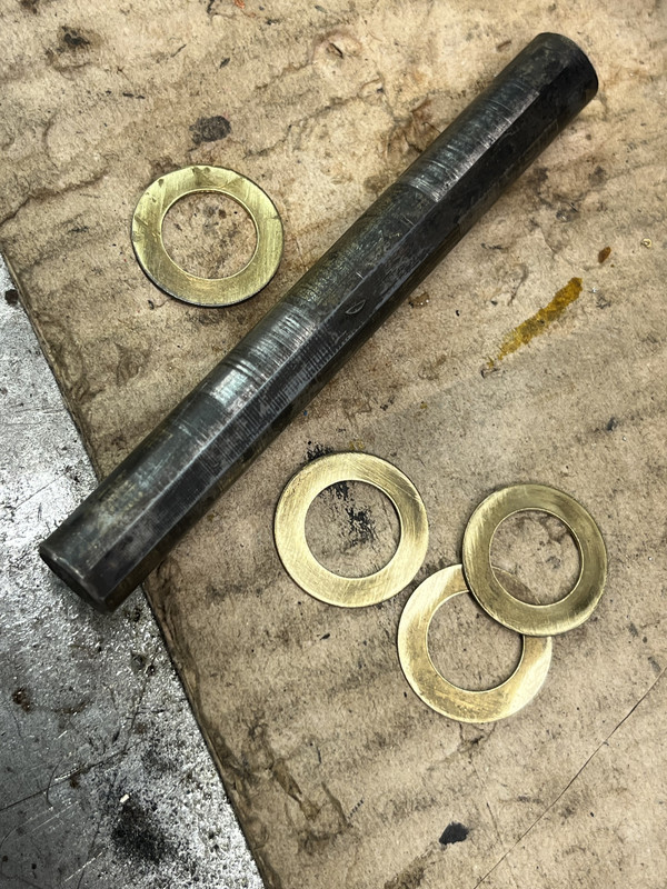

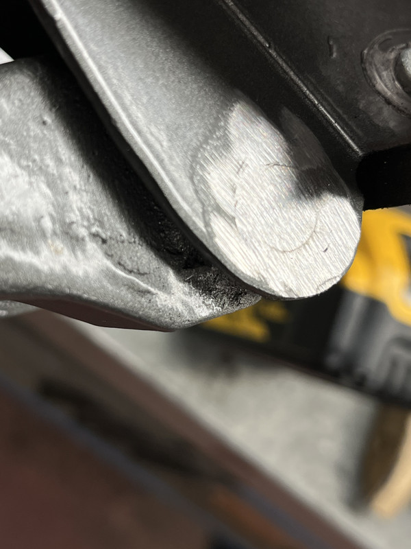

The ground-bar I used, STUB, otherwise known - I read - as 100C6 or AISI 52100, actually welds perfectly for this application ; the thermal shock might do something to its hardness, although I would hazard that the quench rate will be so low as to be irrelevant.
(It's only called silver-steel because of its appearance).
What's nice about it is the ground precision of the 12mm OD, which when used with a machine-reamer gave me a a buttery-perfect adjustment of the pin in the bushes.

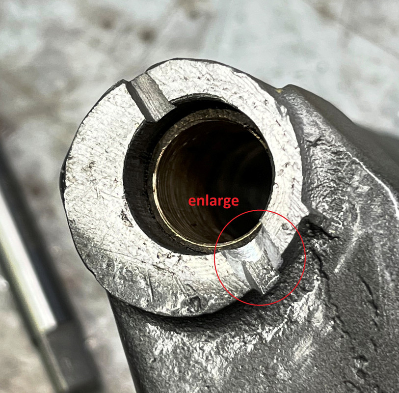

I've never read of this elsewhere, but both my doors actually had bronze bushes fitted ; they look 100pc original, and as the only work that was ever done on this car (late eighties) was done by someone who didn't go in for in-depth, genuine detailed restoration ........... he was an accountant ...... I'm inclined to think this might have been the way it was in 1962 ?
Removing the old welds showed no hint of previous meddling.
The pin even had a flat on it to facilitate the lubrication.
There's a top bush over 1/3 of the height, and a second covering the lower third, both sitting in shouldered 14mm ID recesses such that the centre 1/3 is more like 12mm.
What's nice is this gives a little volume at the top for oil-injection -
- I think it's even worth easing out the groove a little here to make lubrication easier.

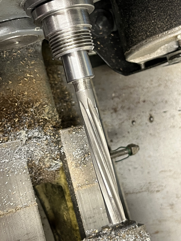

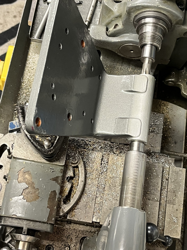

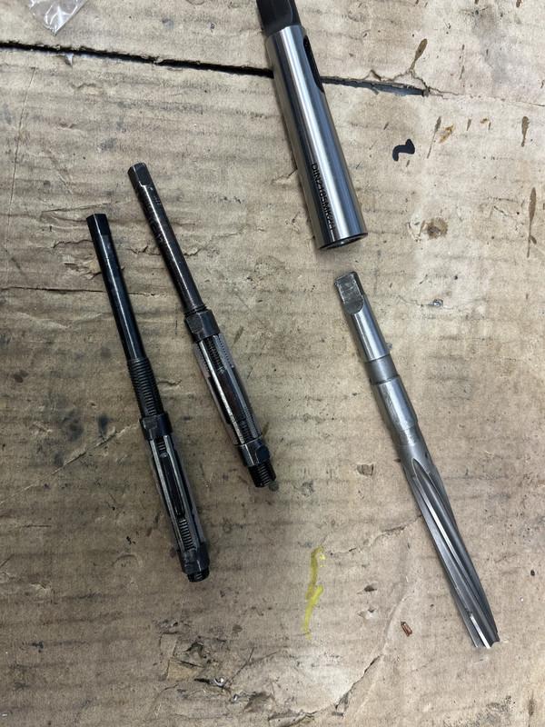

I'm ashamed to say that I used an approach for the reaming that would have got me thrown out of the metalwork class, so make sure nobody is watching if you do this.
With a Myford 7 in back-gear (slow) and with the clutch set to a really light engagement (slip), I hand-supported the hinge on the reamer and gently fed it through by using the tail-stock as a pusher to centre the whole thing.
Starting with an 11 - 11.5, and then with a 11.5 - 12 adjustable reamer, I went through from the same direction with bigger and bigger passes, machining both bushes with each continuous pass, until I could get the machine-reamer started, at about 11.7.
Then, still from the same direction and now using the machine reamer, I was able to traverse both bushes ; actually, it had to be finished off the lathe, and by hand, as I ran out of Morse cone to grip the reamer - plus I had to grind a tad off the fattest bit of the Morse, over about 4mm of length, as it was slightly bigger than 12mm.
By going through in this way from the same side, I got an absolutely perfect fit and alignment.

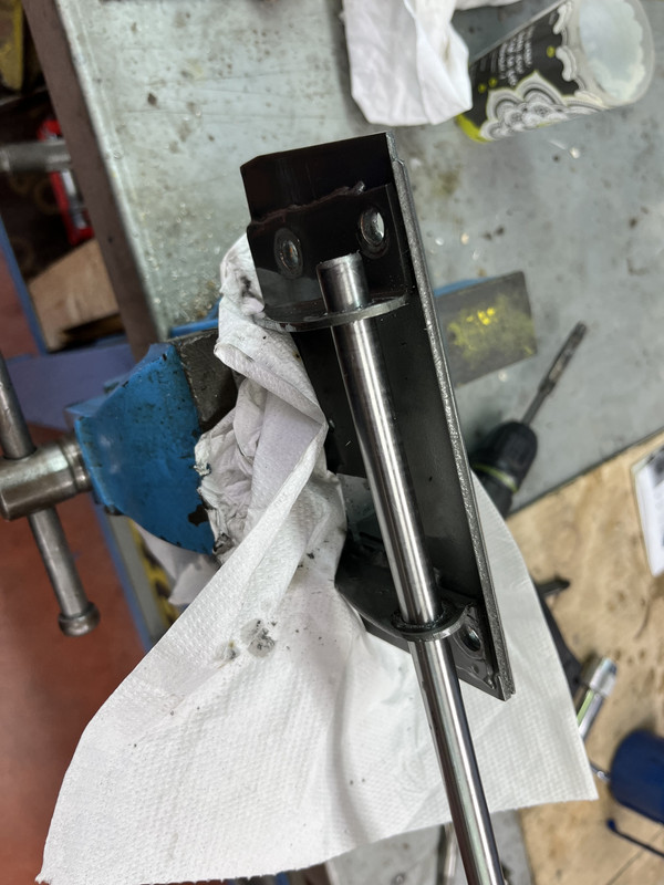

The idea that you could ever use epoxy glue to hold a 1/2" pin in place, when the head is under such shear (and even more so in a sloppy hole) and vibration, and that you can get a snug fit of your pin in a 1/2" hole that you've drilled up from 11mm (since when did doing that through 2mm steel sheet ever give you a round 1/2" hole ?) leaves me speechless.

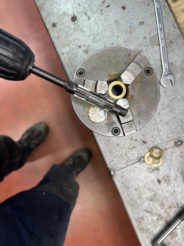

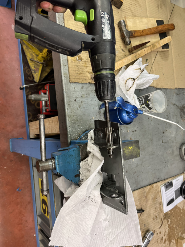

I suggest that you use the same cheap adjustable bladed reamers (Indian junk, but they work) using a small portable drill, incrementally, to ease the steel cheeks out to a snug 12mm, so you have the same quality of fit - it takes 5 minutes longer, for a result that is perfect.
Same for the brass washers - pinched in a chuck on the bench, using the same reamers.
I did a few sample welds between the silver-steel and a 2mm flange to adjust the MIG setting, and then welded it all back together.
