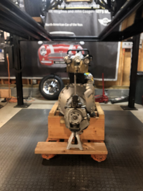

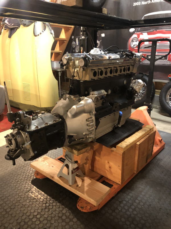

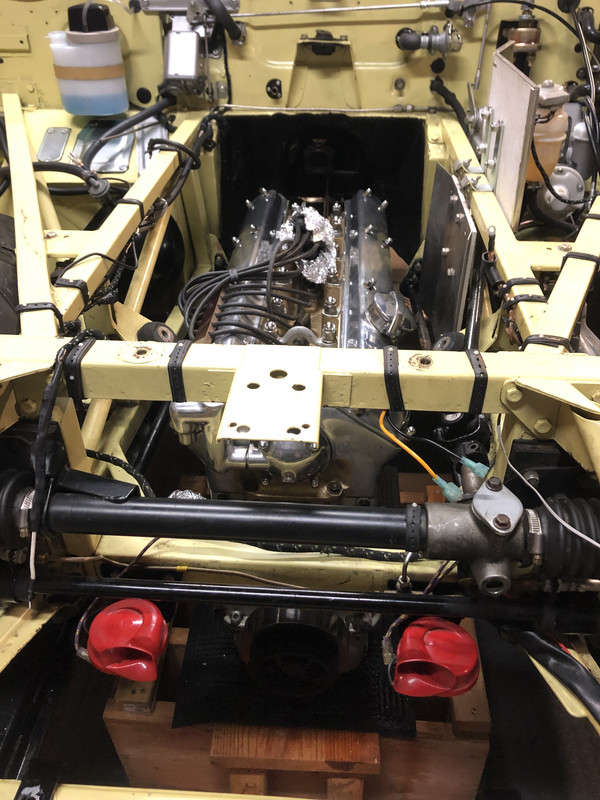

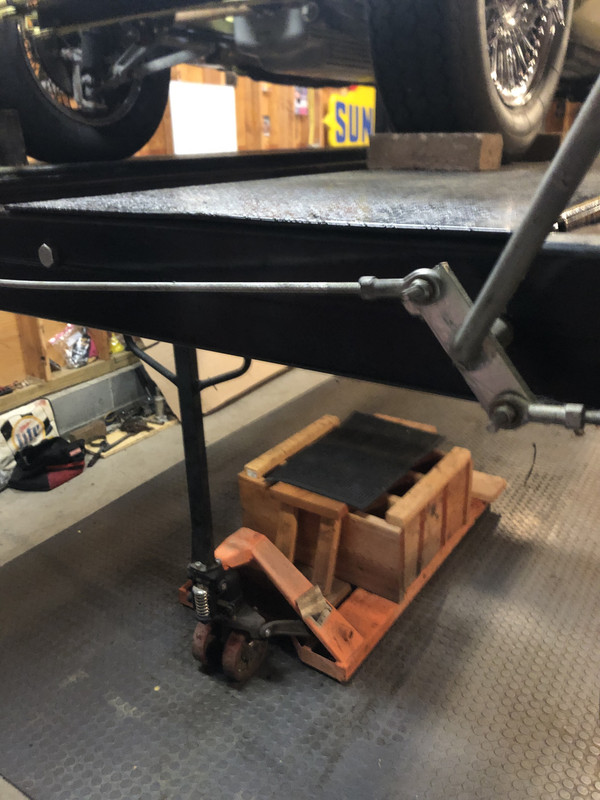

As promised…..
The pictures might be a little mixed up but the steps took less than 1/2 hour!
The palet was placed under the car, then the car lowered till the engine rested on the wood.
Then the front engine brakets removed.
Then support the transmission and take out the 5 mount plate bolts.
Lastly the firewall mount screw loosened , then raise the car and your all done!
Next removing the transmission and pulling the fly wheel
Enjoy!

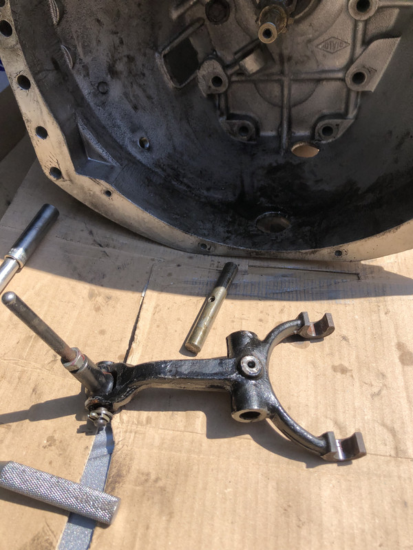

Post by gtjoey » Fri Aug 05, 2022 11:15 pm

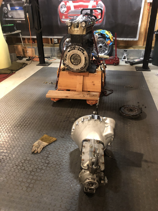

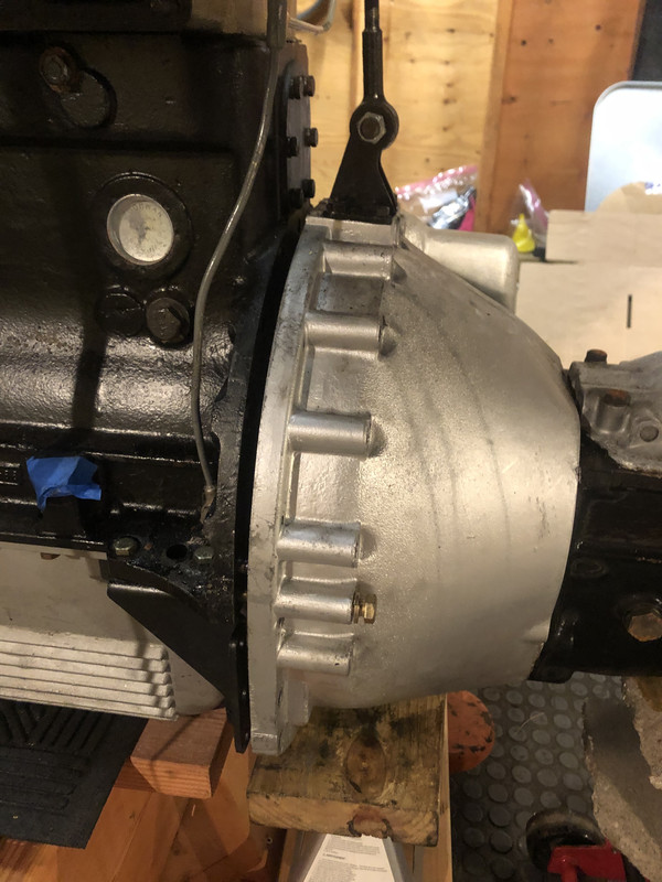

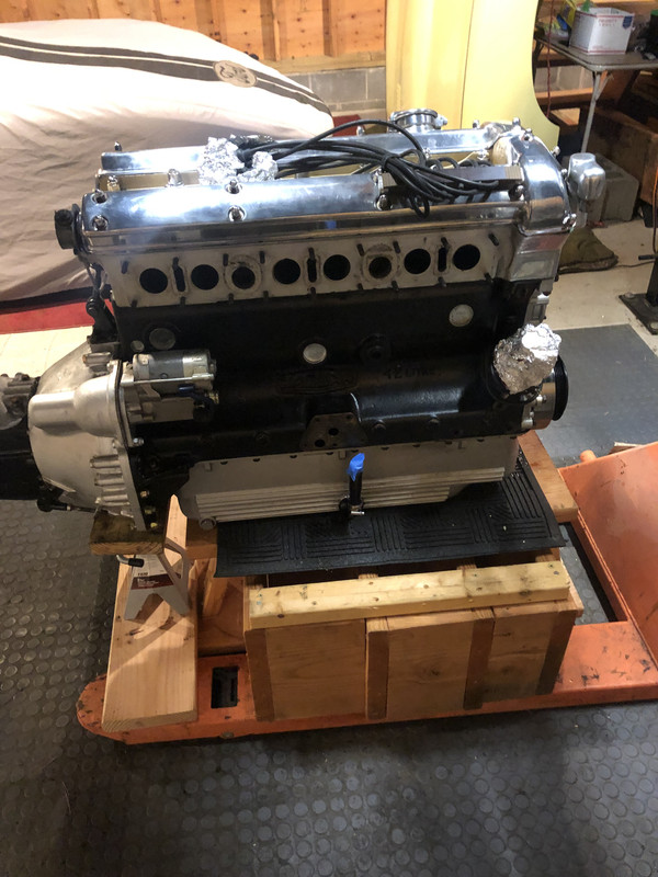

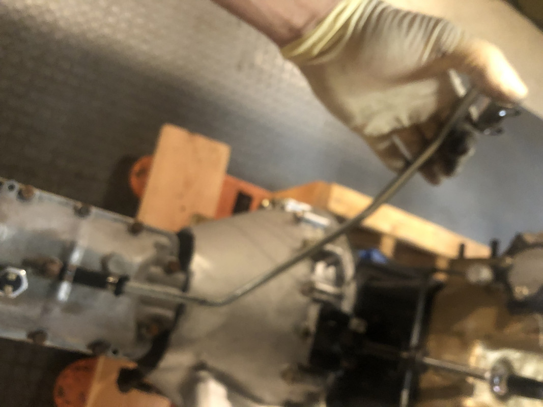

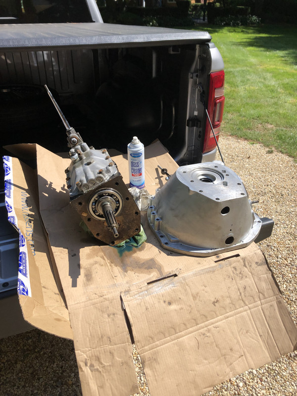

Okay
I strapped the engine down so it would not rock or tilt while removing the transmission.

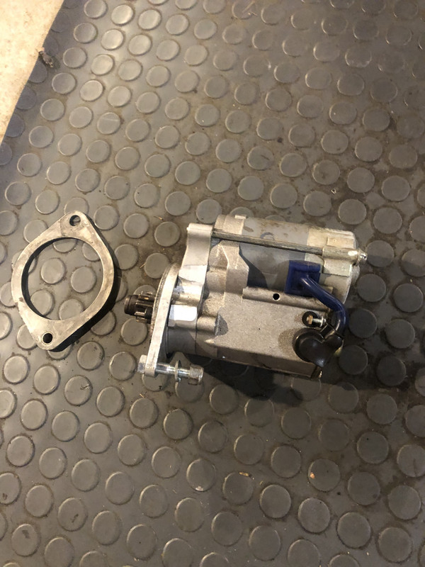

I removed the 2 bolts and the spacer plate on the starter .
I then put a support jack under the transmission taking all the bell housing bolts out except 2
Slowly wedging the bell housing away from the engine block
With another set of hands we pulled the trans back and out!
Next came the flywheel and clutch assembly.
Once that was removed the bell housing had to be taken off to be used with the guy broad box.

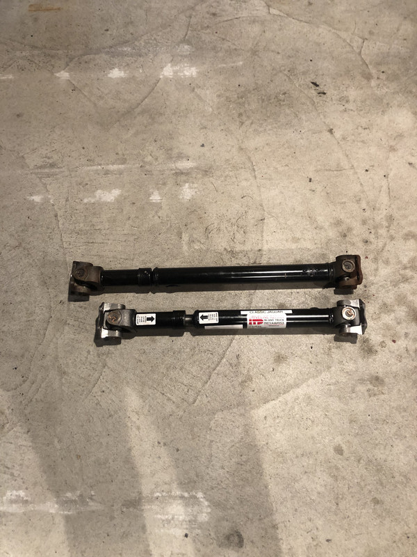

DO NOT FORGET. I then replaced the drive shaft with the new at least 3 inch shorter shaft as the tail of the trans is at least 3 inches longer!!!

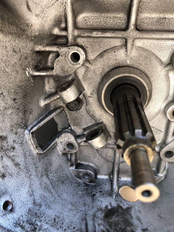

Help needed before Mondays call to a guy Broad
When I use the old bell housing
Do we need the paper gasket?
Do we use the same shaft seal?
Finally the missing bolt behind the fork
Do we thread a bolt?
I’m
Just not sure……
Another note
The clutch fork is held in with an Allen key threaded stud
To get to the last bolt you need to remove it
Just remove the Allen key stud and lock washer and nut and tap shaft through the fork .
Hope this makes sense
Lastly the old clutch , flywheel and pressure plate are off the CJ dor balance with the new clutch and transmission
Thoughts?
Gtjoey1313

gtjoey
Posts: 604
#97 Re: The 5 Speed is here……..

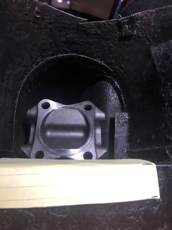

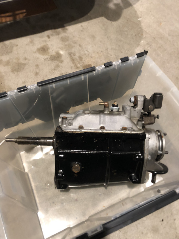

Post by gtjoey » Sat Aug 06, 2022 12:00 pm

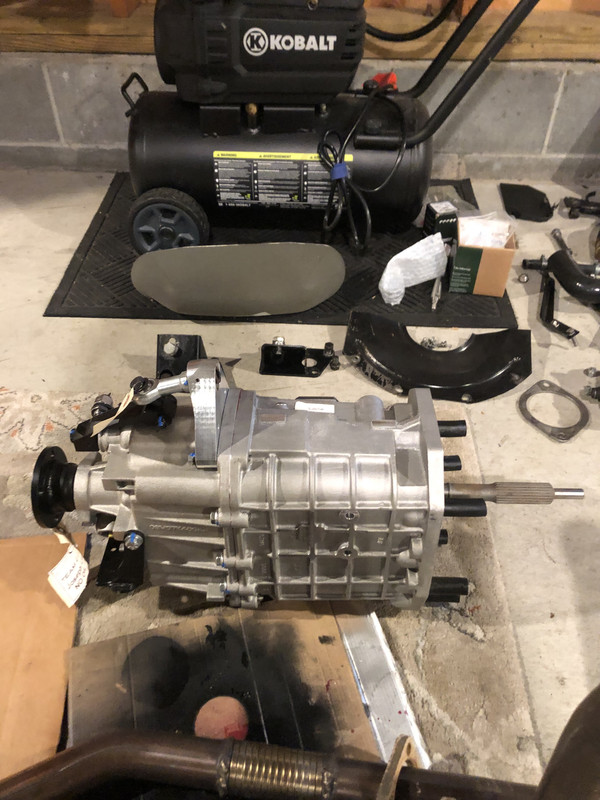

Moving on to the new box…
Before my call on Monday…….
The studs are covered for protection while shipping.
1. The eight hole is tapped did anyone put a bolt
Or blank for fork range?
2. I hope the bell housing just bolts on with no gasket
3 Going with Bob Beeres clutch bleed kit😀👍🏾
4. Using same pilot bushing
Yes Broad and CJ have been very helpful
I was just wondering before Mondays phone calls
Gtjoey1314
gtjoey
Posts: 604
#98 Re: The 5 Speed is here……..

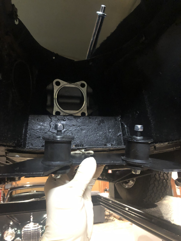

Post by gtjoey » Sat Aug 06, 2022 1:28 pm

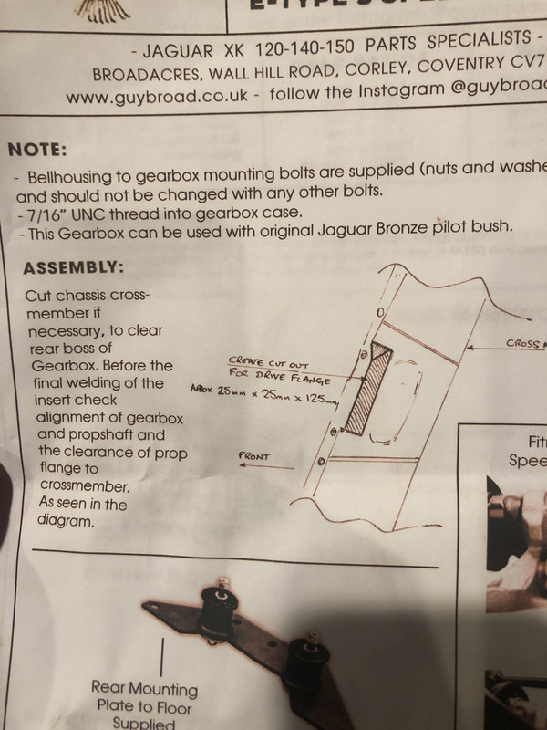

Also the call will go out if I should just massage the cross member or not before I even decide to place everything back in...
gtjoey1314

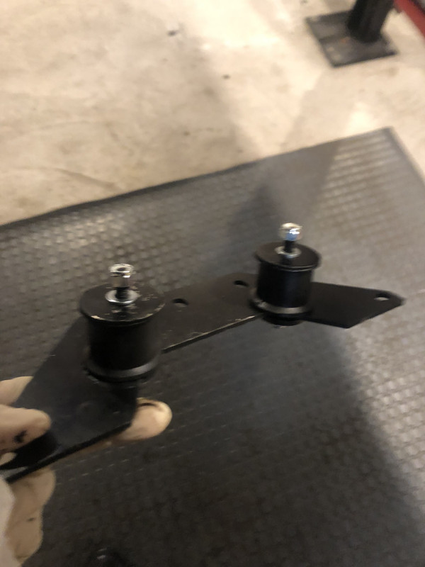

#99 Re: The 5 Speed is here……..
Post by gtjoey » Sat Aug 06, 2022 3:25 pm
While waiting for the clutch to return
And a phone call on Monday to Guy Broad
Most never cut the cross member so I made the template anyway
Anyone have ideas?
It 1 by 1 by 5 no big deal
Thoughts?
Gtjoey1314
Posts: 9251
#100 Re: The 5 Speed is here……..
Post by mgcjag » Sat Aug 06, 2022 3:36 pm
As i mentioned re info on Jag lovers.......some have just moved the engine forward slightly and no cutting was required. ....but think it may be a car by car decision as they are not all exactly the same......Steve
