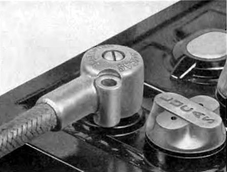

Post by Heuer » Tue Jan 05, 2016 1:35 pm
David
The Lucas 'helmet' connectors are lead alloy and are available from SNGB.
More info here: viewtopic.php?p=42758

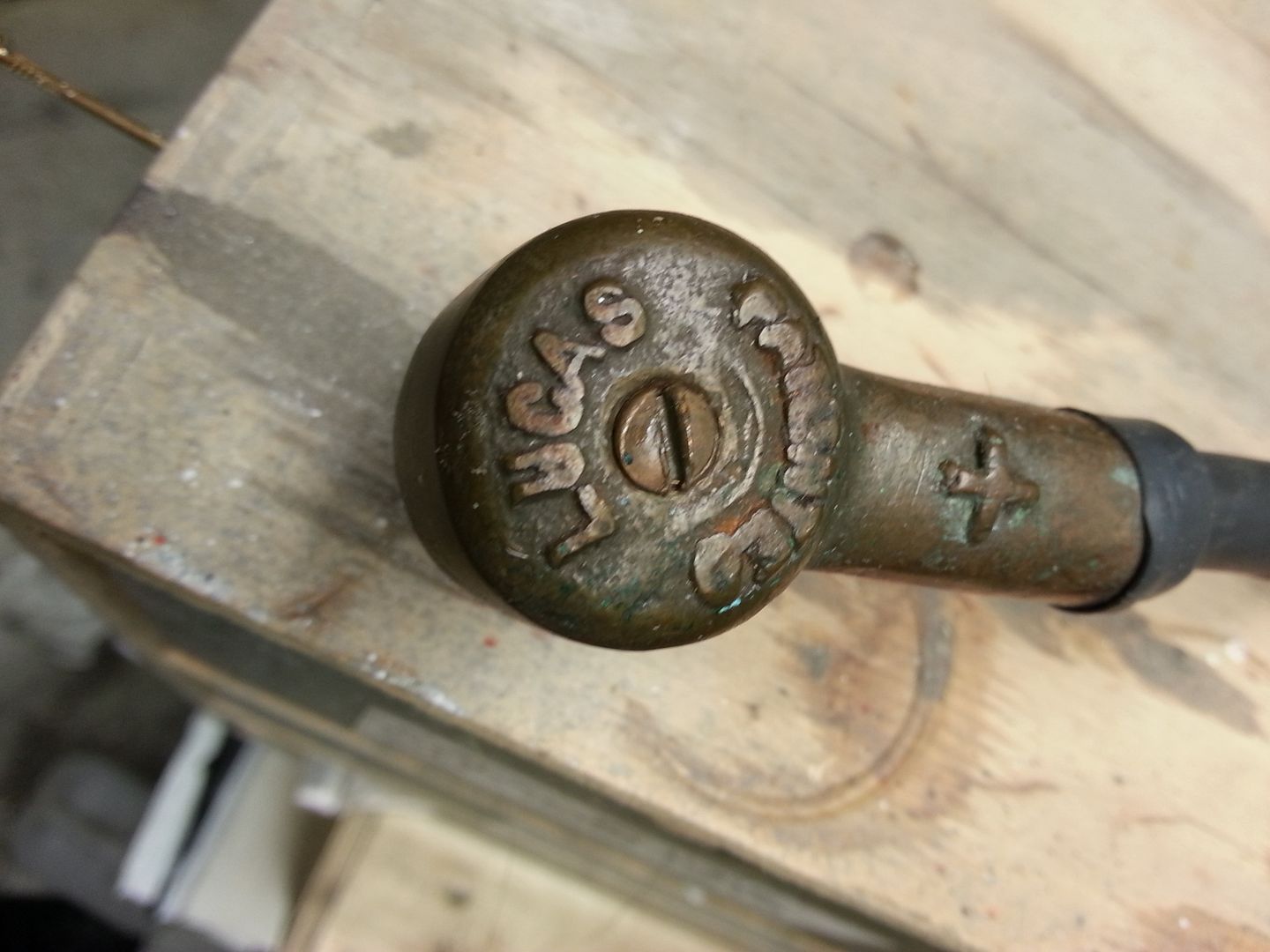

Post by David Oslo » Tue Jan 05, 2016 5:10 pm
Thanks for the picture, I have them on my car so am quite familiar with them :D On my last post I was suggesting that Andrew post a picture of his particular dilemma.
Mine are brass (or bronze) as can be seen from the dull brown finish. Underneath I've polished a bit to show the yellow metal, the green corrosion is a typical sign of brass / bronze. The lettering is a bit flattened from being hit with a hammer over the years.
On other British car forums I see references to three different materials in use, lead alloy, natural brass/bronze, lead coated brass/bronze.

Post by andrewh » Tue Jan 05, 2016 5:47 pm
Heuer wrote:David
this is what I have on my car exactly, and from SNGB. Quite simply it is a loose fit on the battery, but since I have removed the red plastic washer it has appeared to fit down a bit lower so may now hold. Its not a very good fit though to be honest. I may be forced to try another lead if this persists. thanks all though.
