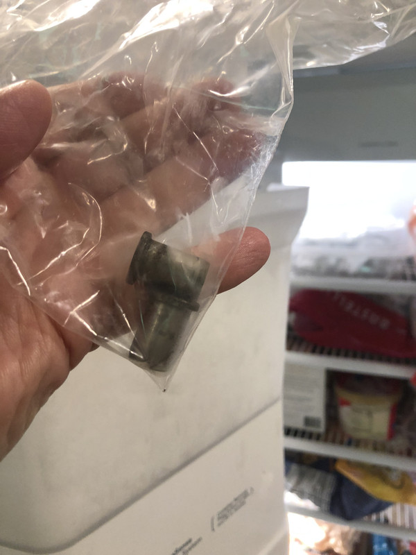

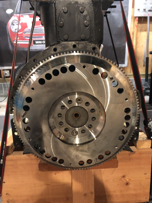

Trick from old Ferrari friend
Put alignment dowels in freezer to shrink when sliding the flywheel back
gtjoey

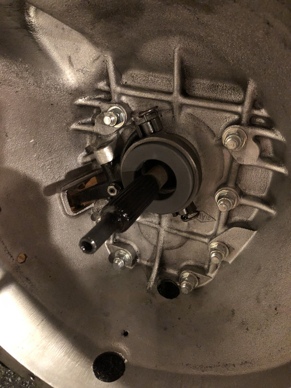

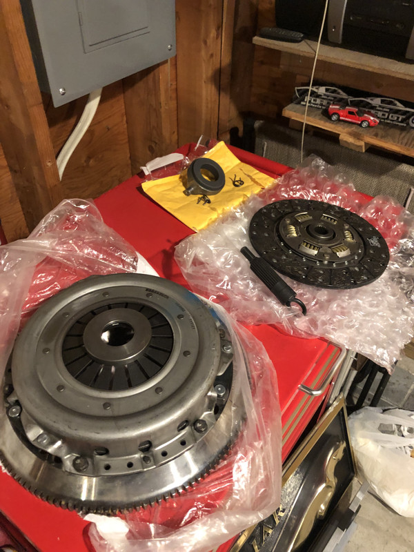

It was a late deliver so Monday we will put the clutch assembly along with the transmission!

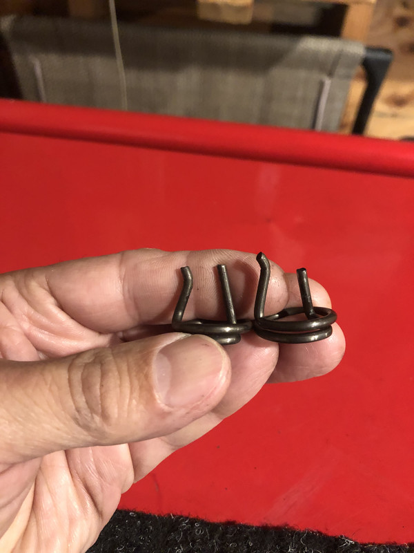

I’m putting the throw out bearing
Do you put the retaining clips like this or push them all the ways down?
I leave mine in the recess groove
What say you

Im leaving my throw out bearing clips as shown as a later series 1 4.2 has the indents to hold the clips in place.

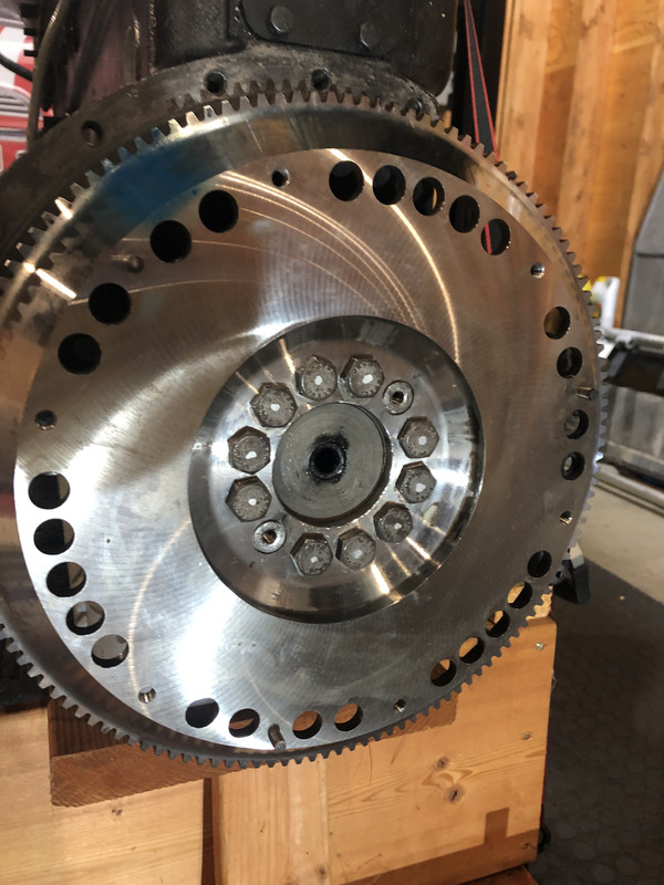

Torque flywheel bolts with dot of lock tight 67 pounds.
Notice flywheel balance with clutch, blue paint for the high point so not to turn it on installation....

First did you place the retention clips in the same spot on the throw out bearing?
Broad says my picture is the way .

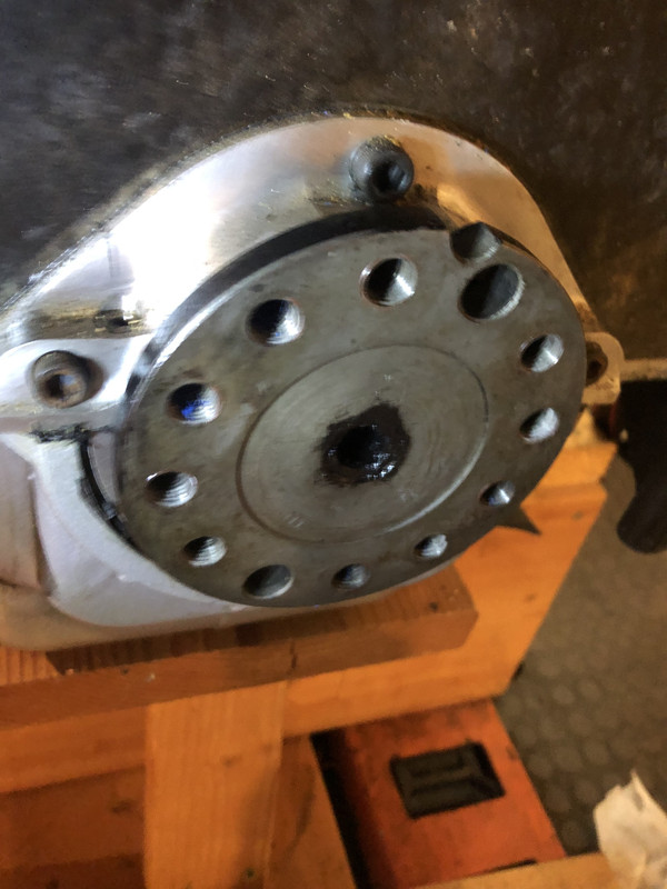

Okay
Follow along……slowly.
This is the most crucial part
Screw this up and everything has to come apart again.

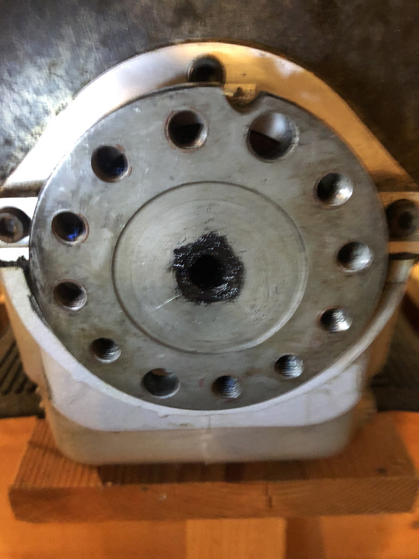

Lube the pilot bushing.
I personal use a touch of lube on the crank lip
Then place the flywheel over the crank while by eye
Lining up the holes
You can’t force. The flywheel over the hub!
Take both guide pins and slightly tape in guide holes
Slightly!!!
That should be enough to take 4 bolts and they should screw in by HAND .
If not your cocked
If you wacked the pins all the way it’s murder to pull back out to adjust.
So……
Slowly tap in the two pins as you tighten the 4 bolts slowly so it sucks in the flywheel even!
Once the flywheel is almost seated
Put in all the bolts and snug tighten without the locking plate
Now you tap the two guide pins till flush
Now your seated
Then back out every bolt
Lock Tite all bolts
Flush pins….
Then locking plate
Then all bolts
Torque to 67 pounds
Got it so far?
Gtjoey
Don’t forget the first 4 bolts to seat the flywheel are cross cross or opposite sides spread out

Well. Well. Well

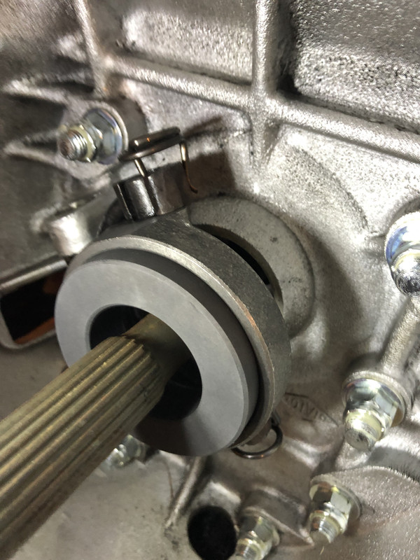

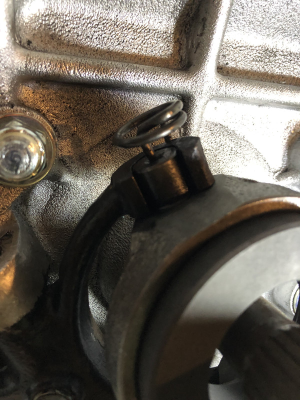

I was not happy with the spring clips holding the throw out bearing
They seat in a center hole and a bevel behind the fork
There is only 1mm between the t/o and pressure plate so the springs are really back up support to the fork arm.
Well guess what , the repro clips are a good 3/8 th
SHORTER! Than my old ones on the pin length!
Look closely
What made me look at the old ones…..GOD only knows
So old clips went in and it’s as secure as can be
Triple check everything!!!
Note graphite black grease on the input shaft
Note left clip in picture is the good one
The straight shaft is longer
And
The indent side is SHORTER!!!!
Locks in tighter and lower and more shaft down the middle of the bearing
Make sense?
