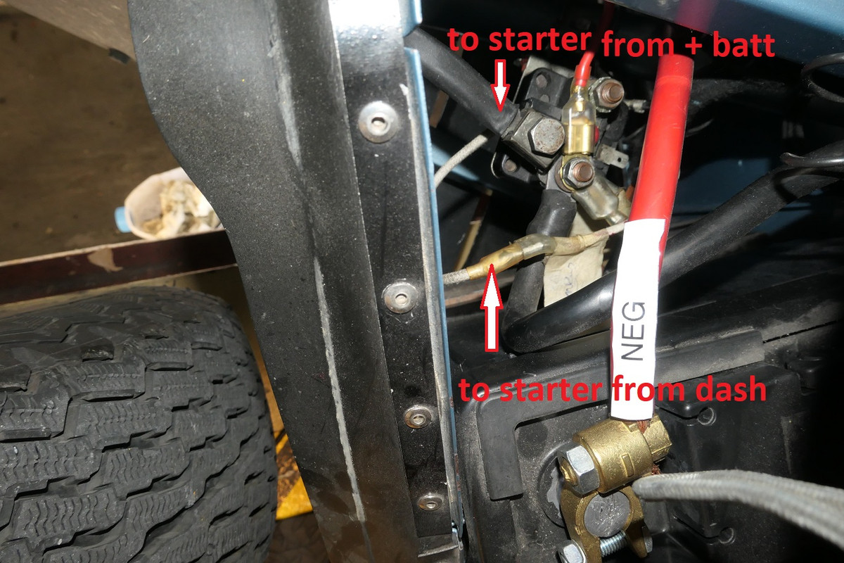

I have since some days a intermittent issue when i start the engine :
I hear a "click" when i push the starter button at the dash once or until 8 trys and then the starter works engage....
I have checked at the connector thinking it was something loosed but found nothing .
What can be the culprit ? Starter relay ?

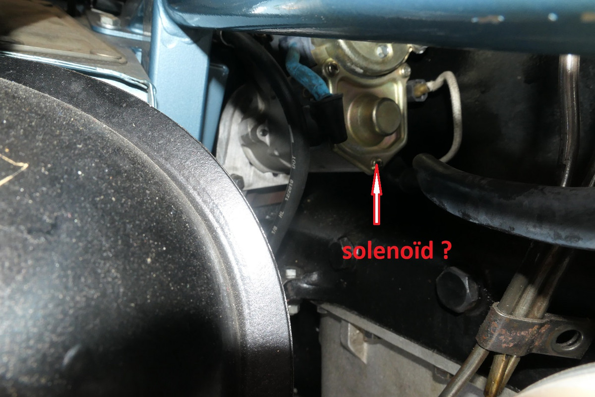

Spacer ring??? , separate solenoïd I think so .... :scratchheadyellow: my starter seems to have two components gathered
How can i check the solenoïd?

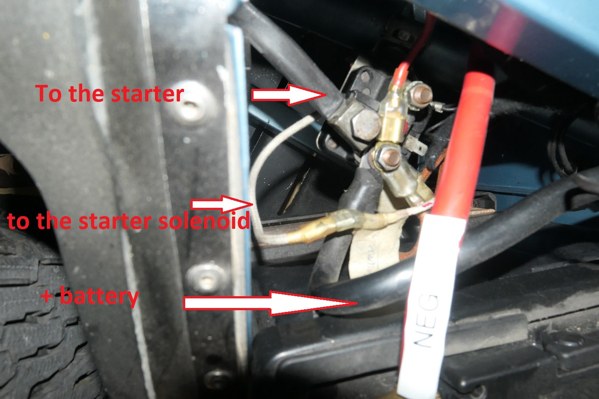

The unit by the battery is a starter solonoid and your starter motor also has a starter solonoid by the looks of it....you need to start testing the electrics....your start button operates and you here a click.....so whats clicking....is it the solonoid by the battery......does this then extent the power through to your starter motor?.....Steve

Yves.....disconnect the battery.........switch on ignition.....press in start button and hold in place with a stick or similar......go to the battery. ...just touch on the disconnected connector.......you should hear the clicking....Steve

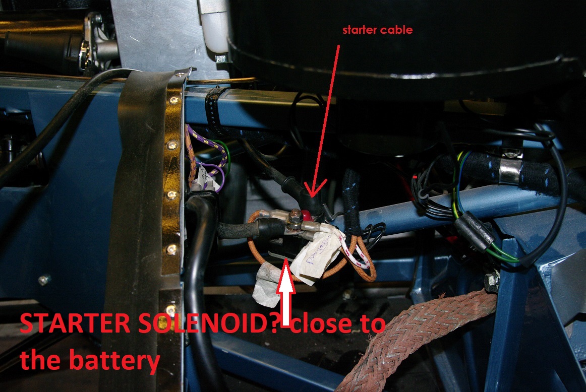

Post by Polse7317 » Wed Oct 20, 2021 7:45 pm
:fingerscrossed: 'll try that tomorow. May be i can squeeze the connector near the battery if what i thought is a solenoid
old photo below but showing the " connector solenoid?"

The wiring to the starter is direct from the battery the big wire is connected on the same "bolt" on the old solenoid . So i think that it's my starter which is not operating sometimes . I don't think i can replace the solenoid "binded" close to the starter . i'll resove to replace it .
