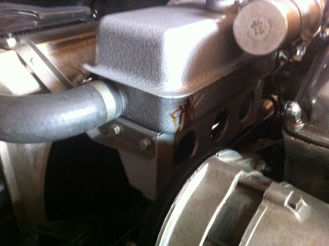

Today I decided to check my coolant level and to my astonishment I discovered signs of leaks on top of the tank. Let the engine reach working temp and the tank was like a spring splattering out coolant as the pressure increased. I am not sure what crap tank was put on there and hope the new one ordered from SNGB will fare better. In the mean time I temporarily sealed up both pin holes with the trusty JB Weld and all seems well.

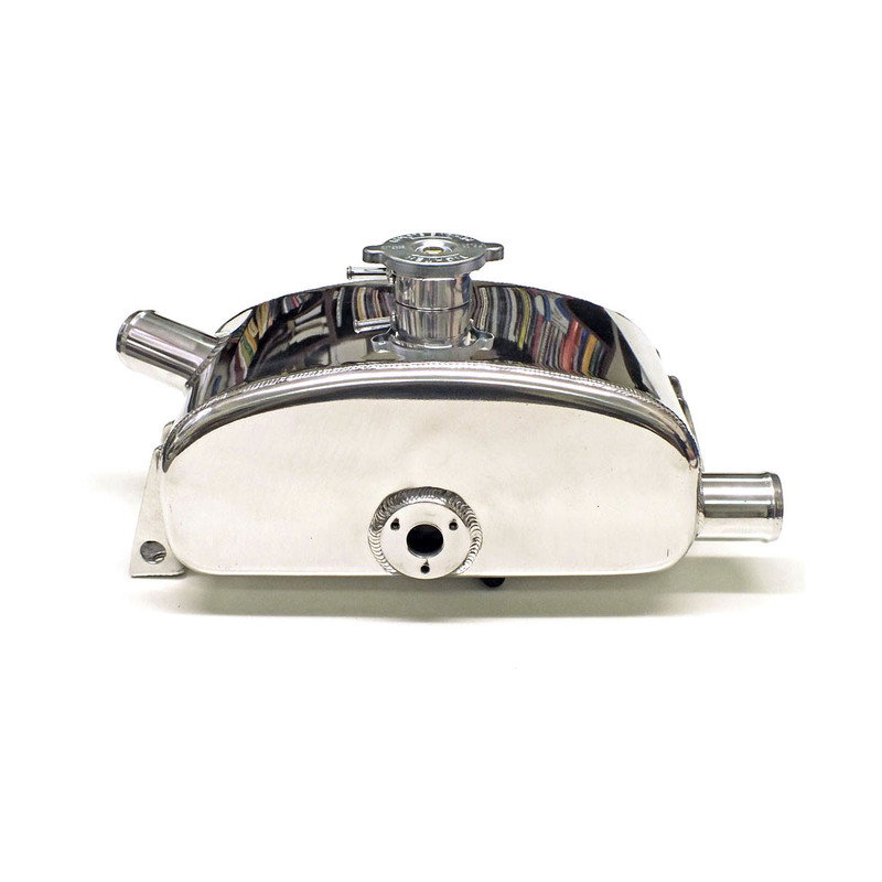

You should get one of these:
https://cambridgemotorsport.com/61-jaguar
Not only look superb by matching the curvature of the bonnet and cam covers but will last forever! Why Jaguar spoiled the engine bay with the hideous oblong header tank I will never understand. Return the stock one to SNGB and buy the CMS one.

That tank which Heuer knows I purchased AND
Without the Bung hole because I use an adjustable Hayden fan switch
Is a work of art!
ALL of the original style ones All of them are terrible

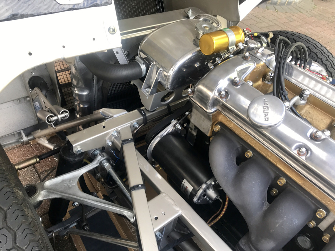

Post by MdR » Mon Sep 26, 2022 9:04 am
This happened to me:
Is an 1.5 year old steel expansion tank from sngb.
I was hoping someone has some experiens with the brass expension tank.
Might be a better option.
I never considered a aluminium tank, but now I'm having doubts.
Marcel

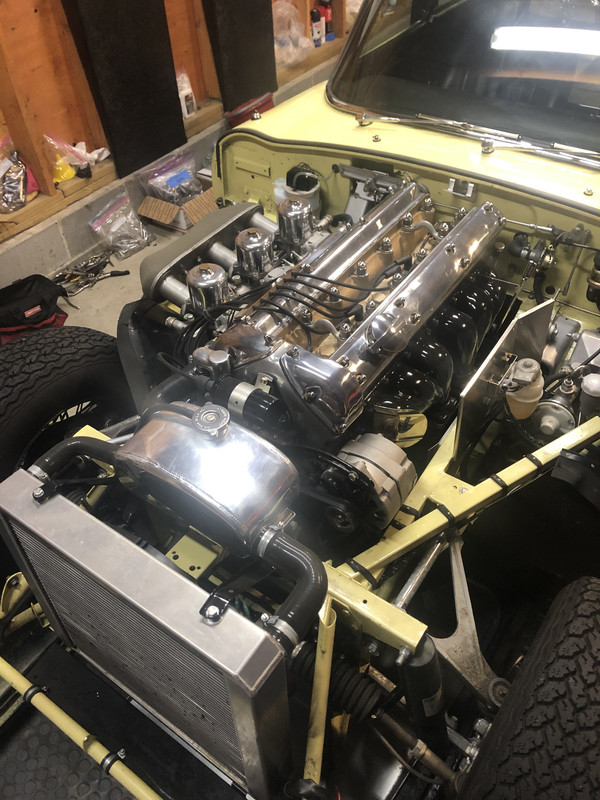

Ok, after much consideration and as per David's and Angus's recommendation I went ahead and ordered the curved polished aluminum header tank, last one they had in stock, from Cambridge Motorsport, should be with me in a day or two. Thanks for the recommendation.

Post by DWW » Tue Sep 27, 2022 9:14 pm
The jewellery piece arrived today, looks magnificent can't wait to install it :bigrin:

Post by gtjoey » Wed Sep 28, 2022 1:48 am
You will love it.....Welcome to the dark side.!
No leaks and quality well beyond the original or repro.
