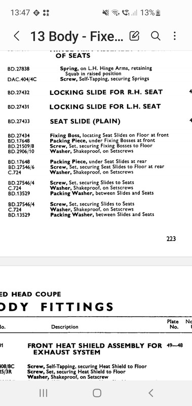

Hi all,
I am looking at the seat runners on my car. It has standard seats, and on removing them I have noticed the seat spacers/boss's are a mismatch of parts.
Does anyone have a diagram of what goes where? As I read it from the SNG list, there is a spacer between the seat base and runner, and spacers under the boss's at the front of the seat, also spacers under the rear of the runners where they fix to the floor. Am I correct?
The parts catalogue and repair manuals dont really show anything and ive done a search and can't really find anything. Help please!

#5 Re: SEAT RUNNERS SPACER DIAGRAM?
Have a look here Steve....more info viewtopic.php?t=16426
The S1 parts catalogue in the Knowledge base section also list them

#6 Re: SEAT RUNNERS SPACER DIAGRAM?
Thanks Steve. I was looking at that but it doesn't correspond in the picture plate? The picture is sparse, doesn't really show you what goes where but the description is good!

#9 Re: SEAT RUNNERS SPACER DIAGRAM?
You can add/remove spacers to raise/lower the seat, also to tilt it for better thigh support . Also, is the fore/aft slide adjustment a bit stiff?
Remove all spacers and fasten just the rears bolts . Compare the gaps under the runners at the front 2 mounts; for smooth runners the spacers you add must be the same difference as these gaps.
