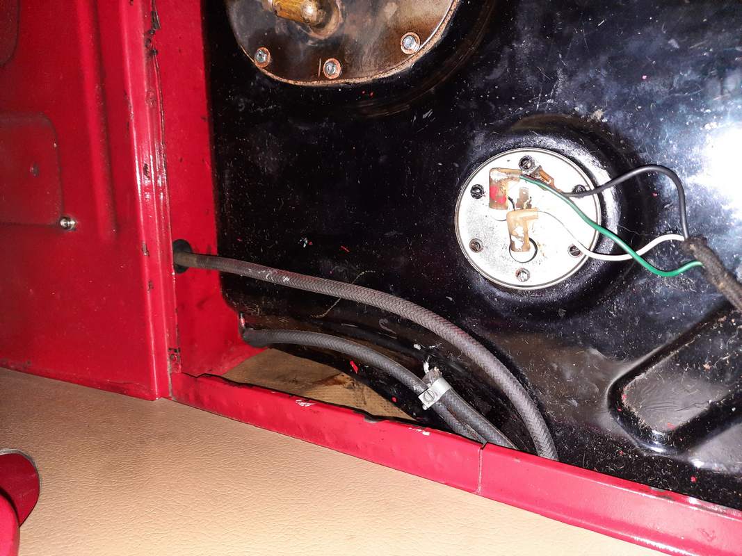

jagwit
Posts: 625
Location: George
#31 Re: S3 Fuel Expansion Tank
Post by jagwit » Tue Apr 06, 2021 4:51 pm
Bob. wrote:
Tue Apr 06, 2021 3:33 pm
If anyone can help, I would still like to bottom out the issue of where the expansion tank vent pipe on a non USA/Canada car exits the bodywork.
This is on my S3 RHD OTS:
Best Regards
Philip
Bob.
Posts: 411
#32 Re: S3 Fuel Expansion Tank
Post by Bob. » Tue Apr 06, 2021 5:29 pm
So whereas on an an emissions car the hose transitions to the steel pipe going to the carbon cannister before going through the grommet at the back of the boot, as shown in post#21, on a non emissions car the hose is simply poked maybe an inch or so through a grommet with a bigger hole and vents into the area above the IRS. It did see the most likely way but it's good to see some evidence as it does not seem to be documented anywhere - thanks Philip.
Bob
'71 S3
http://forum.etypeuk.com/download/file.php?id=1430
... on a non emissions car the hose ... vents into the area above the IRS ...thanks Philip.
Surely this would make the car incredibly smelly? Phil, is this correct, your tank is openly ventilated by this hose?
Or are non emission fuel tanks sealed, i.e. remove the filler cap on a hot day, is there a purge of pressurised air?

jagwit
Posts: 625
Location: George
#37 Re: S3 Fuel Expansion Tank
Post by jagwit » Wed Apr 07, 2021 4:12 pm
lowact wrote:
Wed Apr 07, 2021 10:58 am
The pipe comes from the expansion tank, goes through the body to the IRS cave and terminates there with an open pipe. But this open pipe may not be how it came from factory - this car having been "restored". The idea is for fumes to come OUT of that pipe but moist/dirty air can just as easily go INTO that pipe if the pressure inside the tank drops by cooling down. I recon a very small inline fuel filter should thus terminate that pipe.
