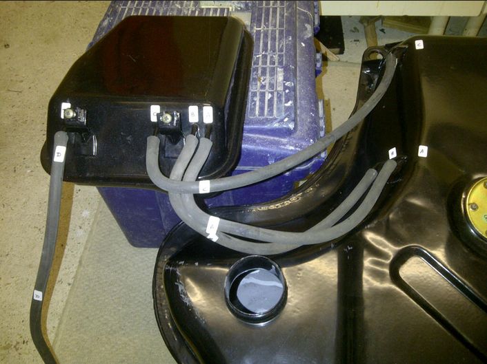

Fantastic pics, thanks Bob!
Now comes the big question:
Which connections on the tank goes to which connections on the expansion tank?
I am aware of three connections on the tank but I see 4 connections on the expansion tank. I presume one of them would go to the carbon cannister or otherwise atmosphere (external to the body)?

Hi Philip,
"D" is the outlet Jaguar designated for the expansion tank vent. The diagram shows the early type of charcoal cannister.
Two restrictors, which should be about 2 inches in from the ends of hoses "A" and "B" at the main tank end, will often have been unknowingly thrown out when hoses have been renewed, as mine had been. If you still have these I would be interested to know what the bore of these restrictors is - I suspect it is 40thou.
Note that the second picture kindly posted by someone else, shows the expansion tank upside down.
Hope this helps.
Bob

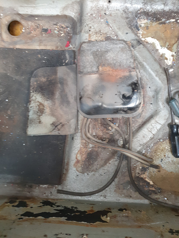

Well it came out with a little help of a large blunt screwdriver. Thanks Bob.

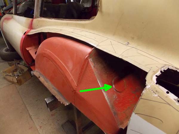

Haven’t found any restrictions in the pipes but have found two round welded plates at the same points on the top of the wheel arches? Anyone have any ideas? :scratchheadyellow:

Glad you got the expansion tank out without damaging it Peter. Where did the vent pipe exit the body?

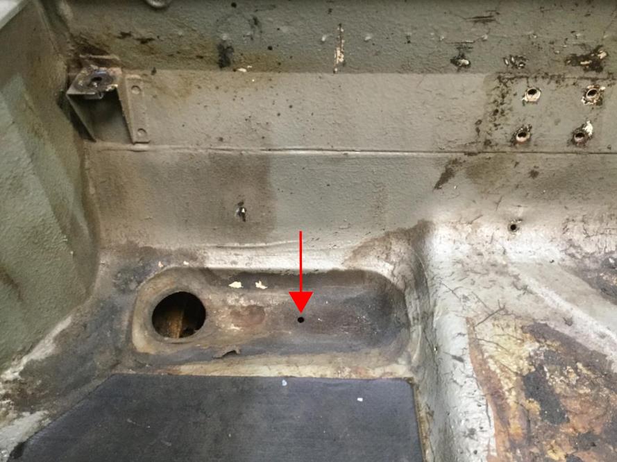

Would you mind posting a picture of the plastic plug fitted to the small drain hole to the right of the sump hole in the boot floor. I can't see it in your picture, I think it's hidden under some flakes of something. Many, like mine, are missing and it's not shown in situ in the Parts Manual. I think it is BD25375, originally with a hole right through although the current aftermarket versions have closed ends.
Re the circular features in the panels shown in your pictures, are you sure they are welded in rather than just pressed in as stiffening/antiresonance features?
Are they as shown here or something else?

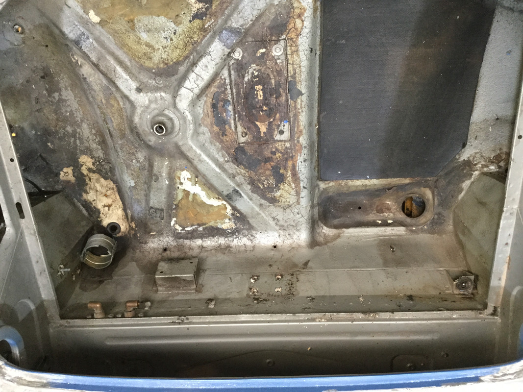

I see nothing as described, two Phots taken let me know.
I was deservedly ashamed of dirty boot, but in my defence I’m still stripping!! :oops: :P

Thanks Peter, your plastic plug has also gone missing like mine.

Mine was still there, just ...

Thanks Colin - that's what I thought it was, an open ended tube with two wings. I have plenty of pictures of the tube part poking out of the bottom of cars, albeit of differing lengths, but only one fuzzy image of the winged top part inside. It looks the same as that originally used in the doors to accept the metal clips of the door cards.

Bob you’re correct on closer examination it does appear to be a pressing mark.Ta! I note you’re about to transplant a rear wing I’ve got to do the same after discovering a poor wheel arch repair...what method are you going to use to add? Butt or joggled joint to the old stuff?

Sorry not my car in the picture, just used it to illustrate the panel feature. Other forum members will be able to help you with bodywork repair techniques.

The thing shown in the closeup is approx 20mm long and at least 15mm dia on the body. The hole in the sump floor is 5mm how do the two marry? Why is it the shape it is?
