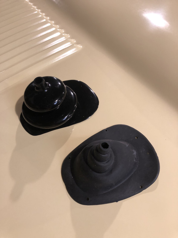

The bubble gator is silicone as Heuer said before and larger that does not pull!
I cannot get out of the car!!!!

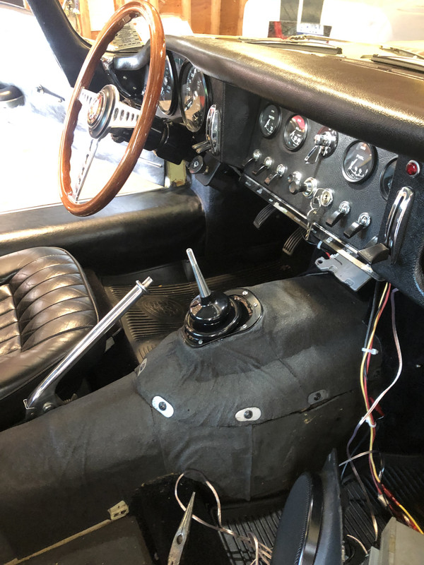

I ordered a yard of factory style rug and binding
From Bartlett/Osji
So I can start my custom tunnel area.

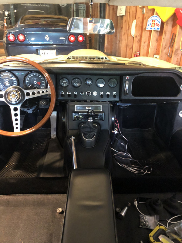

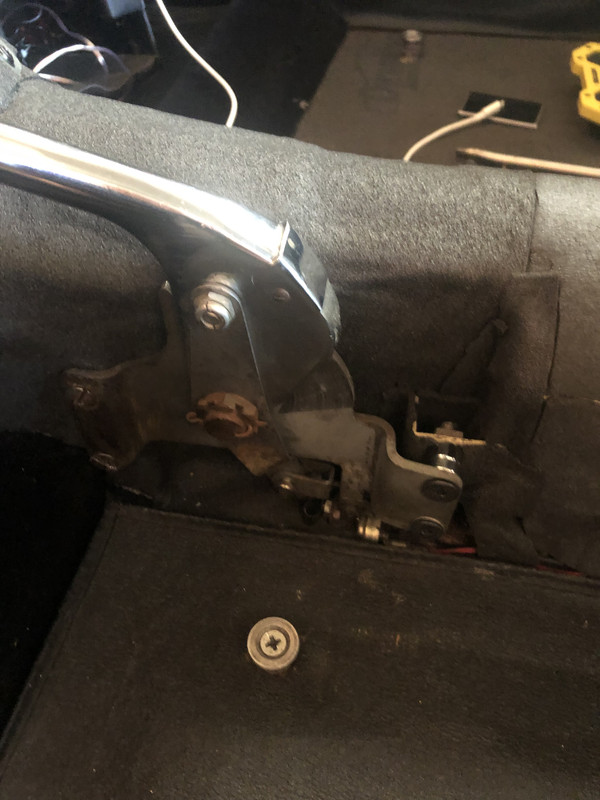

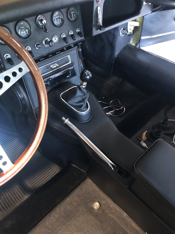

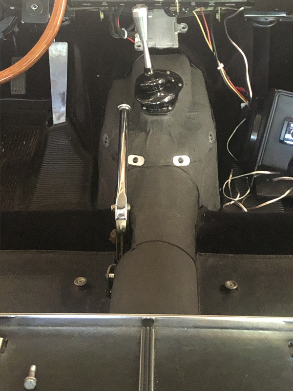

To wrap the 5 speed up
Shimmed the e brake out so it hugs the tunnel not your leg!
Rug on the way
Spacing the e brake handle it doesn’t get hot
Take a look
It makes a huge difference with the leg room!

#468 Re: The 5 Speed is here……..
Post by bitsobrits » Sat Oct 15, 2022 8:02 pm
And the console still fits?
gtjoey
Posts: 604
#469 Re: The 5 Speed is here……..
Post by gtjoey » Sat Oct 15, 2022 10:19 pm
It could BEFORE this tweek but I want to go in this direction I never liked the original layout unles it was an original show car
Once done I think you wil like it
Now the center stack looks old
The dash is perfect

#470 Re: The 5 Speed is here……..

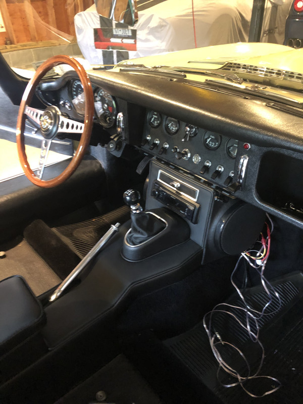

Post by gtjoey » Sun Oct 16, 2022 6:43 pm
Okay
I relent…..
So many DEATH threats from life long E Type buddies to suppliers…..
Everything just about fits!
I need to massage an eighth of an inch here and there
But yes it fits….
I was going in another direction THEN
Last nite NORMAN came down and said
“ Joey I supposedly did 150 in that car”
You can do it!!!!
So it will look stock except for the 5 on the shift ball❤️🙏
Gtjoey1314
I will explain what I did once it’s complete!
Give me a bit

I have to make the center stack clear comfortable to open the center console!
That’s all that’s left
It’s wonderful
I will format the whole thing once it’s buttoned down

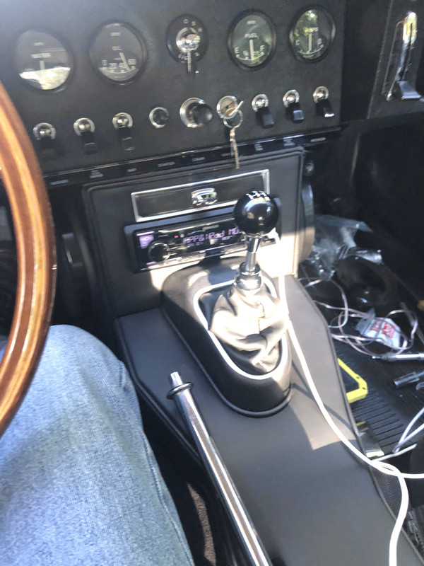

Easiest solution to the centre console is to use a couple of thumbscrews to hold the switch legend rather than screws. Means you can remove the legend and drop the centre console in seconds. Available here: https://shear-loc.com/products/thumbscrews/
gtjoey
Posts: 604
#476 Re: The 5 Speed is here……..
Post by gtjoey » Mon Oct 17, 2022 11:27 am
Lost you on the Thumb screws?
I have the two up top
I use Philips screws on the sides
I have to massage the double lip on top of the radio console
Will have pics tonite
If all goes to plan
I’m
Done and will have the whole
Do’s. And. Dont’s
Of this job, well with close to 500 miles in two weeks break in
She is quiet as a mouse in all gears and 5 th is a dream👍🏾
Gtjoey1314
#477 Re: The 5 Speed is here……..
Post by christopher storey » Mon Oct 17, 2022 2:05 pm
You don't have to massage anything. As Heuer has suggested , the easiest way of solving the problem of clearance between let down flap and radio etc housing is to replace the vertical screws which secure the plastic legend strip to the let down flap from underneath with thumbscrews . It is then a matter of about 20 seconds work to unscrew the thumbscrews, remove the legend strip and its backing, thus leaving sufficient clearance for the letdown flap to be lowered without disturbing the radio console ( and it's about 40 seconds to reverse the process )

Post by gtjoey » Mon Oct 17, 2022 2:13 pm
Now I understand , My problem is once you releather everything the quality is so much better it takes up room.
Tonite i will have it done, no one will know......
Thanks for the tip.
I understand now.
