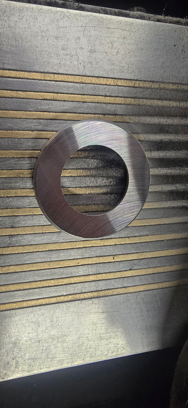

To save time will get it surface ground back to flat tomorrow, it only needs about 6 thou off it, and the thickness makes no difference to the shimming, of which I’ve got a full set anyway.
However - see below, I don't think it had anything to do with how tight the nut was.

The key design aspect of this rear-hub set-up is that the inner race has to be an interference fit on the stub-axle, which is why it is meant to need a press - the effort is to shift the inner race off the axle.
The shim or spacer used ends up hard against the flat face of the collar that is also the oil-seal track,and that collar is trapped by the compression of the nut that clamps the drive-shaft inside the stub-axle.
That same face is also meant to be hard against the back of the bearing, see below.
And no, the collar's face is NOT meant to look like that.
My hub comes apart almost without a press, because the bearing has fretted - through insufficient interference - on the axle.
Therefore the inner race can potentially turn on the axle, like this :
- and in so doing it rubs against the flat-faced collar, which it is not meant to do.
Hence a collar that ends up looking like this - albeit easy to change, or in my case probably surface grind as SNGB haven't got one and I need the car ..........

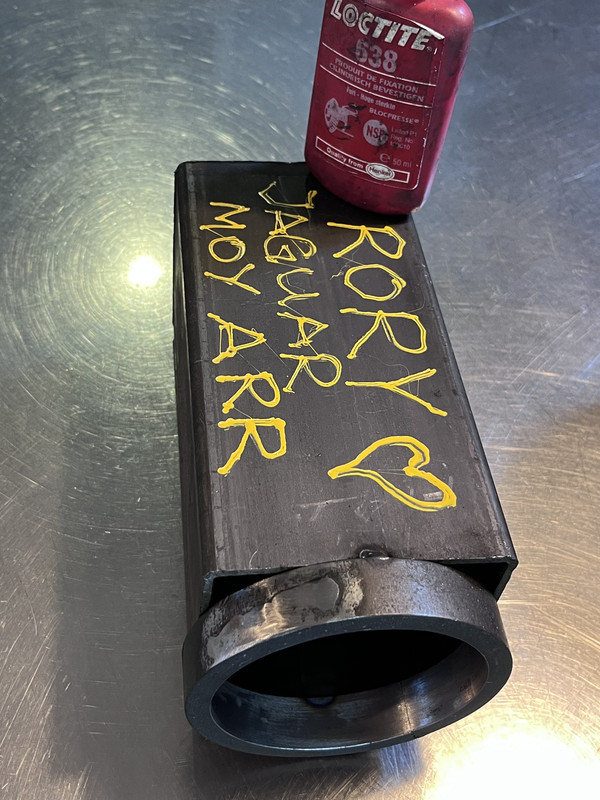

Consultation with Alan Slawson (Mr Diff) suggests this is a common issue, easily addressed by an appropriate Loctite, and the local machine-shop recommended 638.
So I stole their actual bottle for the weekend, as theirs will be a lot fresher than my own 30-year old one.
As I had already stolen an appropriate length of square tube from them, to then butcher by welding a steel ring to it, so I had a proper support for the hub to use on the press ............. their Loctite went in the cart at the same time.
The jig will go back "tattooed" for future extraction, MOY ARR equals HUB REAR in Forinn' - geddit ?
The interference fit required is probably of the order of 0.01mm to 0.02mm, and mine was around zero, so this should be a piece of cake for a product that claims to be good for up to 0.25mm, and is "Ideal for fixing shafts, bearings, gears, and pulleys."
The trickiest bit is trying to keep grease away from the interface during final assembly.
I don't consider this anything other than a proper job, and would rather make an original hub soldier on instead of introducing pattern parts into the car.
The collar at the root of the problem, and that sits at the root of the half-shaft, cleaned up on a surface grinder at 0.25mm, whilst remaining "hard" according to the machine shop, so I have now gained an extra 0.25mm of negative camber for max-attack in the Pyrenees.
It's obvious, when you pause to think about it, which I am not particularly good at, so I will state the obvious.
